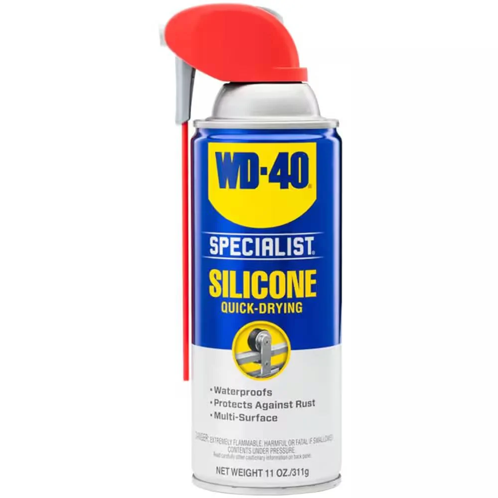

Seriously?
Open door. Move back and forth. Big arm disappears into a hole. Spray silicone spray, not regular WD-40, into that cavity. Move door back and forth.
Now, spray plunger on latch.
Done.
