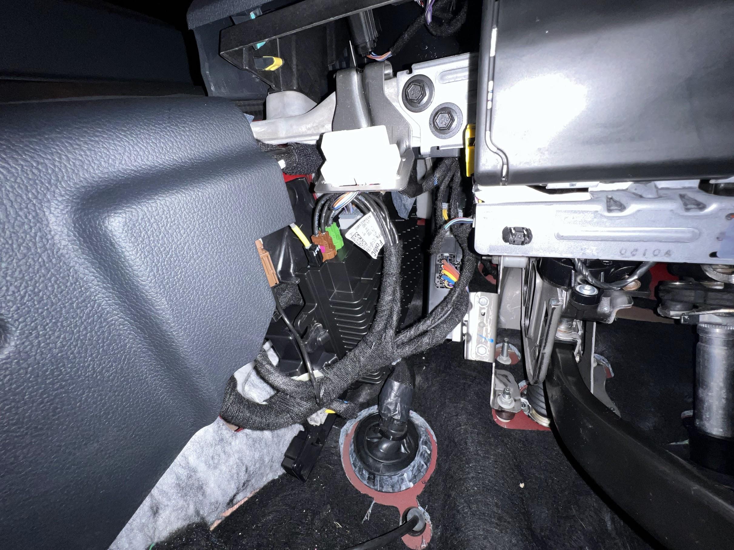

Ford F-150 Lightning Does your Lightning make this noise? IMG_8101
May have narrowed it down to the ECU (ML3T-14H057-FACRev:01) or something around there on the left side of the driver footwell. It makes a 2500 Hz tone. Found other high tones, but not 2500 Hz when sticking my phone through the 12V door into the engine bay.
