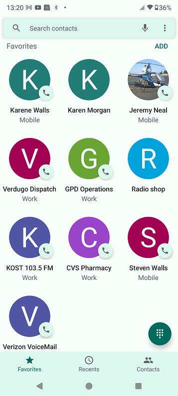

Do you have a screenshot of the favorites from your phone and a picture of the favorites tab from your truck?

Yes, I have 10 favorites as shown below. Only the Verizon VoiceMail shows up on the truck (not handy to grab a screen from that at the moment). I even tried adding one a couple days ago to see if only pre-existing favorites failed to sync with the truck and maybe a new favorite would. That did not have any effect.
Ford F-150 Lightning Edit phone favorites on Sync Screenshot_20250516-132054
