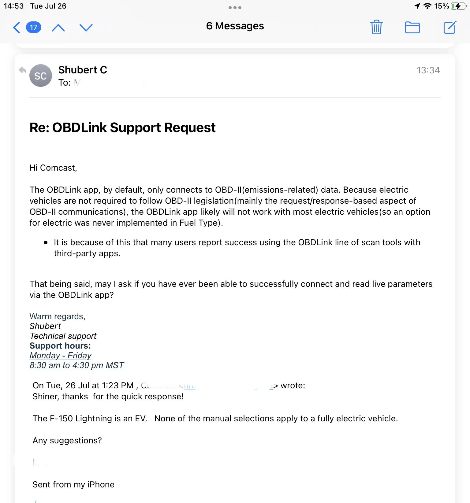

Installed my CX today in my Lightning…it connects. The OBDLiknk app is not much use as the provided standard vehicle configurations are all ICEs or hybrids. They do allow there Dashboards to be customized, but you have to know which PID codes you want to monitor. Any one have a list of the Lightning PID focused on battery (SoC, discharge/charge rate, etc) their willing to share??
This was my last email with OBDLink support:
Ford F-150 Lightning EDITED: Planning to purchase OBDLink CX so I can use A Better Route Planner (ABRP) via CarPlay and get vehicle data FB3D50AD-A62D-4F49-AFF0-A01F2E933179

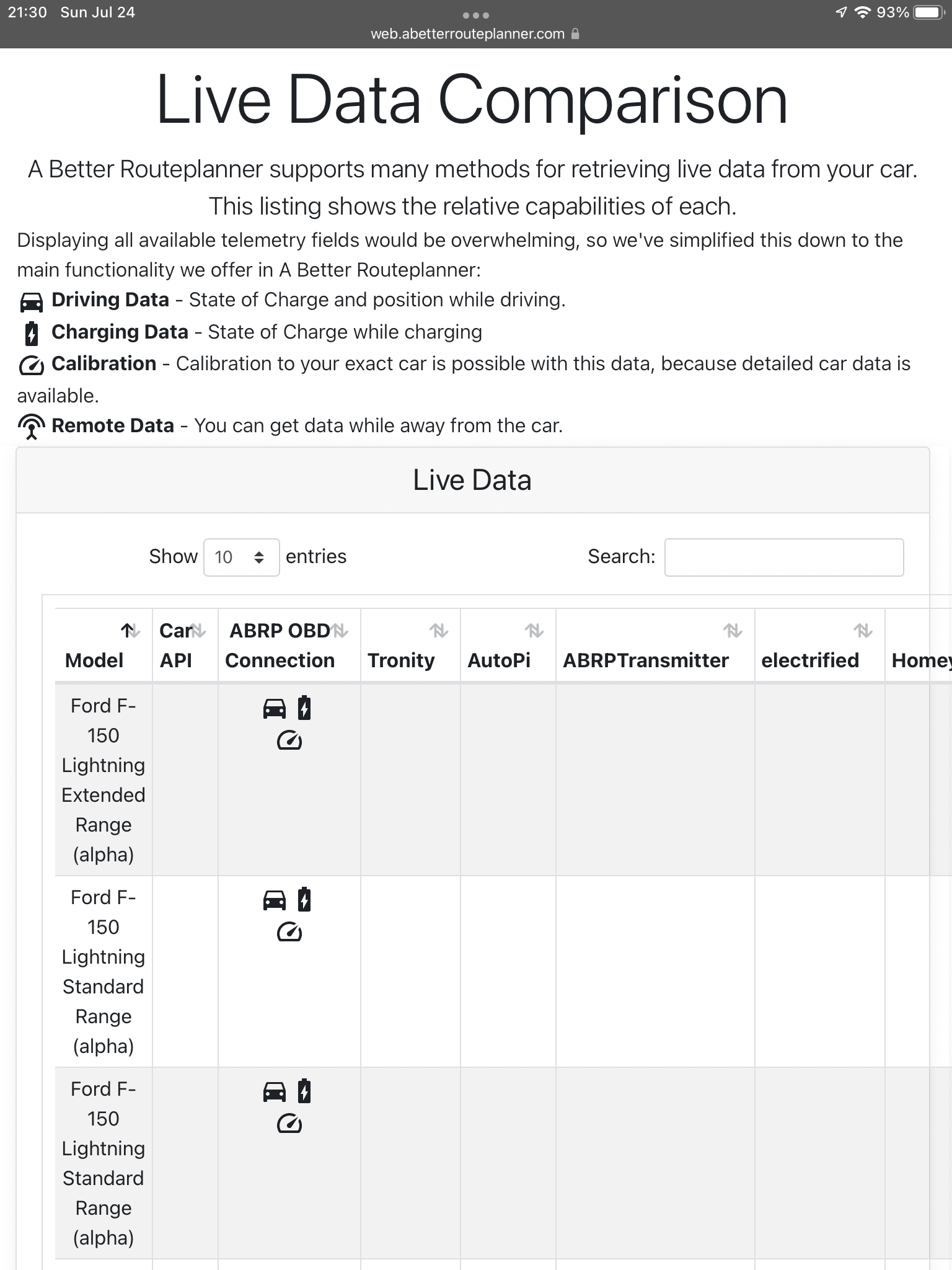

I've also been playing around with ABRP, and from what I'm reading online, it seems like ABRP needs to add OBDLink into the vehicle profile. I couldn't get it to come up with the option to use OBD information in the alpha profile they're using in the latest Android version (4.2.9?)

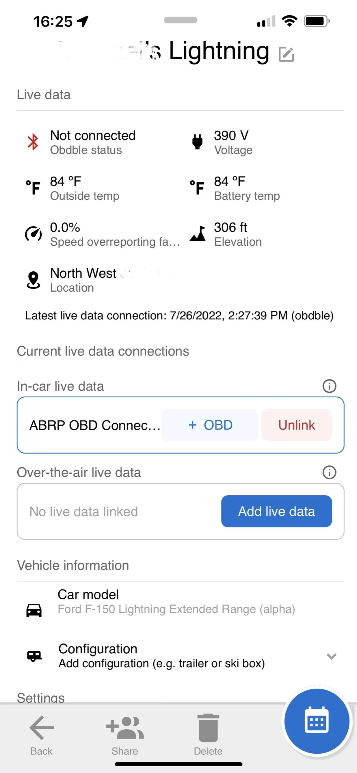

I was able to get the CX to connect to ABRP today on iOS free version… I plan testing it on a half-day drive on Friday.
I’ve seen some discussions about concerns with leaving the CX installed on an ongoing basis. The CX’s Power indicator illuminates solid with the vehicle ignition in the ON and ACCESSORY modes. After I turned the ignition OFF and left it sitting ~1 hour, I noted the CX’s Power light intermittently flickers, and the OBD and Bluetooth indicator are not illuminated….I’m wondering if it’s gone into a power saving mode????
Screenshot taken with ignition OFF…..
