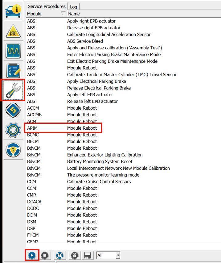

How to reboot a module
Click wrench icon, then choose the reboot option for the module (APIM shown below). Hit the Play button at the bottom and follow instructions for turning vehicle off and waiting 10 seconds.
