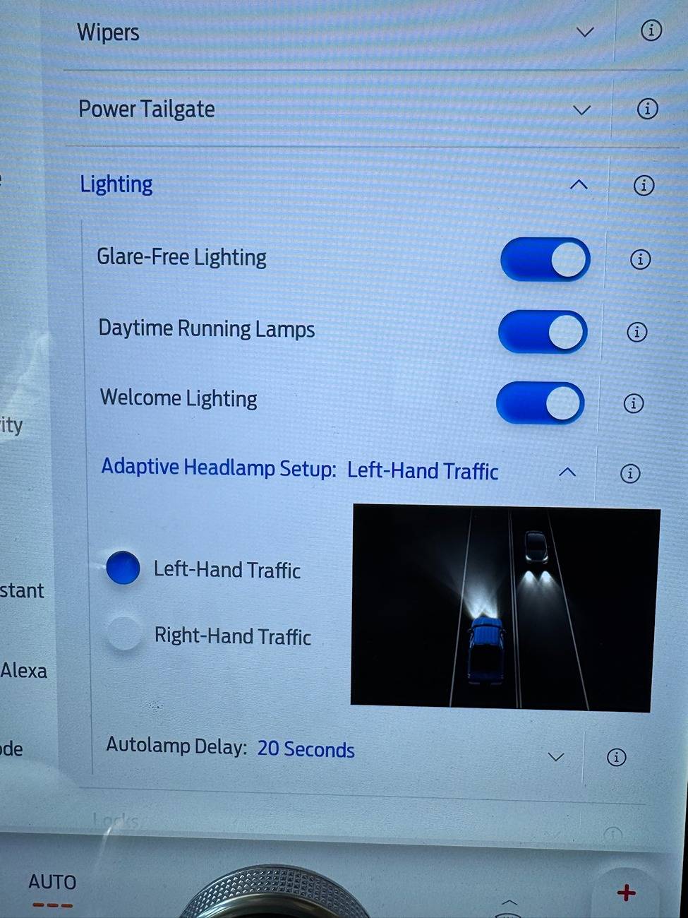

Help, I made the changes for the glare free headlights but when I go to the vehicle setting page for lights, I see the road driving side is set to left. I cannot change the driving side from left to right? I hit Right and it resets 5 seconds later to left. Any ideas?

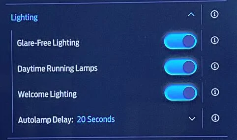

I'm not sure what you're seeing re road driving side. Here is my Lights section
Ford F-150 Lightning F150 Lightning FORScan thread - Version 2 1735920068814-ev
Did you change 7D0-02-01 by mistake? It has a setting for Vehicle Driver location. I suggest revert your APIM settings to the backup you made and try again.

There are a couple of APIM changes that might turn that sub-menu on
7D0-09-01 *xxx xxxx xx-- AEIS Without Override (AEISWO) • AEIS with Override (AEISO) • ACC Menu (ACCM) • Adaptive Head Lamps Control Function (AHLCF)
7D0-09-01 xx*x xxxx xx-- Autolock Control Function (ACF) • Adaptive Head Lamps Traffic (AHLT) • Auto Relock (AR) • Autounlock Control Function (ACF)
I'm guessing you may have fat-fingered one of these by mistake.

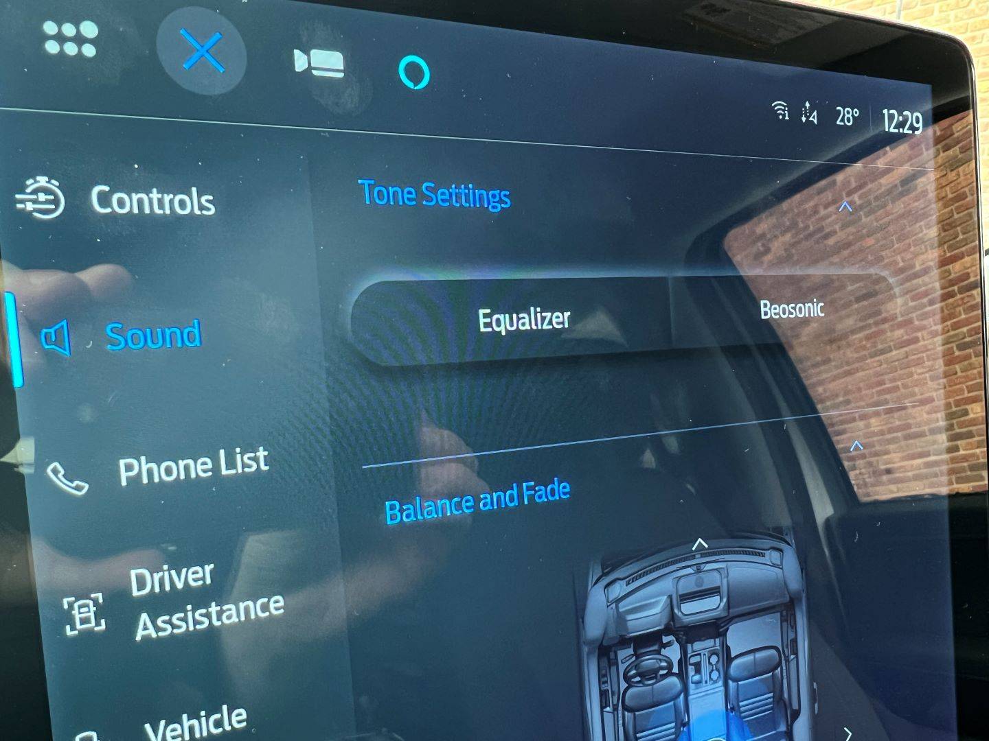

Here's a screenshot of the menu that I am seeing with the below settings:
APIM 7D0-01-01 xxx9 xxxx xx--
DSP 783-01-01 xx1x xx--
Tapping either of them does nothing at all. No beeps or button interactions.
Any thoughts?
Any thoughts?

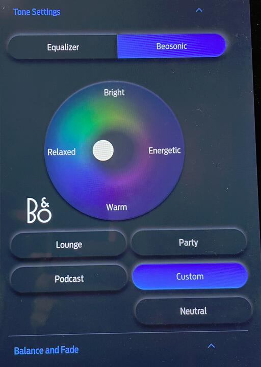

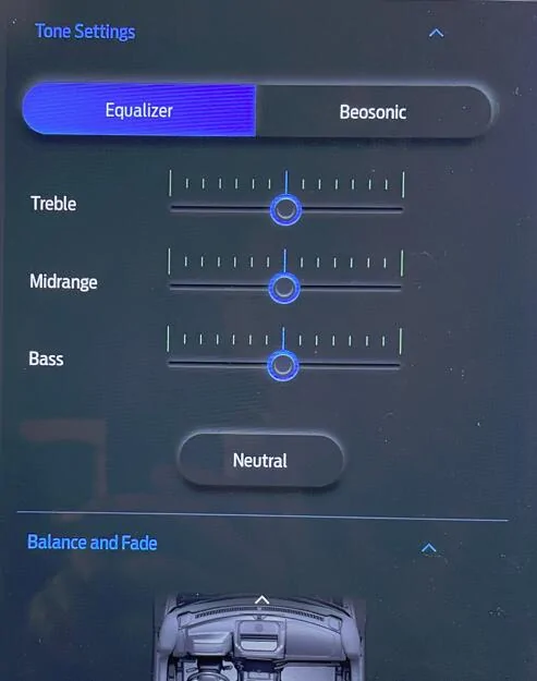

Here is what I see. I am able to switch back and forth between Equalizer and Beosonic with controls for each. Have you tried resetting Sync?
Ford F-150 Lightning F150 Lightning FORScan thread - Version 2 1735931498506-q
Ford F-150 Lightning F150 Lightning FORScan thread - Version 2 1735931526249-dn
