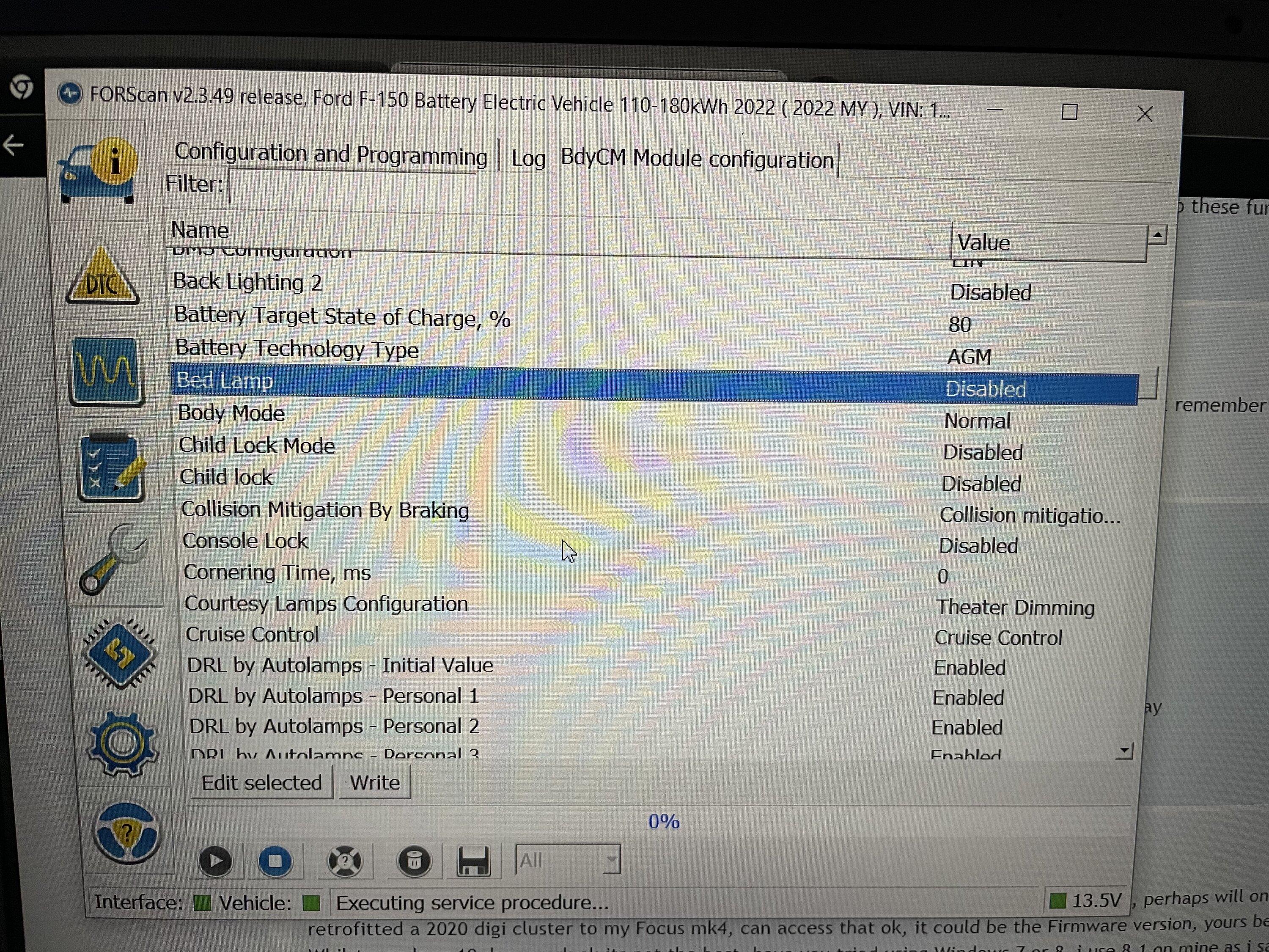

With FORScan, can someone with a platinum trim copy all their data so we can compare it with others to get some of their features? Is that what's called AsBuilt?
You want every module? Or just the As Built ones?
TBH I want to say every module so I dont have to bother anyone for it in the future but otherwise I think the APIM would be the most important one to try to figure out propulsion sounds.
Hope this helps?
Module Build Data (As-Built)

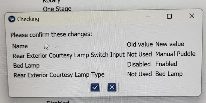

I added in oem bed lights tonight. Needed to modify the below settings in the BdyCM.
Ford F-150 Lightning F150 Lightning FORscan thread C0A62ACB-AEE8-4550-9AFE-A897F56FCE42
Ford F-150 Lightning F150 Lightning FORscan thread 21F750D1-C943-4724-B4A3-0960888CF545
3,222
4,681
I see you have an XLT. Is this mod XLT specific? Just trying to understand what this does and does the Lariat already do it :) .

I believe this should work for pros and XLTs without bed lights. Someone with a pro would need to check for the plugs. Lariats and platinums already have them.
