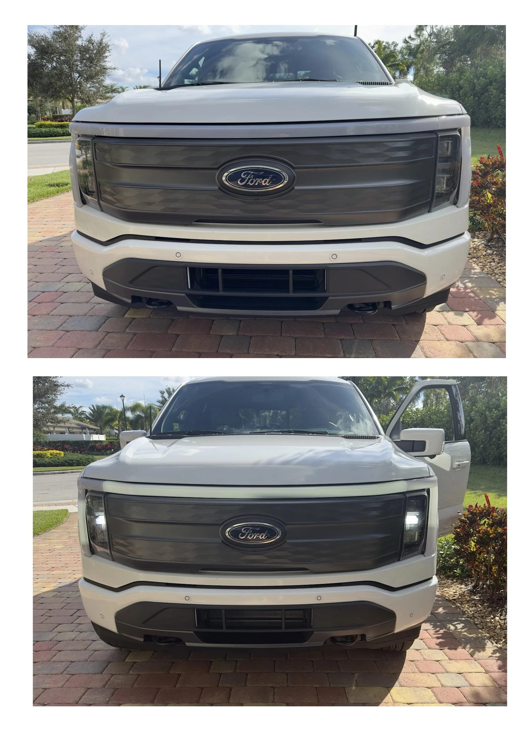

I did the lightbar changes yesterday, pushed brightness to 100%. I do see a difference, but I thought it would be much brighter. It doesn’t look nearly as bright as other vehicles with diffuse LED DRL. Wondering if the settings require more than a power cycle or something like that. I’ll connect back up later and double check changes are showing.

I also noticed very little change in the light bar after making these changes. I like the concept of the special lighting Ford put in here, but I think poorly executed. Not near the eye catching even as most of their other truck during the day.
Yes I agree, exactly my point here too.
To the Forscan wizards who really understand the code changes we’re doing here… how do you *know* that changing those two digits = 100% is it just based on trial and error (some of the posts seem that way) and seeing that that is the brightest that came up? Is it some kind of hex coding where you know for certain xx = 100%? It just doesn’t seem very bright for 100, and I’m fascinated to understand.
Yeah, I reverted mine back cause the change wasn't drastic enough. I was also worried about premature burnout of the LEDs and them not honoring warranty as a result.
