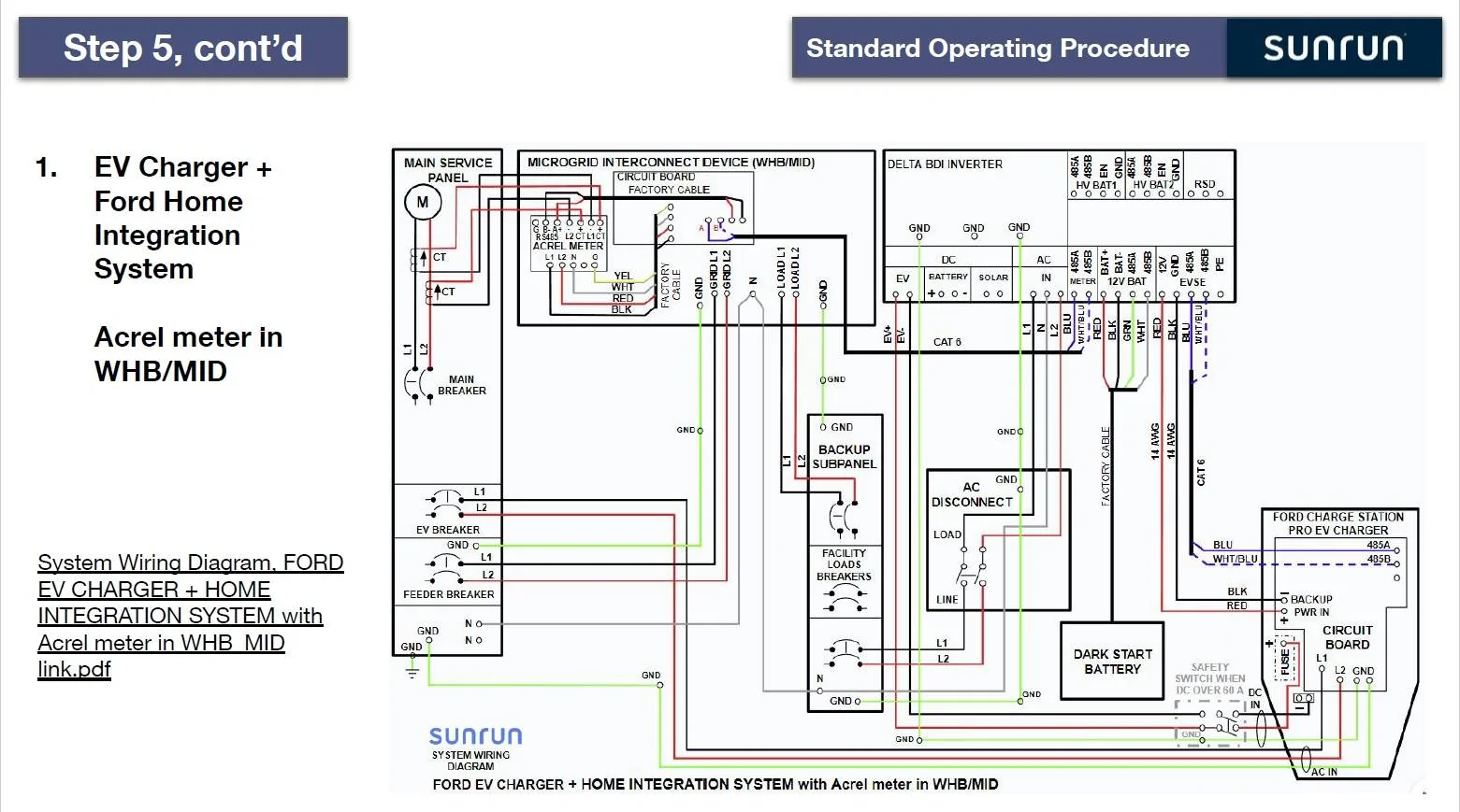

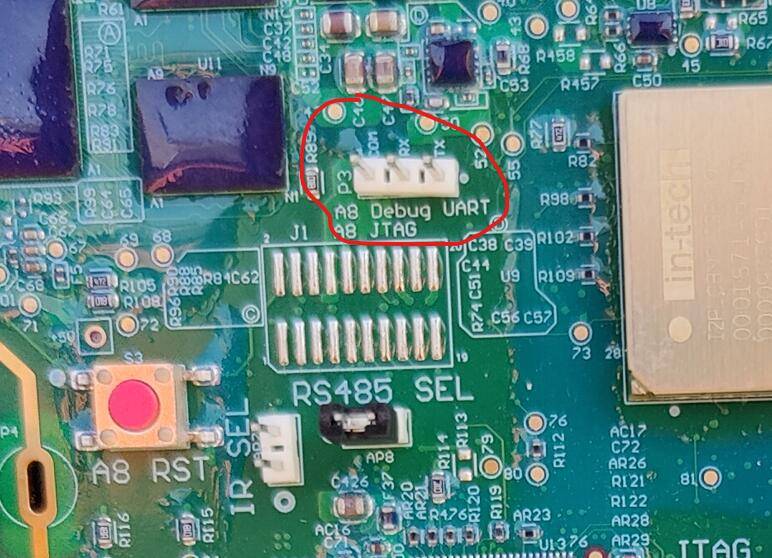

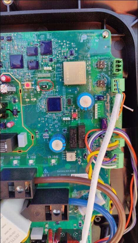

it seems that the FCSP and HIS must be communicating over the rs485. I believe this thread started with debugging/reverse engineering this port to figure a way to tell the truck to turn on the DC backfeed through the charger.
Doing this does one truly functional thing, allows us an alternative to using the abusively costly sunrun (possibly flakey as well) solution. Depending on Ford/Sunrun to provide help is painful if not completely useless. Ford software leaves A LOT to be desired. Doing this also means that we are sourcing our own inverters and the control mechanisms needed.
Finding these solutions and information satisfies our techy need to figure things out and wrest some control from the Ford service people. Depending on your point of view, wresting control from Ford might be a very functional thing to achieve.
The FCSP install spec says that the wires from the DC backfeed ports are to be 8 guage. This size of wire is large enough to reliably support 30A. The 240V outlet in the truck bed is rated at 30A. I had initially hoped that we could extract more current from the DC backfeed through the charger, but upon reading the install spec closer, it would appear that is not the case.
