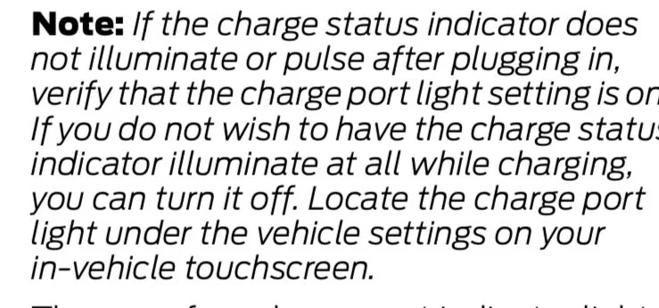

Someone on Facebook reported that their charge port lights were not coming on. I remembered that there was a setting to turn them off that is referenced in the manual but he couldn’t find it on his Pro and I can’t find it on my Lariat. Did this setting get removed in a SW update or are we missing something?
Ford F-150 Lightning Charge Port Lights IMG_0414

I charged outside in a questionable area early on in ownership. I didn't want the pulsing blue light to draw extra attention to the new truck, so I went into the menu and disabled the charge indicator lights. About a month later, I was charging at home and noticed the lights not on and remembered I turned them off. I hopped into the truck to enable the charge lights, but the settings menu with the charge lights on/off toggle switch was gone. Turns out a Powerup removed the feature. The only way the dealership found to enable the charge light was to re-install the software that put it back onto the settings menu. The truck has received a couple Powerups since, and the charge light on/off toggle switch is still in the settings menu. Maybe if you let your dealership know these concerns, they will put it back onto your trucks?

I'm sorry. They didn't share the technical details. Just that they were finally able to get the lights working again. I noticed on my own later that the menu screen was back.

I have mine. Just turned it on a couple of days ago.
2,893
3,214
Might be worth people reporting if they have the menu option and what version they are on. We might be able to track down when it was removed. I'm still pre 6.1, will check when I break for lunch.
2,893
3,214
The setting is missing on my truck. '22 Lariat ER, all updates through radio preset fix, no 6.1 or later updates.
