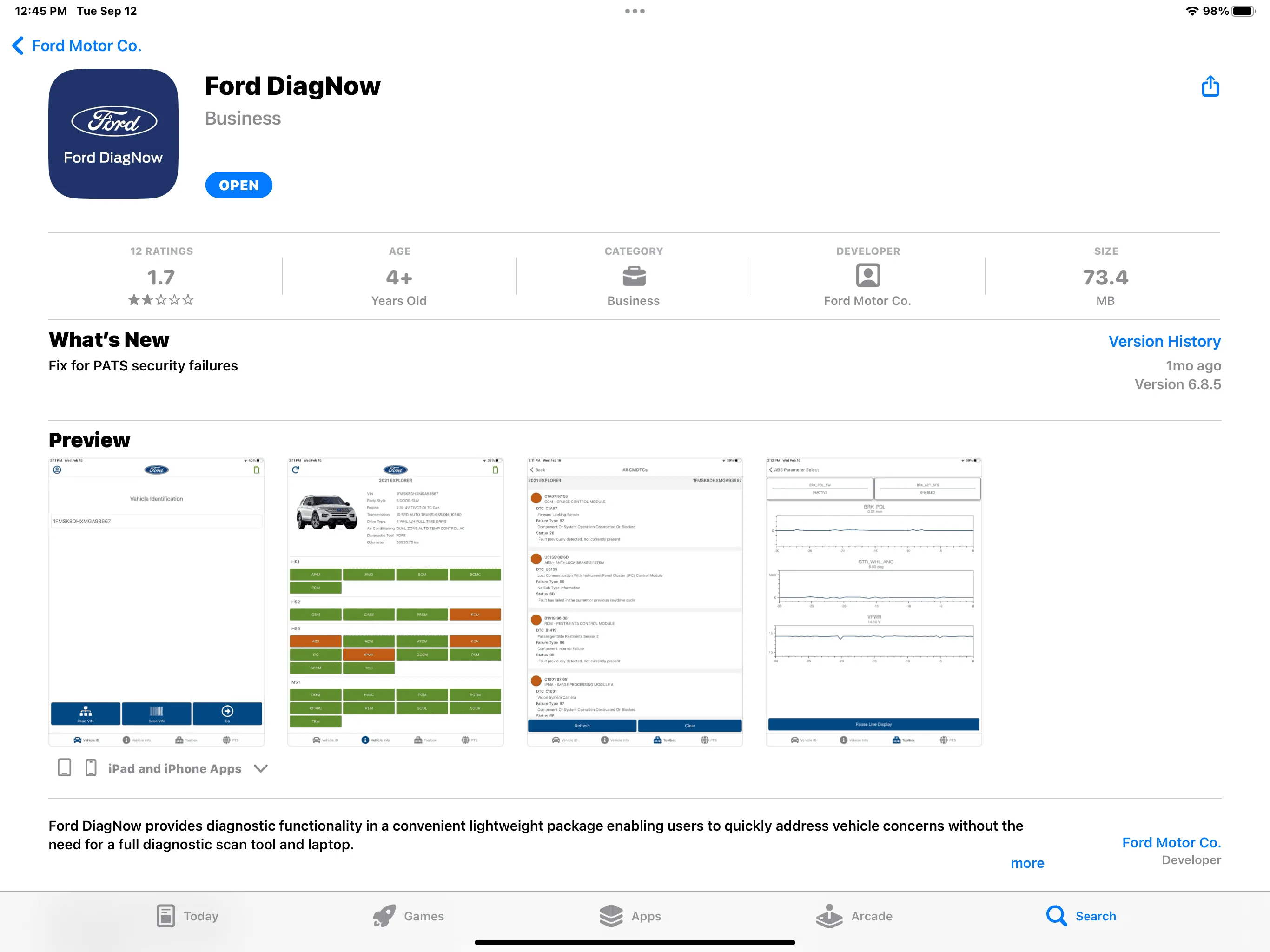

Just wondering if anyone would know if I was to purchase the FDRS subscription and use the Apple Store iOS app would I be able to see pending updates?
I am aware that I would not be able to install or download them unless I have a PC. More just wondering if I was to enter my Vin would that work with this particular app? Not sure if anyone has ever use this or not. https://apps.apple.com/ca/app/ford-diagnow/id1591949444

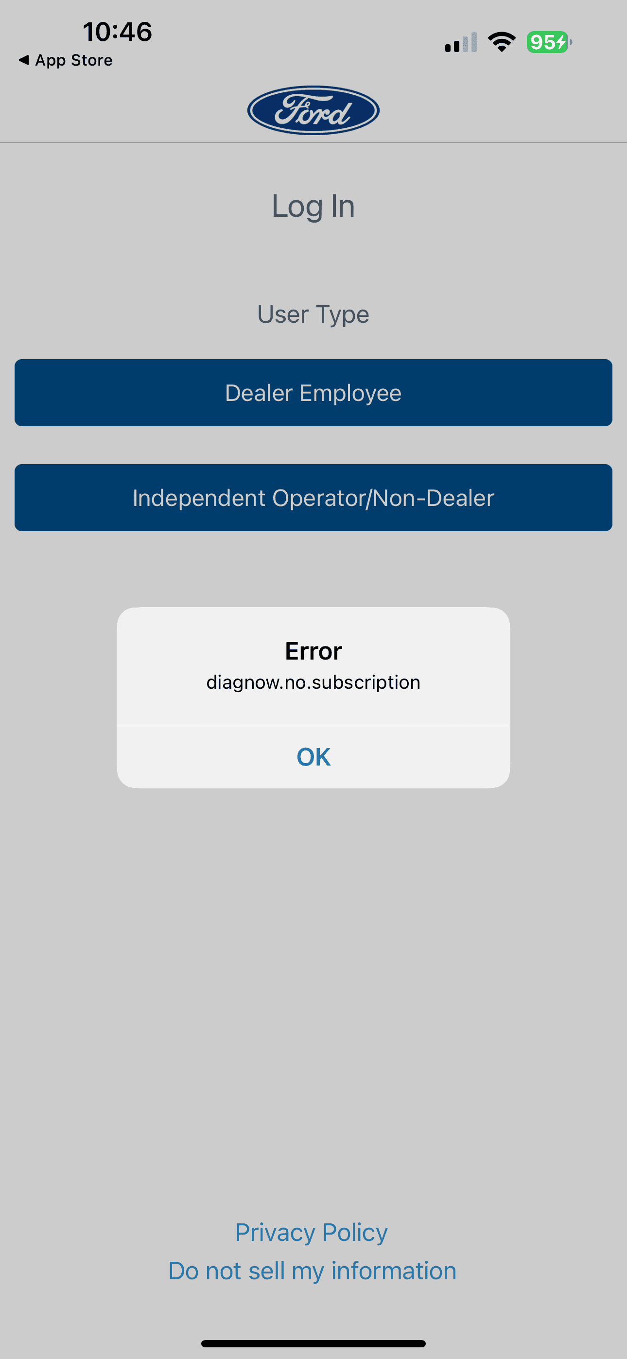

Sadly no, DiagNow is a separate subscription. My FDRS account shows this error.

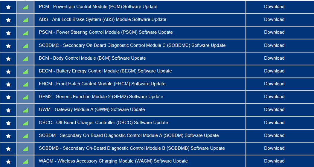

Lots of updates pending for your truck:
Oh wow....maybe I should bring it back to the dealer and ask them to get all of this updated. The APIM has been in for 2 weeks and they obviously are not coming down on their own.
Ford doesn't pay dealers to perform module updates, so I would not get my hopes up that they do it. I don't know these trucks well enough to comment intelligently, but I am a bit concerned that you have such a high Sync version on your truck with so many other updates still pending in FDRS. It could be nothing, but when you can, PM me a pic of your "about sync" screen so I can ask Jesse to look and see if he sees any configuration issues in your truck after the APIM replacement.
Edit: Never mind...... he doesn't need to see your "about sync" screen. Your truck is fine. You'll get your OTA's whenever Ford decides to push them out to your VIN.
