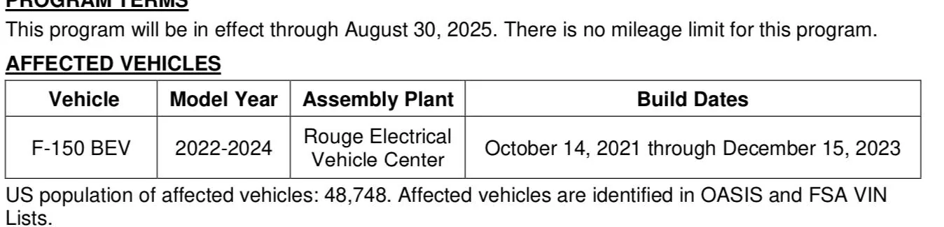

What is your manufacture date (it’s on the sticker inside the driver door)? If it falls in this range then the dealer is supposed to do the update. They can also check your VIN in Oasis to see if it is on the list.
