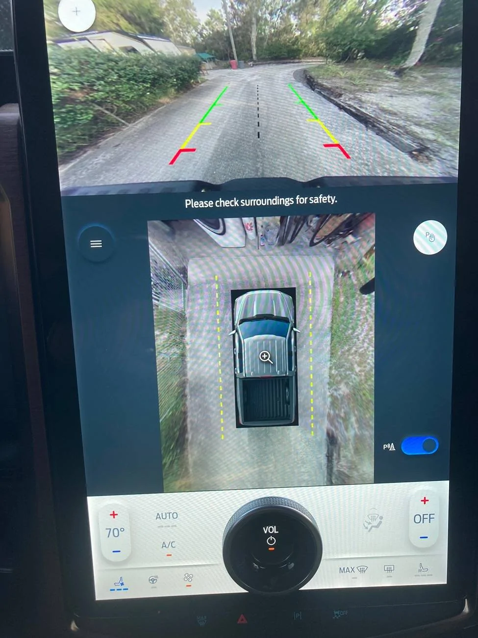

Just had the update done, rear camera view is smaller with additional buttons.
Is this normal for ‘22 Lariat?
Dealer unaware and not able to explain. Anybody have a photo of what it’s supposed to look like?

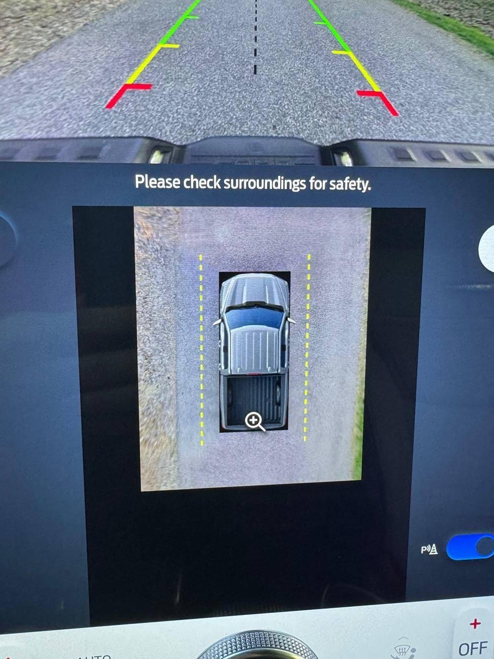

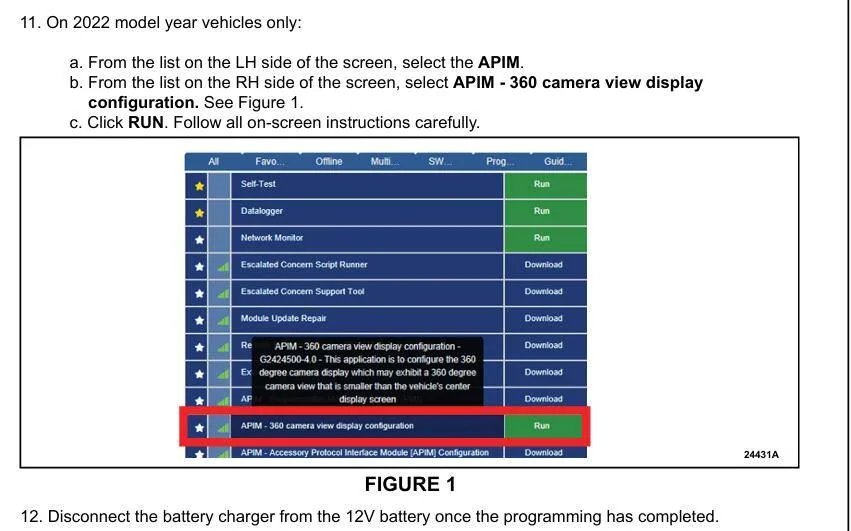

Do you have a black box around the camera image? The camera is smaller with the update but should not have the black box if the tech followed directions. If your image looks like the below, send them the bulletin from the op and tell them to learn to read.

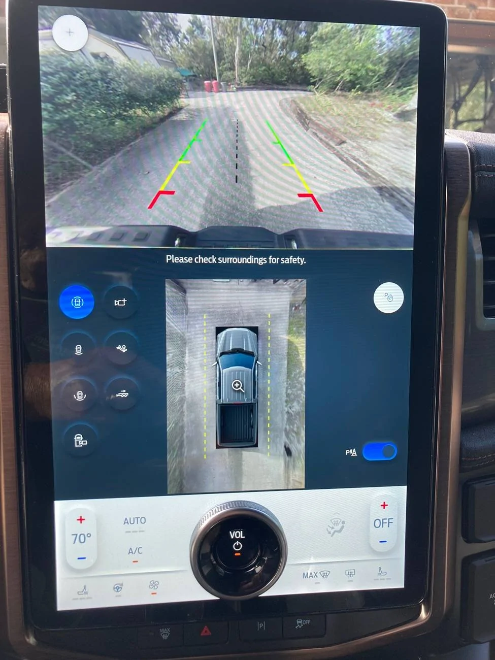

Top is pre update and bottom post software update. The buttons on the left give different camera views, some of which might be useful when towing.
I think I’m okay.

Top view is before you click on the 3 line menu...
