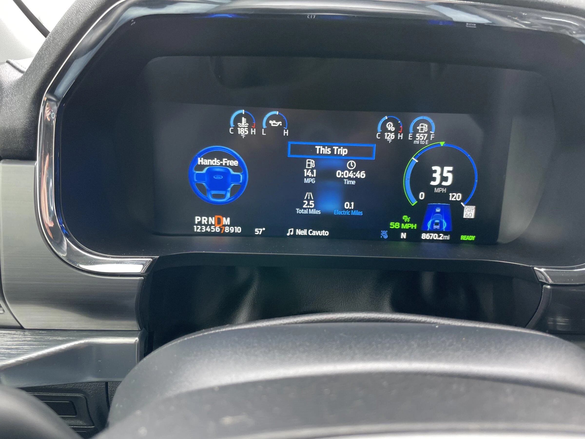

BlueCruise is working great. Just got back from a 70 mile round trip. Job 1 truck built May 2021
Congrats you ?!
That background sure doesn’t look like the pretty blue shown previously.

I got my final update this afternoon also, and it works great. I'm happy with the free year, given they are a little late. I'm also fine that they are late. I'd rather have it late and right.
GolfR
Mar 24, 2021
322
71
2022 F150 KR PB
Congrats you ?!

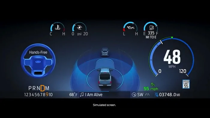

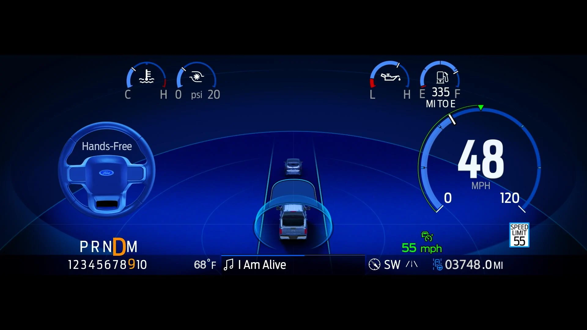

He has it set to show the trip data. The screens attached here are for the driver assistance screen which can also be selected. Personally, I think the driver assistance view is totally worthless. I thought that it would indicate if there were vehicles on either side detected but nope.
I agree 100% ford is lazy with their design.
the hardware is certainly capable of displaying much more detail
