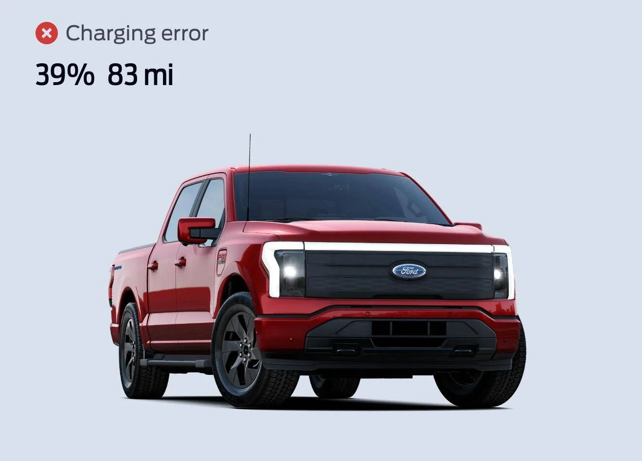

I’m at my sisters house trying to use her Tesla charger with my adaptor.
Button on side of truck went blue but App says charging error.
Do I have to register my truck with her charger or something?
Or can I only use this with a supercharger?

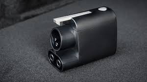

Assuming you are referring to a Level 3 DCFC adapter which then only will work on Level 3 (superchargers).
AC Level 1/2 requires different adapter. There are several on the market. I use a Tesla Tap.

Post a picture of the adapter you are using. It may not be the right type.
3,819
6,973
This adaptor will only work for DC charging. If this is what you are using, it won't work.

Supercharger adapter works at Superchargers...
If you need an adapter for your Tesla home charger, A2Z’s Stellar adapter is very good and priced right - $108 ($99.90 with code FORDFORUM). https://a2zevshop.com/collections/charging-adapters/products/a2z-stellar-plug?ref=Typhoon
