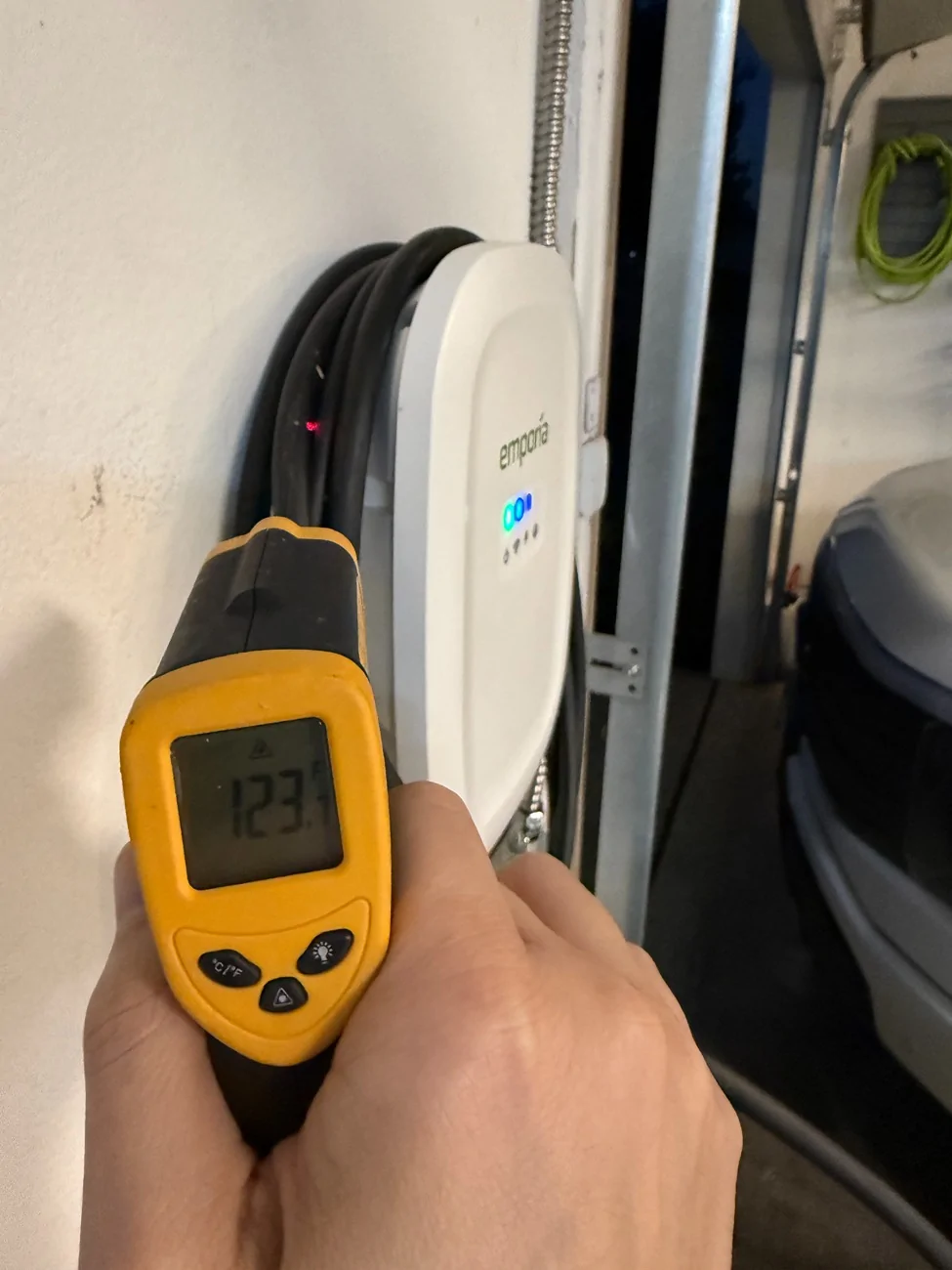

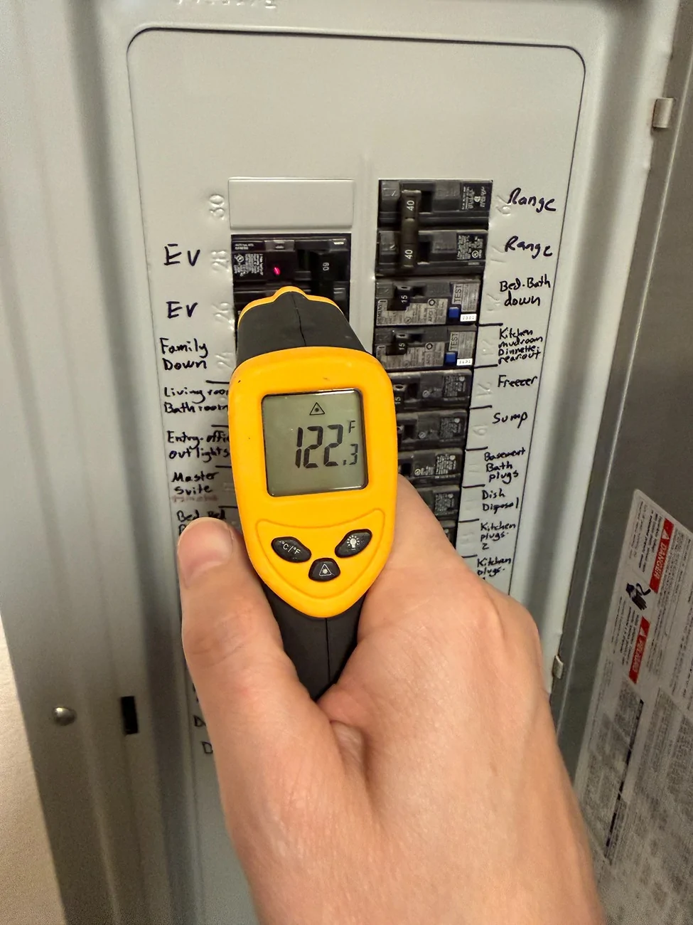

Just got my Ford Promise charger installed (Emporia Classic hardwired for 48A). During install they told me they planned to install 6/2 romex and I told them they can't for full rating on 60A breaker so they agreed to switch to MC cable.
I am doing a charge from 70% to 100% (road trip tomorrow) and checked on it about every 15 minutes. I noticed the cable and breaker were getting warm. At about 1 hour in I took some temperature readings. The breaker was about 122F at the surface of the breaker and the cable was about 123F where it was sitting wrapped around the charger.
Two questions:
  1. Is the 60a breaker getting too hot?
  2. Is the cable getting too hot?
I read the Emporia manual it doesn't specifically say the cable needs to be unwound during charging, but it might make sense (although a huge nuisance) to unwind it.
Garage ambient was probably 73F.
What is everyone else seeing?
