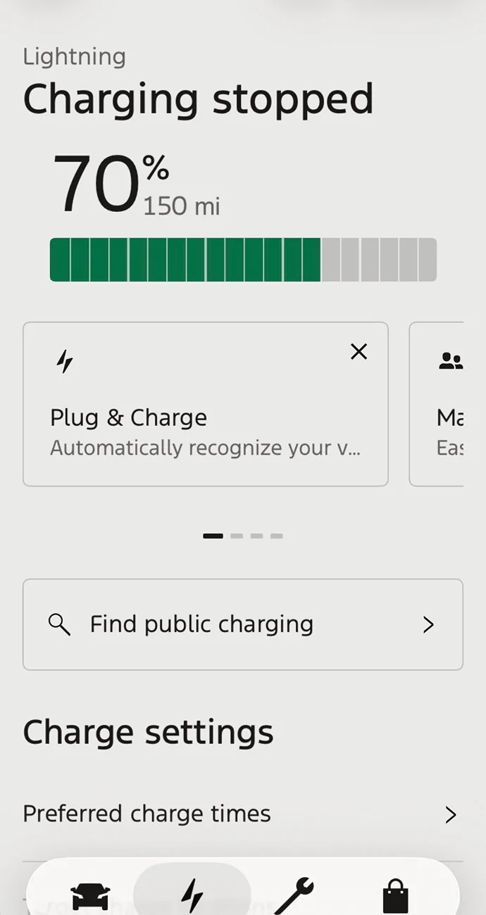

I recently encountered another annoyance with the Ford App. I don’t have a regular commute and I’m on a time of use plan so I have my truck set to charge to 80% between 11 pm and 6 am.
A couple of weeks ago I was going out of town so the night before I used the app to charge to 100%. I didn’t notice at the time but it started immediately instead of waiting until 11.
I decided to try to solve the problem by setting my charger to only charge during my TOU rate.
Well I’ve got another trip tomorrow so when I came in a few minutes ago I plugged in and then tried to set the one time charge in the app. Because my charger is not allowing a charge right now the option to set a one time charge is not available. It’s also not available if the truck is not plugged into a charger. I had to go to the truck and do it from the center screen.
This is a pretty common configuration so it would be great if we could get that fixed. @Ford Motor Company @christooma
