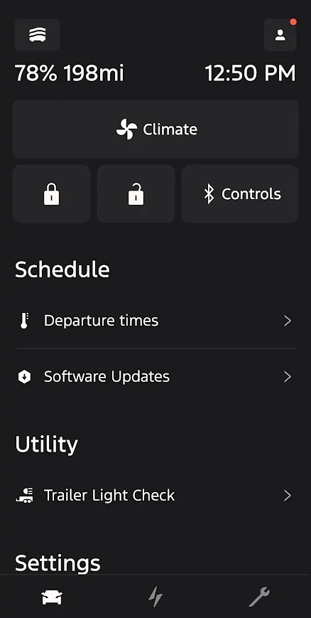

Don't feel bad @TaxmanHog , you're not alone. Replaced my old Android phone with a new Pixel 10 Pro XL a week ago so obviously a new Ford install. 6.3.0 and not PPOB in the app. Just a moment ago, uninstalled the Ford app, rebooted phone, and reinstalled the Ford app. Still 6.3.0 and no PPOB in the app.

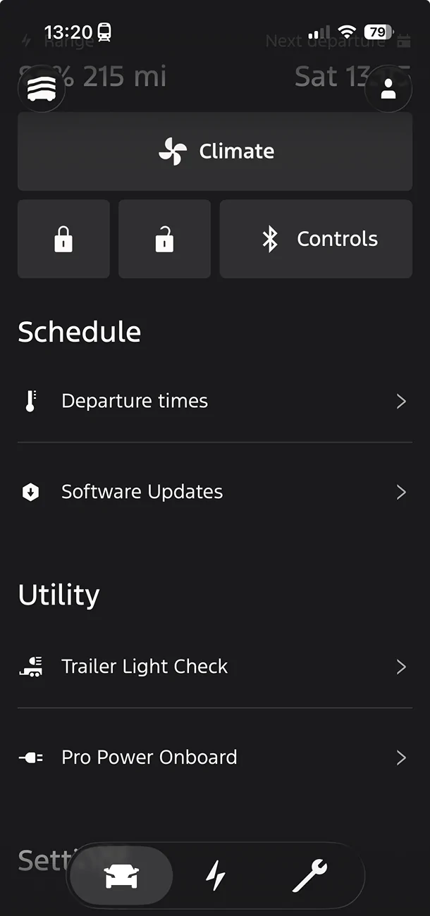

I have a '23 Lariat ER, and I've had PPOB functional in displaying outlet power consumption for about a week (at least) on an iPhone 14 Pro Max running iOS 26.2 (just didn't feel the need to chime in that I got it).

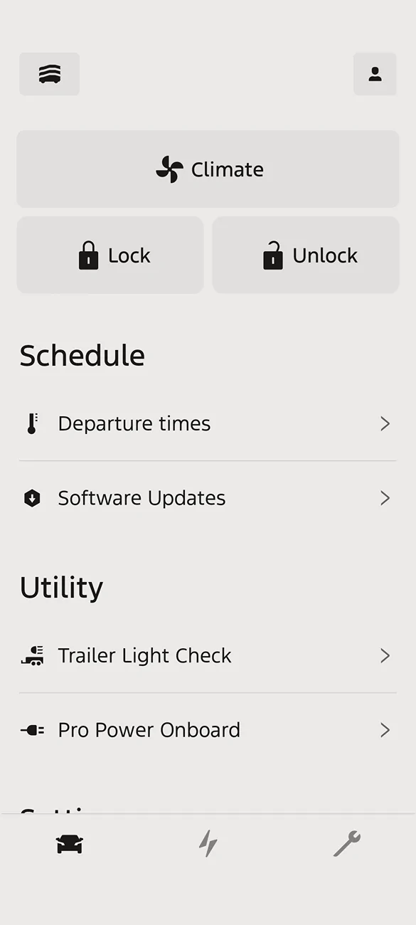

Per a tip from member @I <3 My Lightning in a DM conversation, I tried logging out of my Ford App installation on my phone, then logged in with my wife's credentials, low & behold the PPOB features are showing now, but ONLY with her account profile.
I then logged out of her account and returned to my account credentials, still missing the feature.
This tells me the Ford App on my phone is fine, but my profile on Ford server is corrupted, can we get someone in engineering to look at this ?? @Ford Motor Company
The Mrs. account -----------------my account.

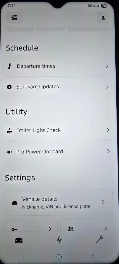

Fwiw 2023 Pro ER, Samsung S23 Ultra (Android), app version 6.3.0, primary account holder. PPOB has been available to me for a while.

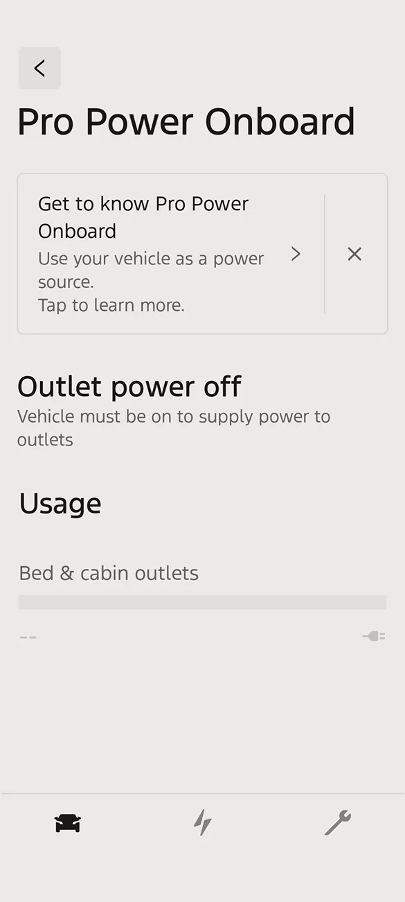

Color me shocked! PPO was not on my phone earlier this morning, but it is showing up now. Still running 6.3.0 and no update available.
