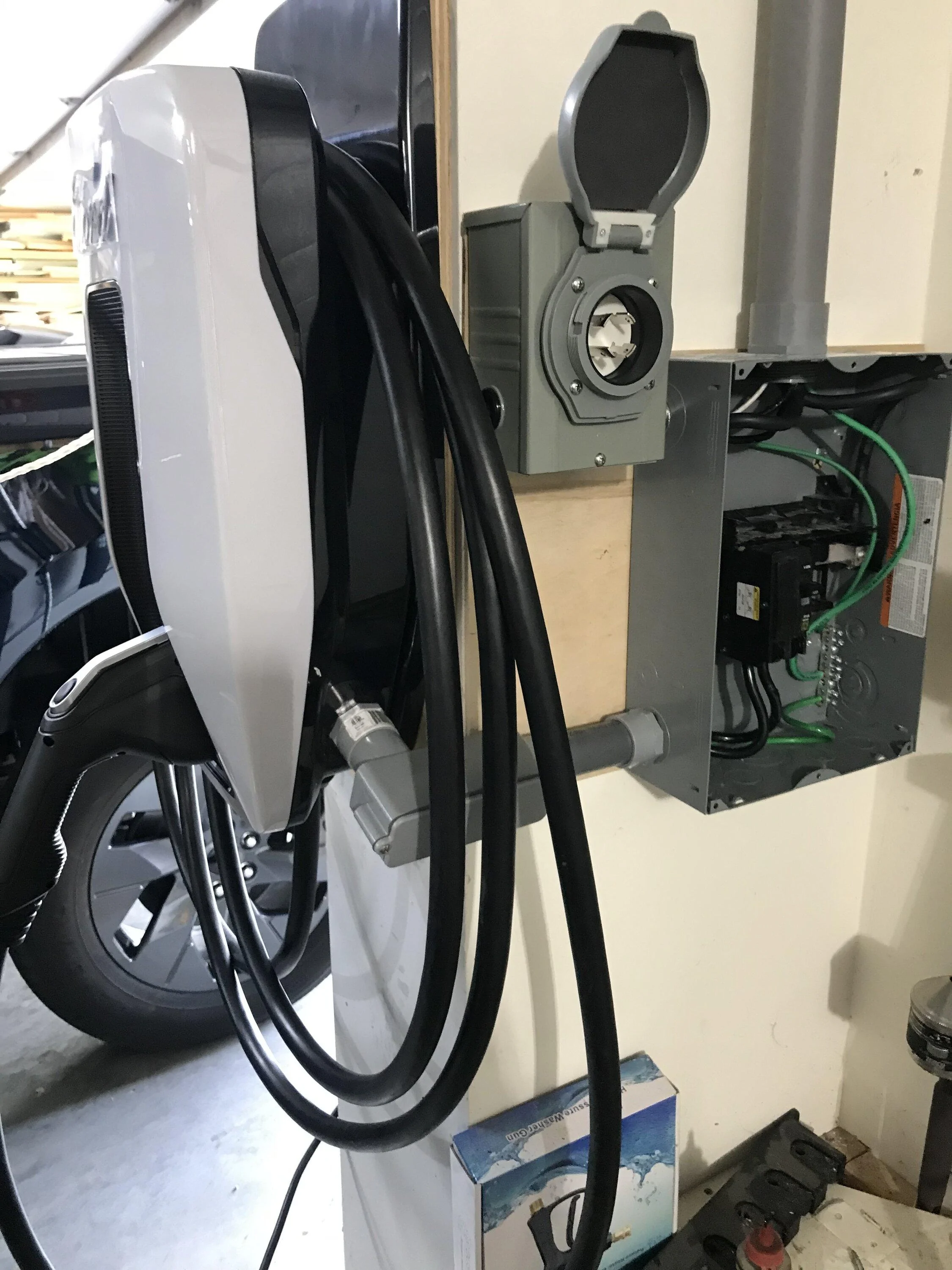

Hi, my FCSP finally arrived.
Do you have a disconnect switch in the picture? If so, what make and model?
It’s a Square-D 100A subpanel. For me, it was cheaper than buying a 100A disconnect. I’ll get you the model # when I get a chance.
Thank you. I was wondering. I just picked up a GE TGN3323 100A - 240V -MODEL 9- Indoor Safety Disconnect Switch.. for my install.
4,414
5,928
That should work fine. I used a QO6-12L 100S.
