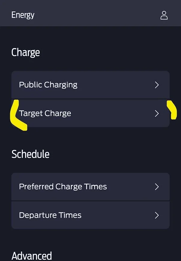

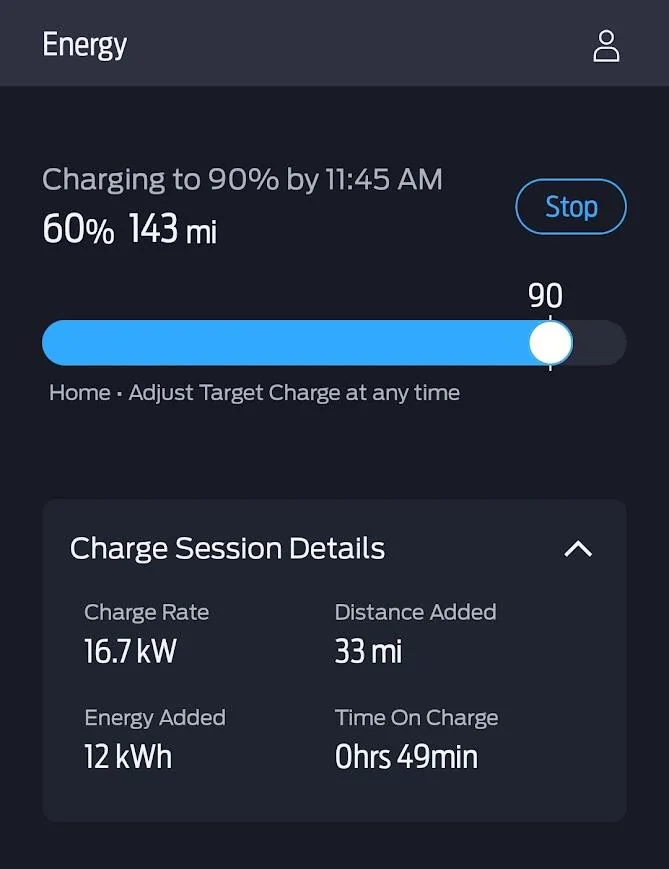

Are you able to manipulate the value here after manually tapping the START charge button?

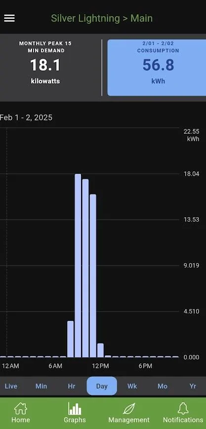

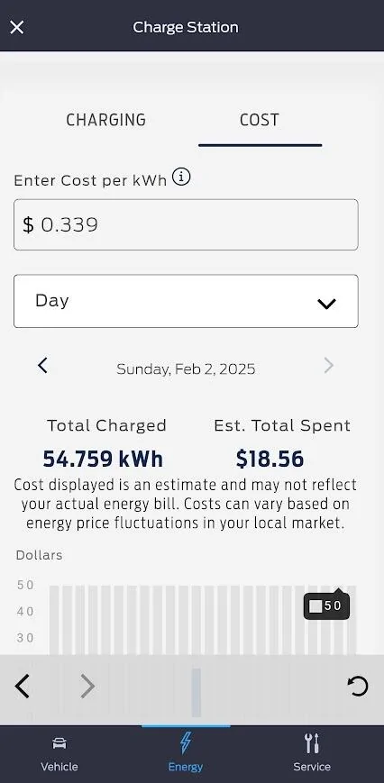

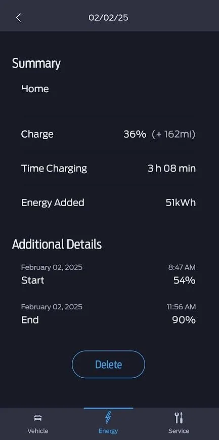

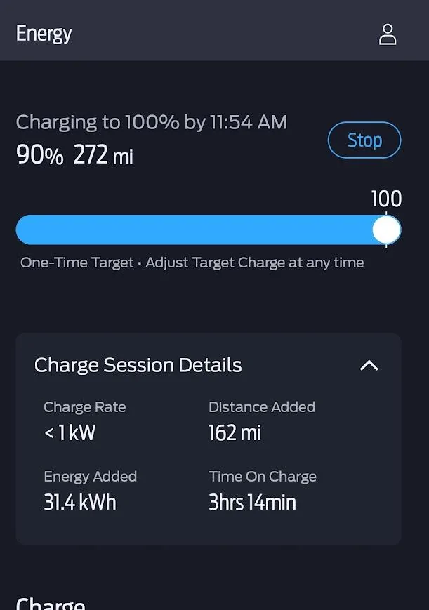

After finishing my end of week charging today, I wanted to see what the current session record showed for kWH sent to the battery, so I tapped the START button, that automatically overrules any programmed location based rules (Time & SOC limits), also note the 31.4 kWh is fictitious it stopped accumulating in the last 90 minutes of charging, the Emporia & FCSP insights log as well as the after action charge report in FordPass showed more accurate values.

Taxmanhog; Yeah I tried using both the charge page and target charge to set the max charge and in both cases, it reset to scheduled at whatever I set the max charge at.
I also see similar erroneous energy numbers. It appears that mine stopped counting about 2 hours into the charge session which was not when I was messing with charge scheduling. I did that in the first half hour. I will have to look at what fordpass reports after the charge cycle completes.
