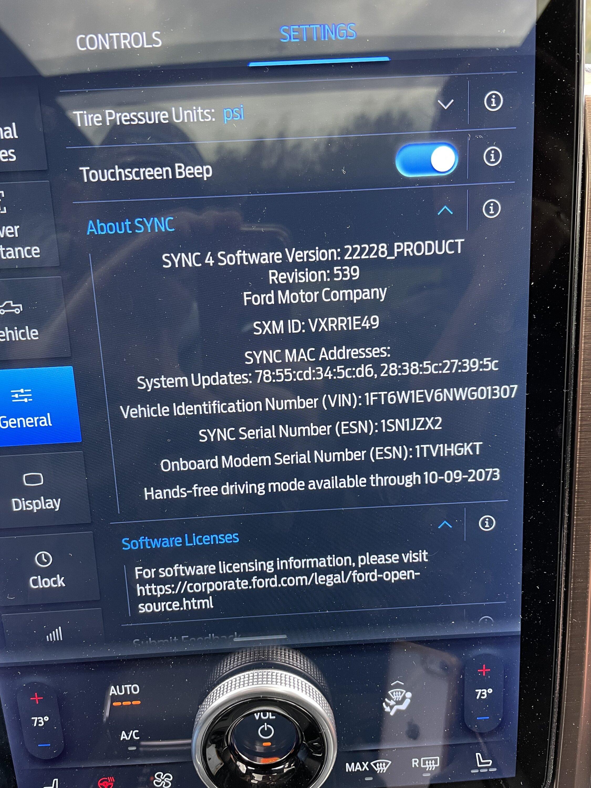

I have included a screen shot of the Sync info on my 2022 Lariat. I have looked everywhere for the type of update information you have included here. What am I missing?
I was at the same Version you are showing (First and Second line in the photo) and the dealer did update it to version 610 but would not go to version 713.

So, I am multiple versions behind, right?

I am in the same boat on sync version 539. Sounds like dealer trip is required.
Yes, it appears so. I was just talking to my dealer and they indicated it would have to be connected to do the update.
When I questioned the the current version status they actually pulled my truck up on their system and saw where the update had recently failed.
Not sure how I feel about that feature. It has its positives and negatives.
