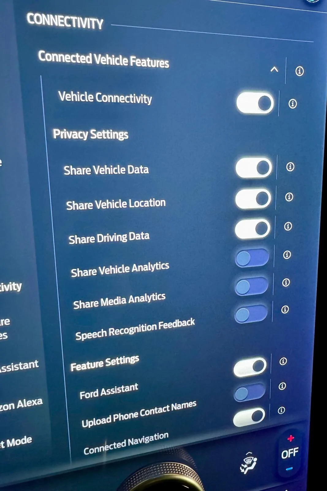

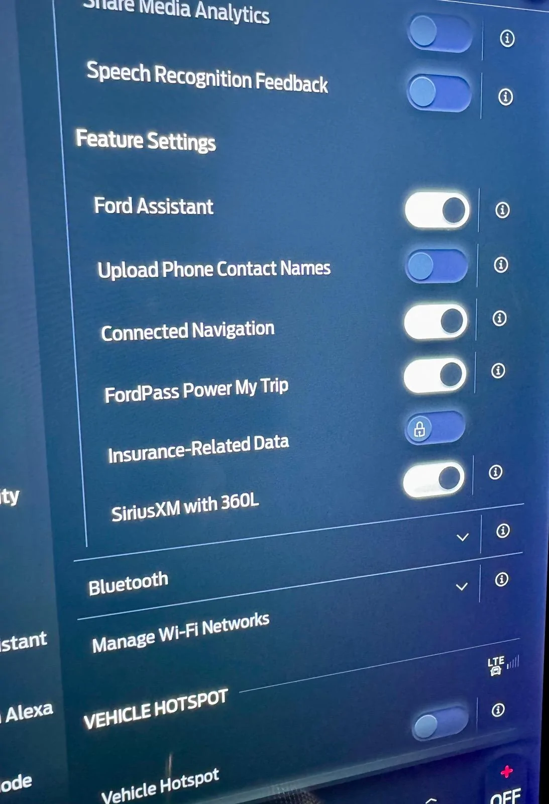

@MountainAlive , your Connectivity screen looks very different than mine (see photos). It is possible the dealer did not fully activate your truck upon sale.

Yes indeed. I wonder though if this is because I have the “fleet mode” screen which limits certain options.
