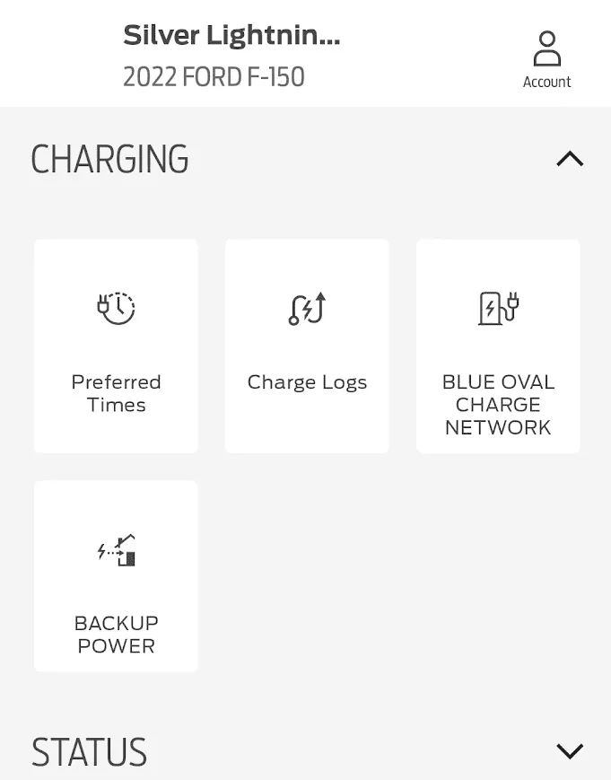

In the FordPass App, I can start the truck, get the latest battery status from the servers and maybe a few other things.

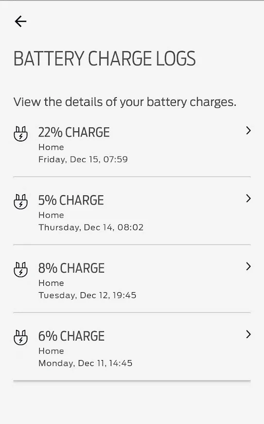

But the one thing that remains empty for me is the Charge Logs page.
I have a Ford charging account, I have charged a couple of times at various places, including an Electricfy America site just today to try out DC fast charging (peaked at 90kwh) and get my free tank of gas (so to speak).
So why doesn't the Charge Logs page in the FordPass app show anything at all? Did it stop working for everyone? It has never shown anything since the day I installed the app.
Thoughts? Experiences?

Have you enabled all data sharing from the settings in the Sync screen in the truck?
After three weeks you should have ~some~ historical records by now, but the latest version or two of the app has been delaying posting of charge events until late evening, sometimes they don't appear until the next day, though it seems to be improving lately.

Turned on most of the 'give it away' sharing toggles. It took about 5 days to actually get anything.
Yesterdays free charging at the local grocery store Volta charger showed up today. This is my first entry ever.
Today's 'this one is on Ford' Electrify America charge may not show up until tomorrow I guess.
