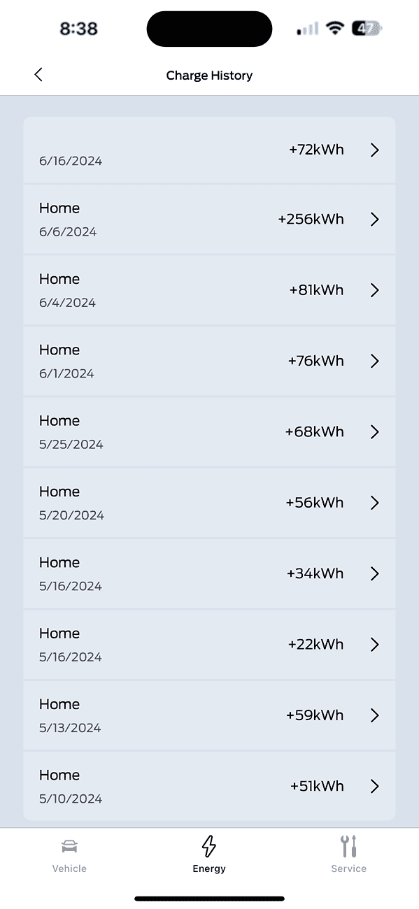

I had posted this picture a while back. Showing that I put almost double the amount of energy into the battery as it is capable of holding. My thoughts were maybe that I had gotten an OTA update that expanded my battery.-LOL
Ford F-150 Lightning Fordpass app, pretty sketchy . . IMG_0867

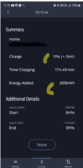

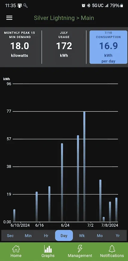

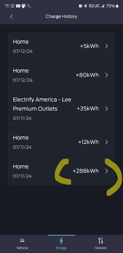

My experience..... actual energy used was only 16.9 kWh
Ford F-150 Lightning Fordpass app, pretty sketchy . . 1720883687348-gs
Ford F-150 Lightning Fordpass app, pretty sketchy . . 1720883943817-7l
Ford F-150 Lightning Fordpass app, pretty sketchy . . 1720884960532-ht
