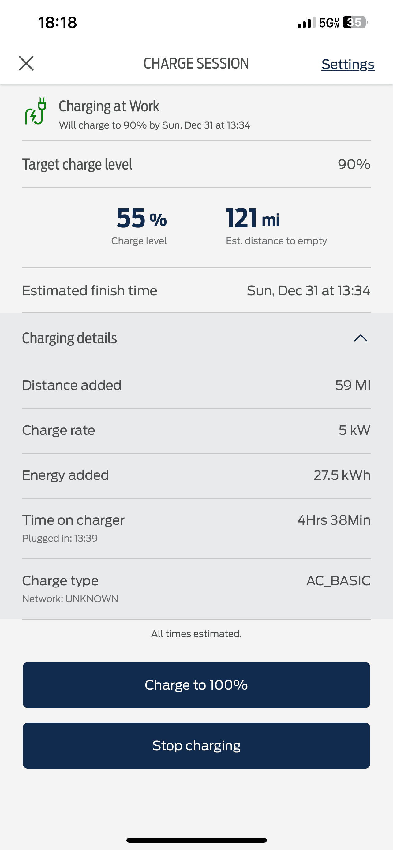

Really weird occurrence here. Fordpass app is showing done charging 2 days from now when it really is going to finish tonight based on the charge rate. Anyone else experience this?

The data on that screen is classic garbage, don't worry about it until the next version of FP is released

I just fixed this. Turns out the date in the truck was off by a few days. But it’s not obvious how to set the date! I ended up turning off auto clock sync and turning it back on. And all was well. I determined the issue when charging and looking at the Charge app in the vehicle. It was Thursday when I plugged in, but it said i plugged in on Sunday. Problem solved
Fixed, thank you!!
