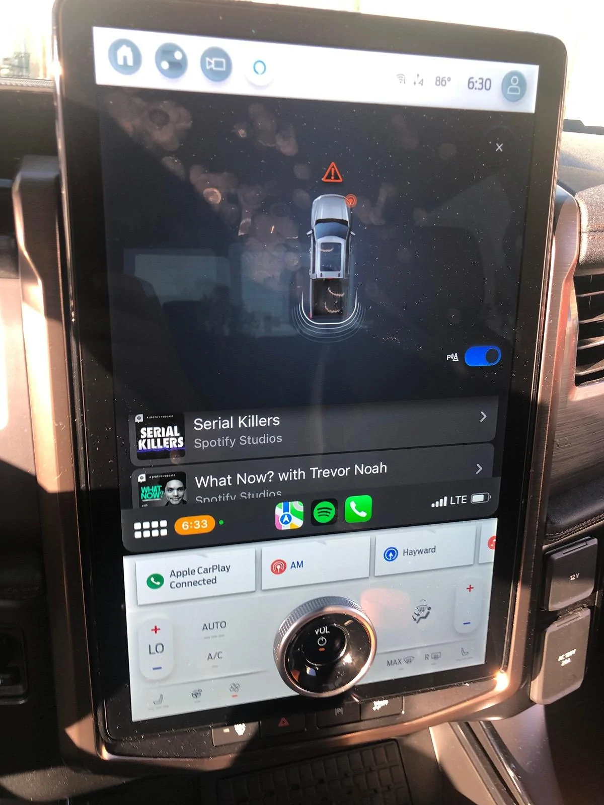

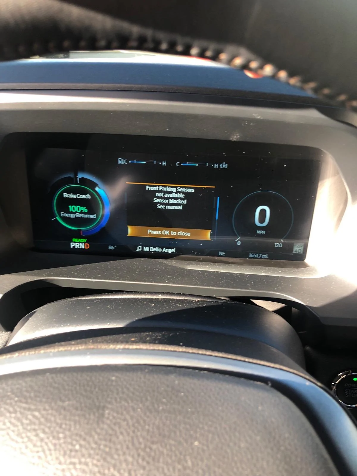

Hi Guys. I live in Cali so no snow. Truck is 1 month new and few days old. There two problems.

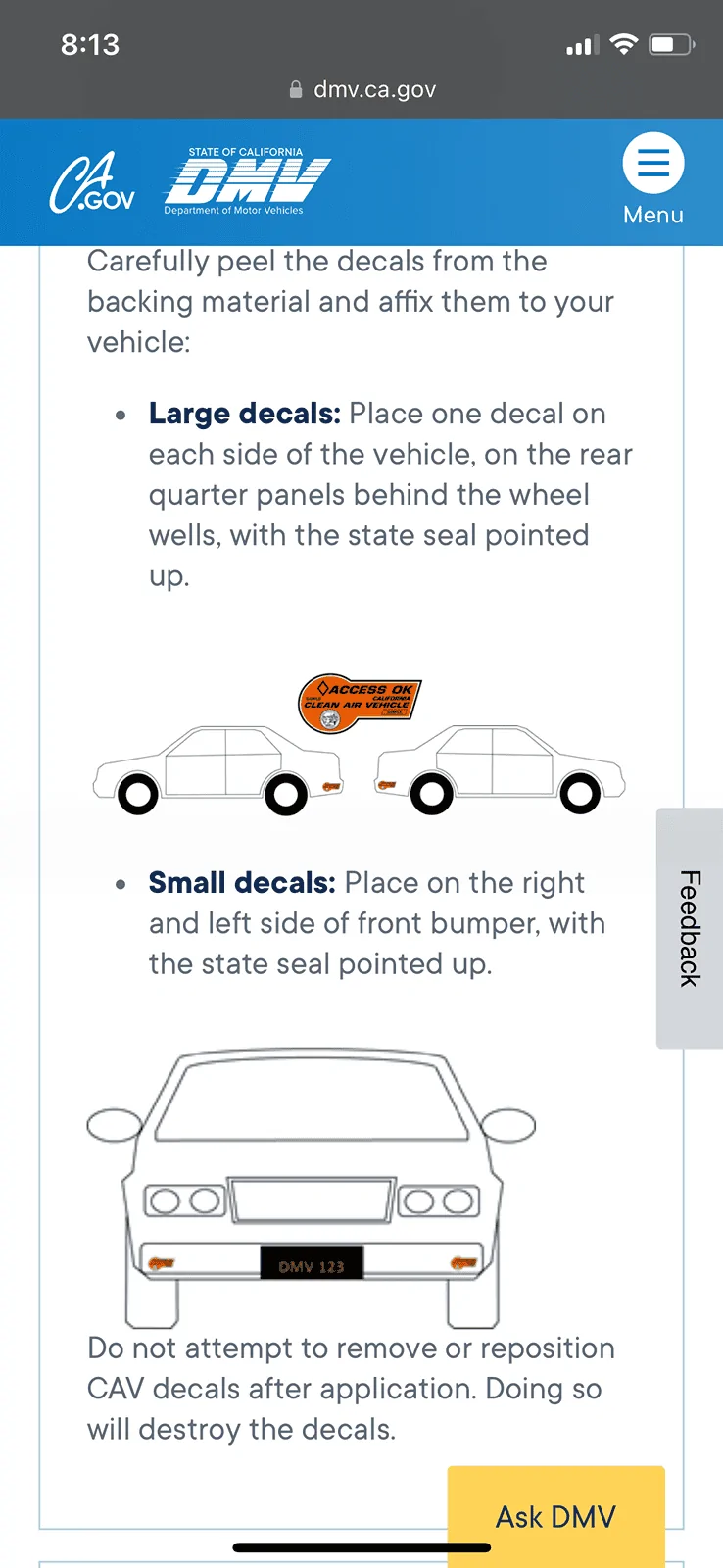

1. The same sensor blocked issue. This started two days ago after I applied the front HOV sticker.

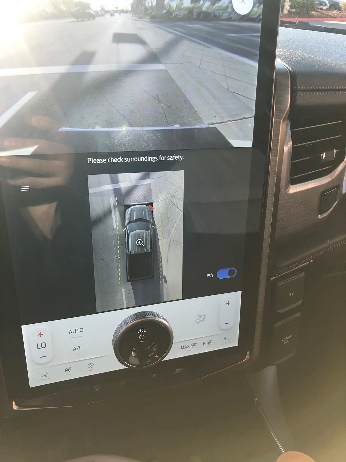

2. Front right side sensor red with “check surroundings for safety”. That’s been happening since day one.
any of you have the HOV stickers in the front bumper (as required by state law)? Well, at least here in California.
