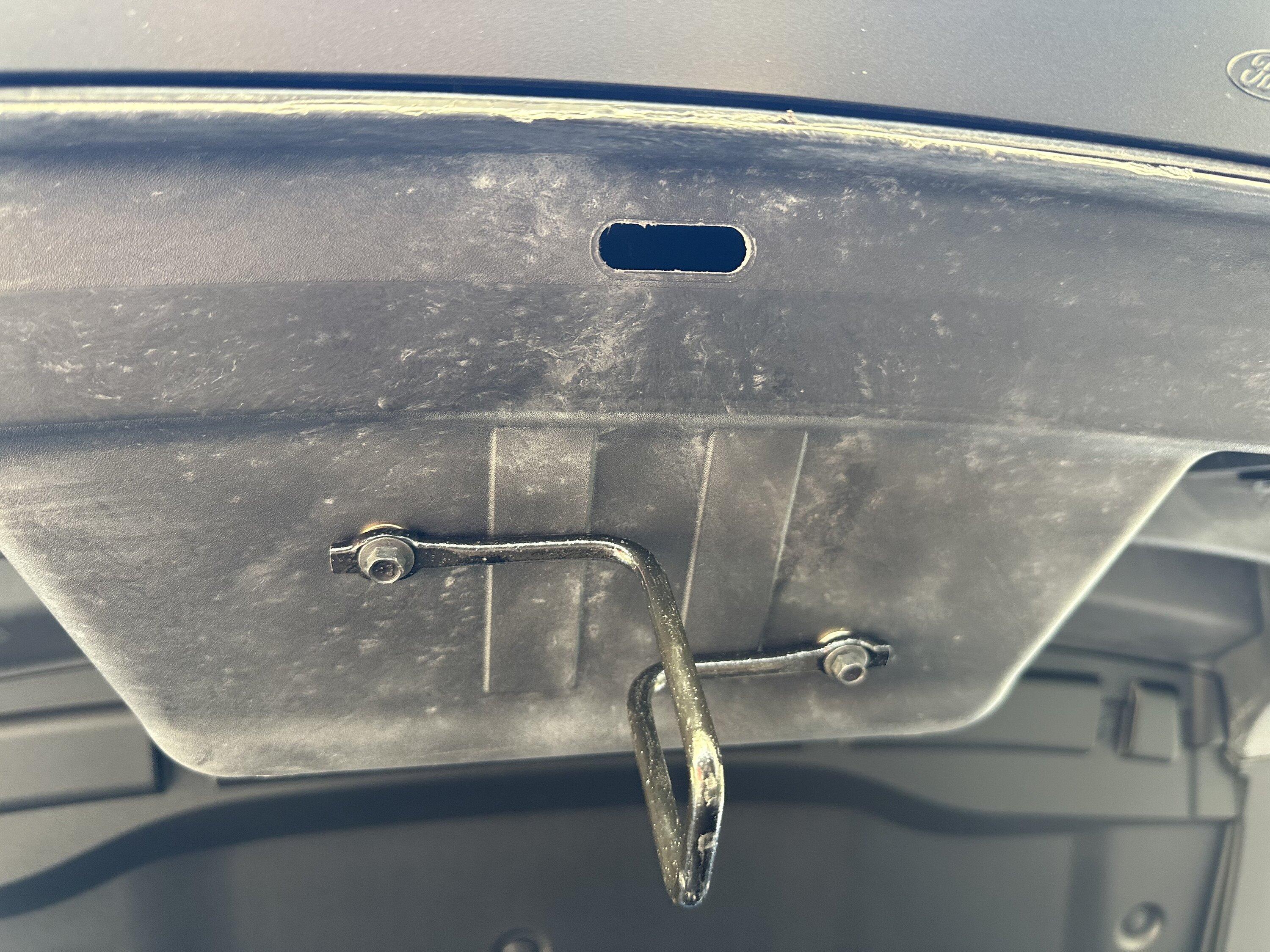

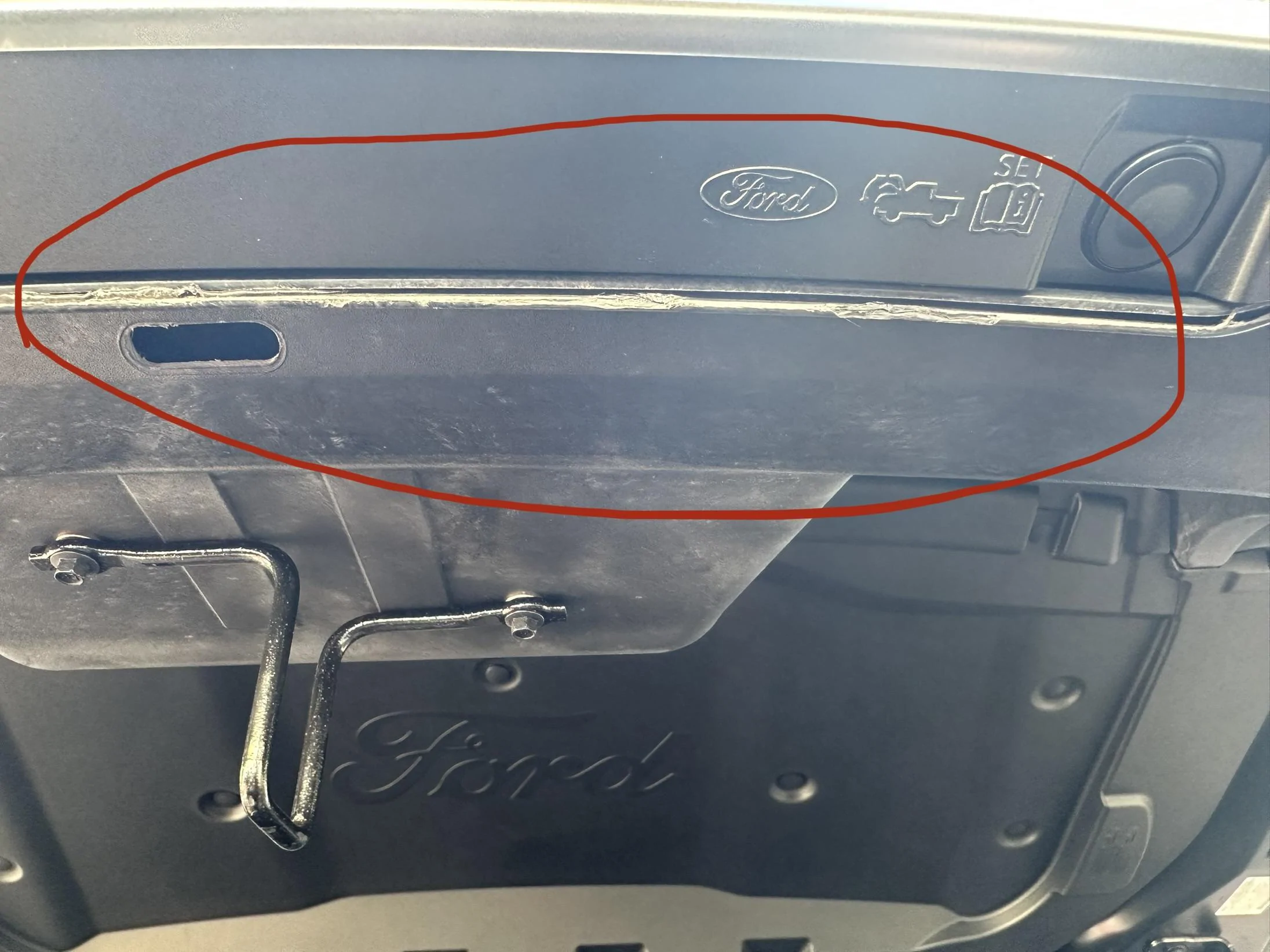

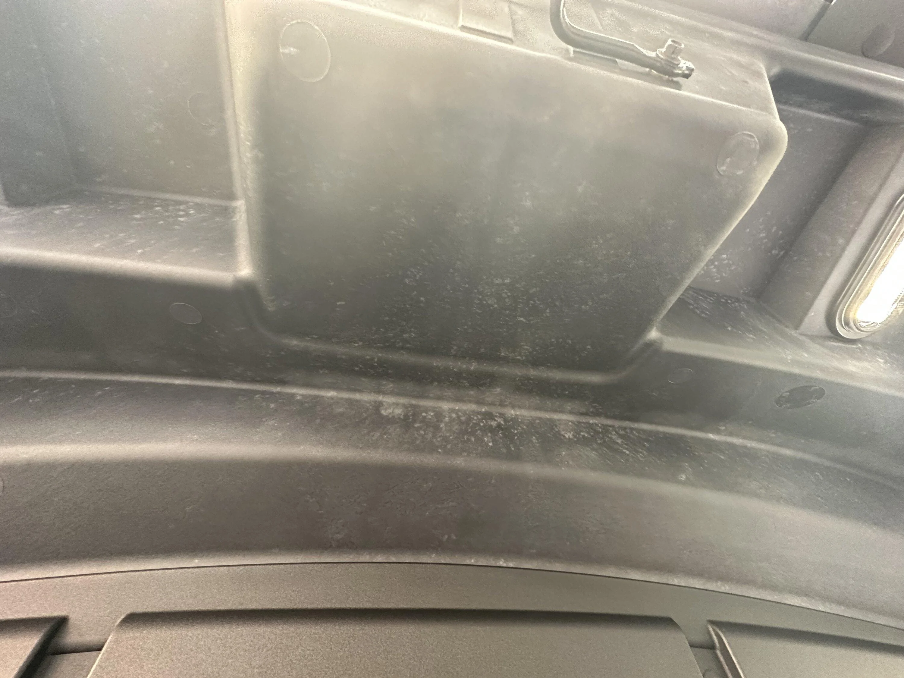

So my frunk opens about 50 % of the time. It will do the initial release and then bounce a bit but not open. I have to push it closed and then repeat the opening and it will usually go after that. Also has anybody else noticed the rough looking plastic on the under side of the frunk closest to the grill area? It looks like its been left in a salt water bath for a month! My detailer tried to clean it up with no success.
Does it look like white stains and white patches all over the place? I have that too and it looks like it can be cleaned but nothing I tried will clean it.
Can you post a picture? That's really weird
