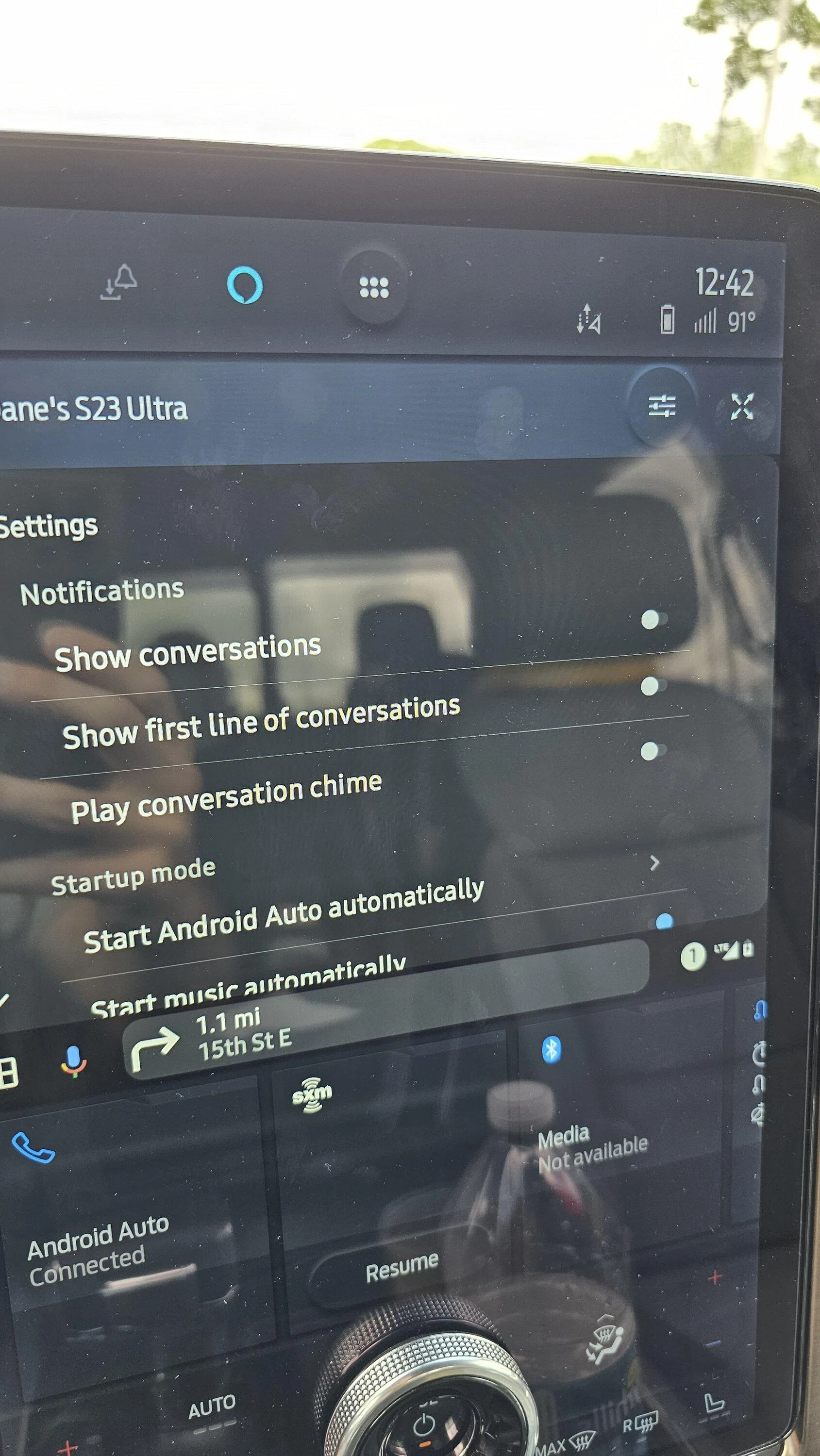

I'm going a bit insane. I'm getting max volume level chimes on phone notifications . I've disabled the chime from Android auto settings in both my phone AND in the truck Android auto setting. Why do I feel so challenged by this.

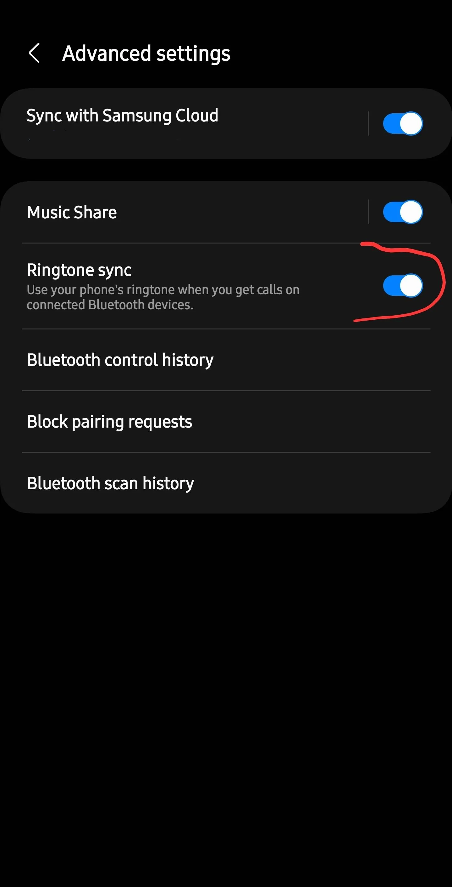

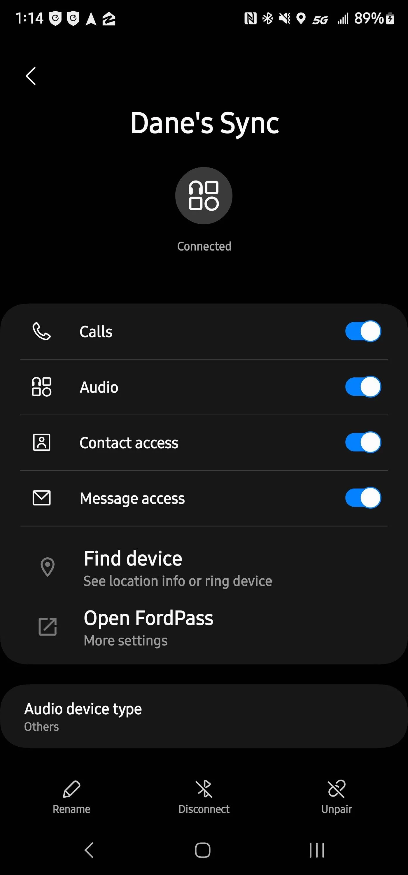

Not sure I see that one. See 2 images here from my Bluetooth area.
The one I circled red is is in the BT advanced.
The other image is only options within the SYNC bt device via phone

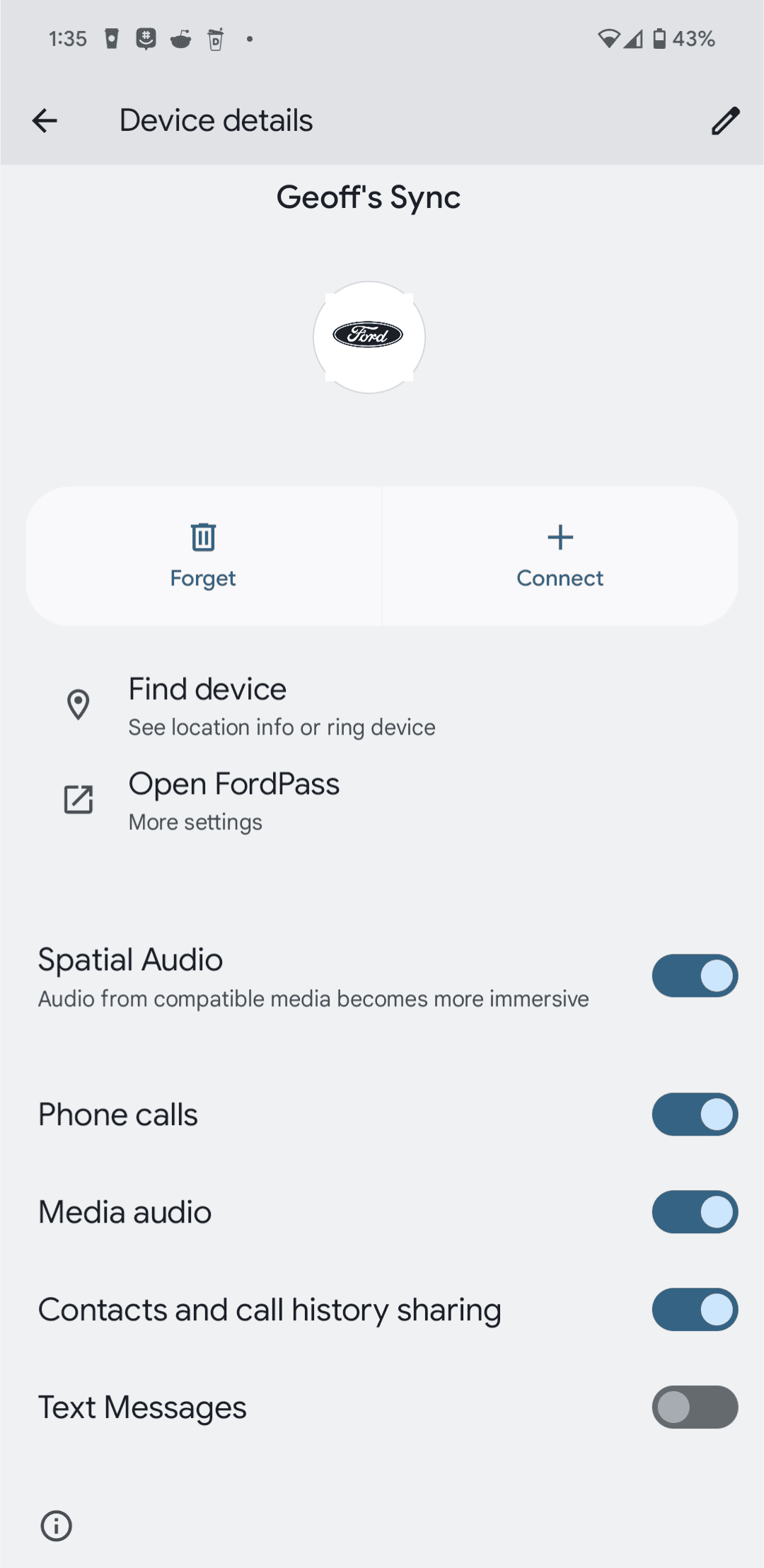

3rdgenfan
Geoff
Oct 4, 2022
385
393
Delaware
Turn off "Message Access" under Danes Sync. Mine was labeled "Text Messages" as seen below but fixed the annoying notification chime.
