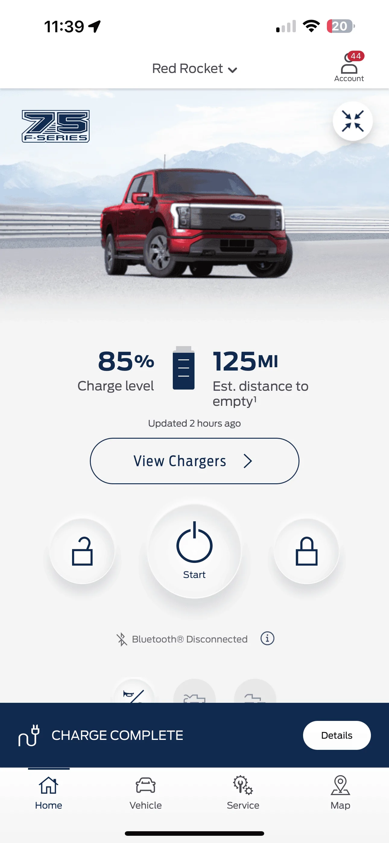

I had this happen yesterday after a 70 mile tow. Tow mode was off, trailer wasn’t selected. I reselected and remove it. It has persisted after a charging session. Need to drive some more to truly know if it’s “stuck” but if you’re seeing this too, may be a bug.

Same here, that's why I posted it... I've towed the same trailer about 10 times so far and this last trip is the only one that didn't reset upon disconnect.
