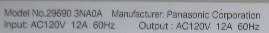

Panasonic made them for Nissan, Mitsubishi and Toyota - the model I have for my Leaf is 29690 3NA0A:
Ford F-150 Lightning Good Mobile EVSE option Panasonic Model 29690 3NA0A  120v 12A
You'll have to look for one that had the upgrade - you could search eBay or ask on the mynissanleaf.com forum, maybe someone would sell you theirs. Several Lightning owners there too.
