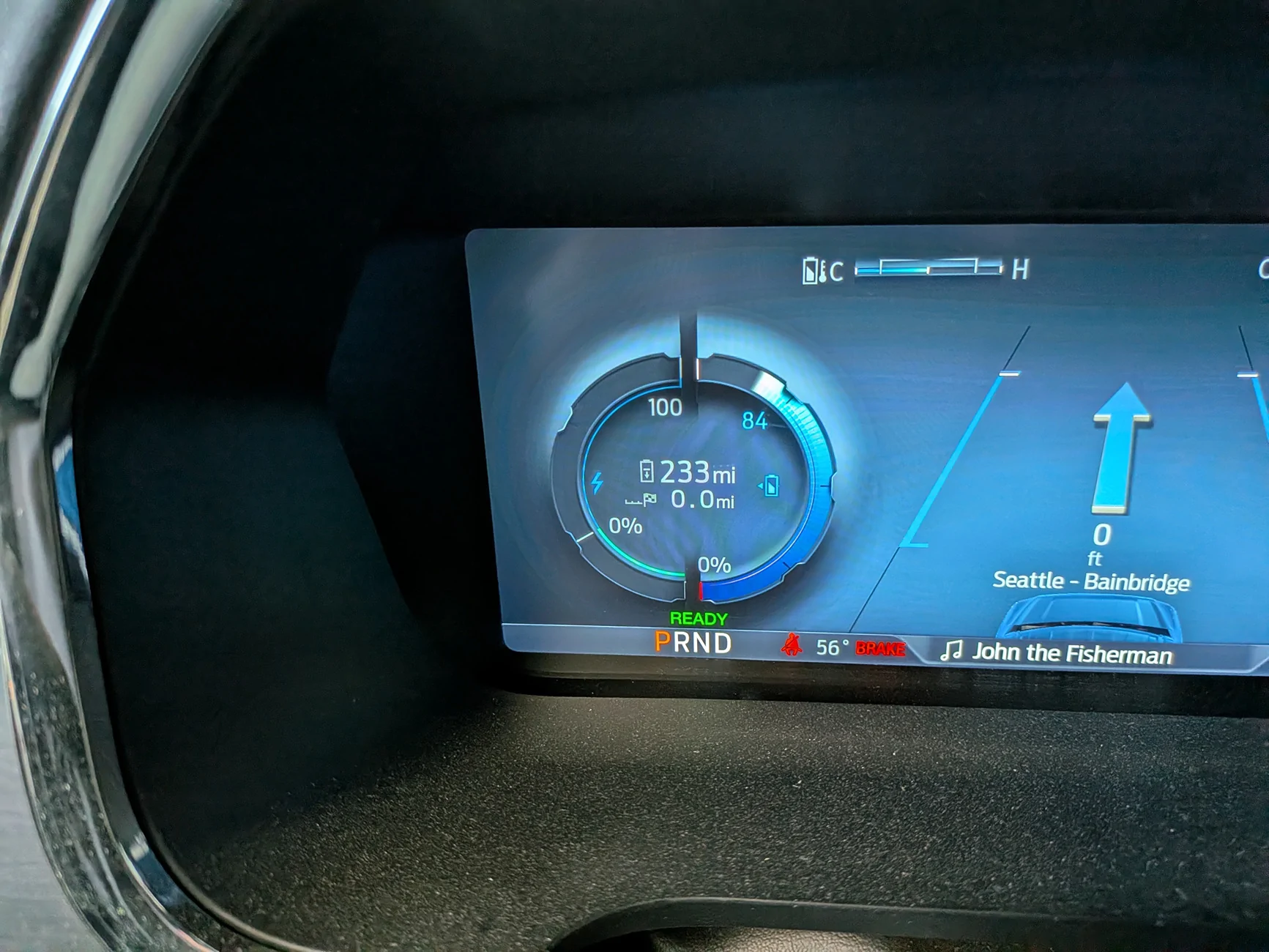

That's because of the ZERO MILES TO DESTINATION.
1) Uninstall GoogleMaps updates from your phone.
2) Now, it will precondtion...
You can find the APK for the previous version and install it also.

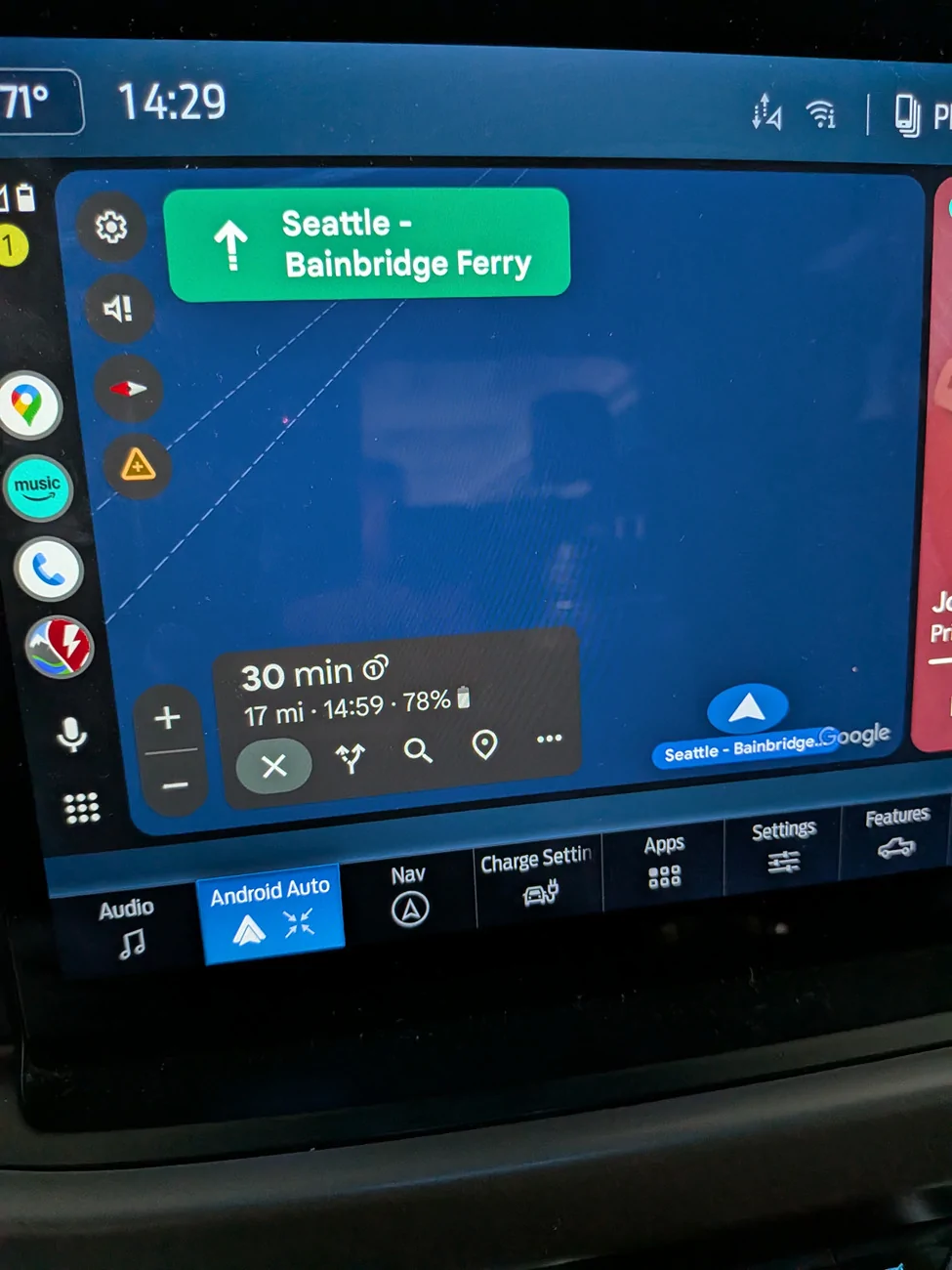

Latest version of Google Maps has a bug that always reports 0 miles until destination to the truck. Like @B177y showed, Android Auto still displays the correct number.
