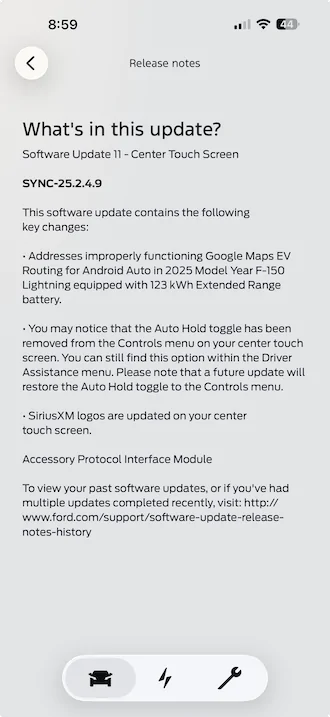

Ford F-150 Lightning No EV routing in Google maps 1763745880879-s4
Someone just posted this update that they just got; looks like Ford finally addressed the issue.

I can in fact say that it is indeed coming soon™ 🤐

Mine are different...
Ford F-150 Lightning No EV routing in Google maps 1000001004
My wife has the truck or else I would check if this fixed my 2024. I'll post later today

I just just received this update on my 2024 Flash but no EV routing in google maps yet
That is strange. They are the exact same packages. 24 and 25 unify on Gateway and APIM.

Well that was fast! I got the update last night and am now finally enjoying Android Auto with EV routing! Thanks for the fix Ford!
The fix seems to be very specific to 2025 F150 Lightning models with the 123kWh batteries (see the screenshot I posted a few posts earlier). This is what I have and the update fixed my issue. Maybe other model years have a different issue with AA EV routing???
