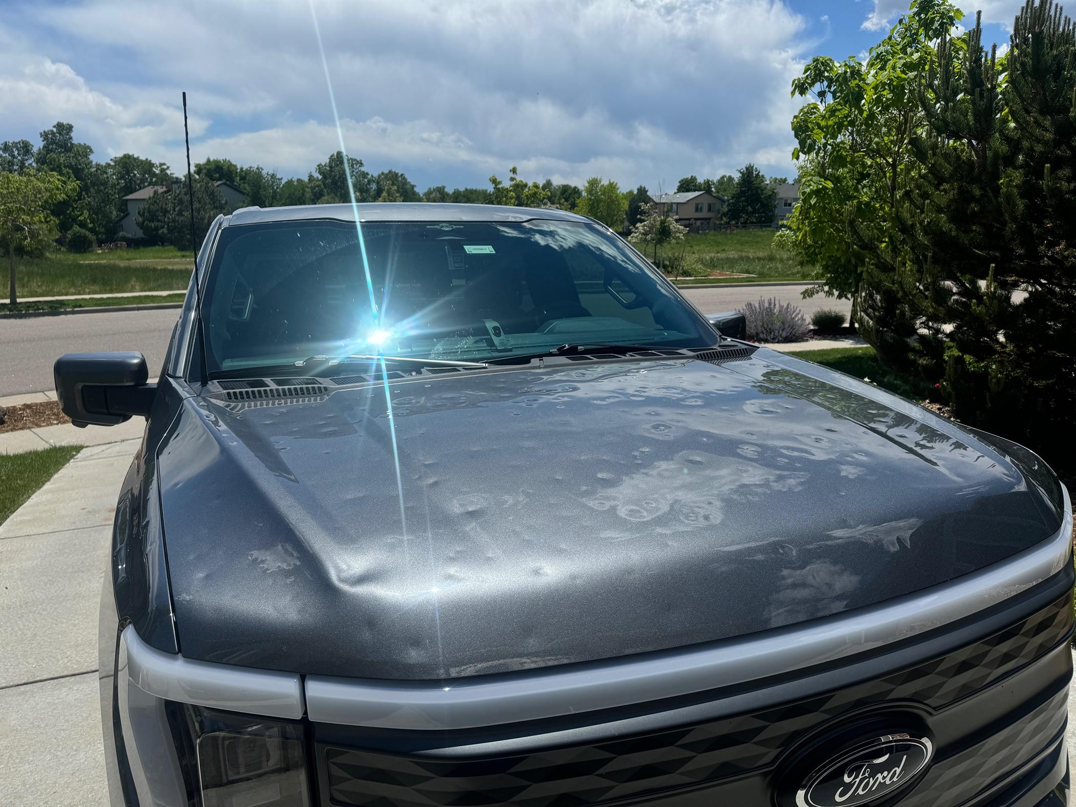

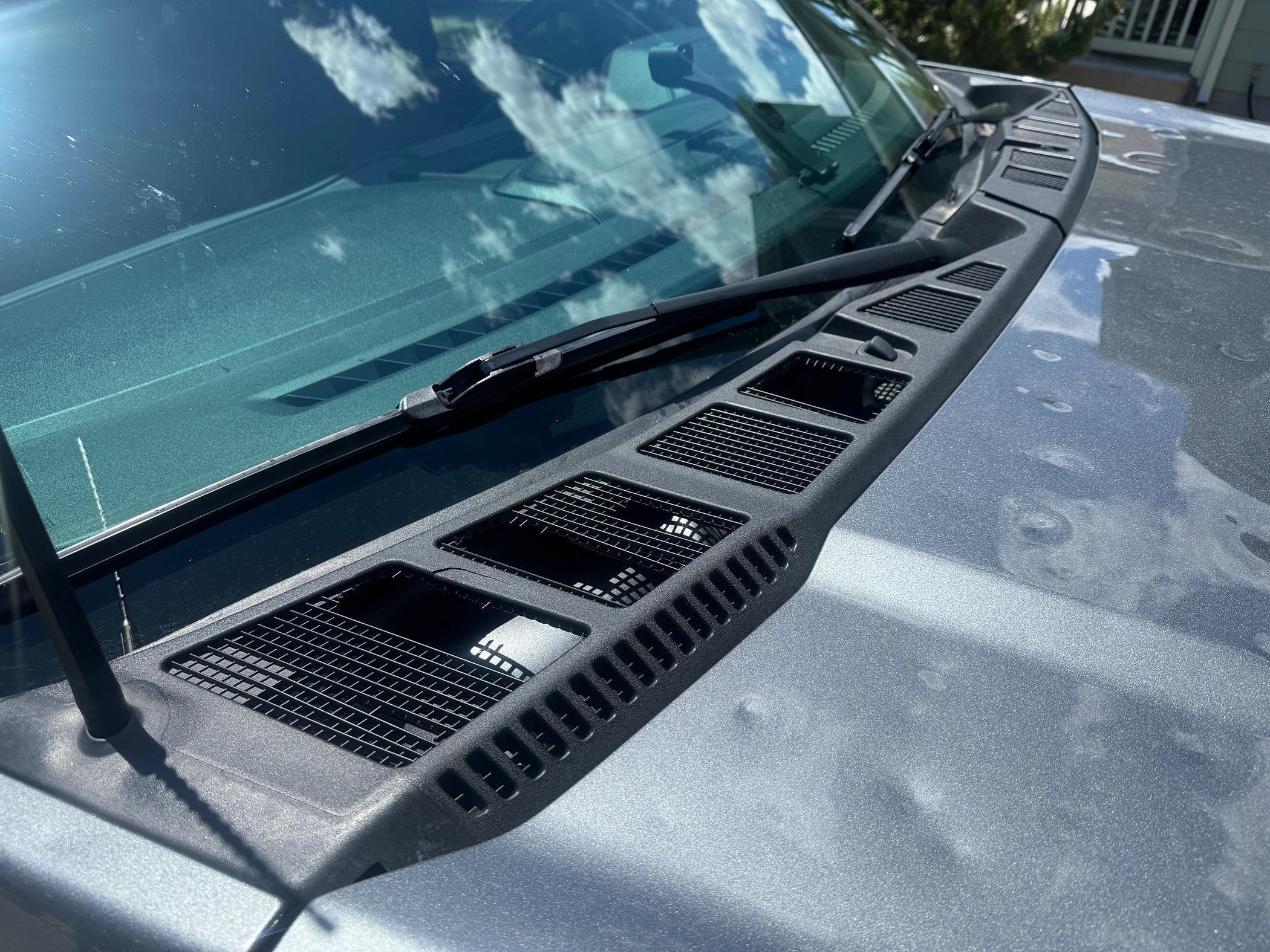

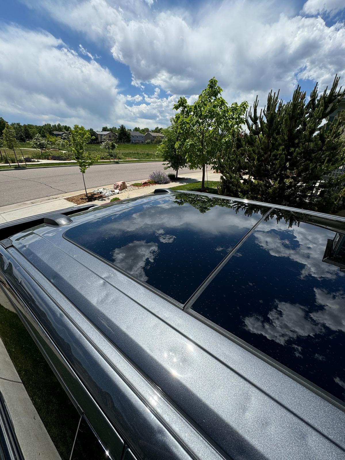

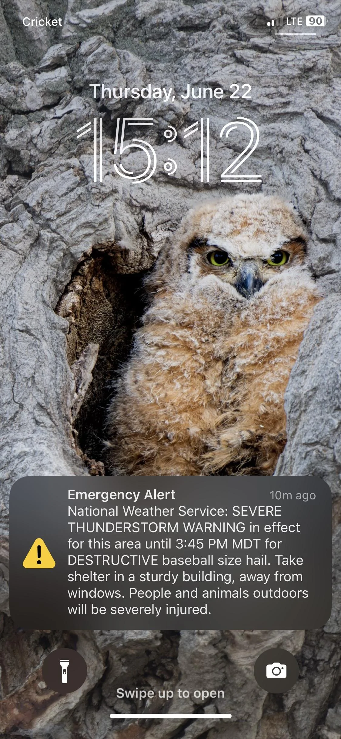

Was parked at the 61st & Pena station parking and ride while I was on a trip for three days. Haile’s Thursday night and I got back late Friday. Per the news hail from 2-4” fell and set a record for the last 35 years. I was under a covered area but hail came in at and angle and got pounded my truck. Started an insurance claim and will have a repair estimate this week.

Man that is brutal. Sorry to see that happened.

With that damage, I'm amazed that the windows and glass roof remained intact!
