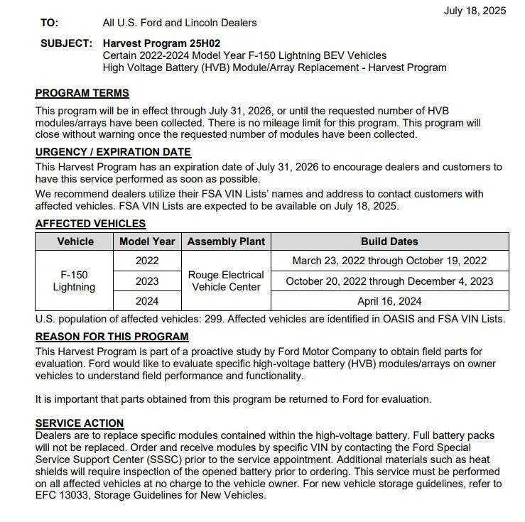

Below is the NHTSA chronology of events that have led to the harvest program. They are calling it a recall in their report. Looks like there have been 5 vehicle fires that may be related to a battery manufacturing defect that could be present in batteries built between Jan 2022 and April 2023. SK determined that there was a miscalibration on 8 stacker machines that could lead to a cathode shift (which may cause a short and/or fire.) Since 4 of the 5 fires destroyed the batteries, Ford could not conduct the research to verify that these trucks had the battery defect. It looks like Ford is looking for a representative field sample across trucks with batteries made during that time period to determine if the cathode shift is present in enough batteries to issue a full recall. I'm curious if this issue may be limited to specific sized/shaped modules that are tied to the specific production machinery that was miscalibrated or if all modules have the potential cathode problem. If it is all modules, we may see full battery packs being replaced soon.
Although my inclination is to leave well enough alone, whether I would participate in the harvest program would be defined by a. Proper compensation b. an offer to extend my battery warranty to include problems that may arise from the replacement after the 8 years/100k miles, and c. if I trust my dealer to be able to do the job correctly.
Here is the text from the NHTSA chronology report...

You may be right, that the Harvest Program 25h02 is related to this 25s18 Safety Recall (i will have 3 of my 9 modules replaced), but is there any documentation that directly says that?

I have the following, as part of the NHTSA Report on Battery Fires dated 28 Feb 2025:
Ford Recall 25S18 Chronology includes:
"On January 3, 2025, Ford received a fourth report of a fire involving a 2022 model year Ford F 150 BEV. On January 10, 2025, Ford Engineering received a battery array that had been replaced in one of the affected vehicles prior to the fire event. From January 2025 to February 2025, Ford conducted teardown analysis on this battery array and continued this detailed review of the supplier's manufacturing process. On January 24, 2025, while this teardown analysis and review was ongoing, Ford’s Field Review Committee authorized Harvest Program 25H02 to obtain additional physical samples from the field for in-depth evaluation and root cause analysis to facilitate further testing and understanding of root cause. "
It is confusing why it took 6 months before Harvest letters were received by folks .....
Interesting that the July letter is only going to 299 vehicles, unless a whole bunch of others were already taken between January and June for the 25H02 as mentioned in the 25S18 January notification. I hope Ford is backcharging SK On for this mess.

Got mine scheduled for September. Looks like they have an idea of what parts they need to replace since they don’t ask to bring the truck before hand to inspect.
I think it's routine for automakers to charge suppliers. I know GM made LG pay for all the Bolt battery recall replacements.
