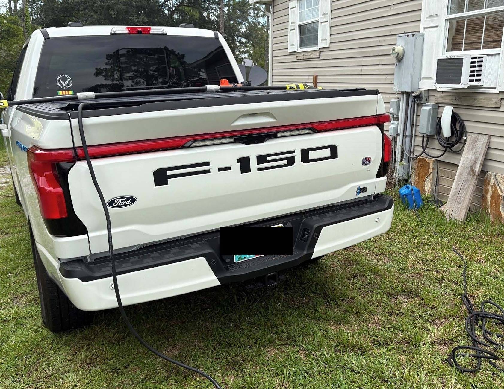

Below are some pictures of just 2 days ago where we had to use the Lightning to power the cabin for 6 hours while FPL repaired the main line that cause 104 homes to be without power due to a tree falling on a power line.

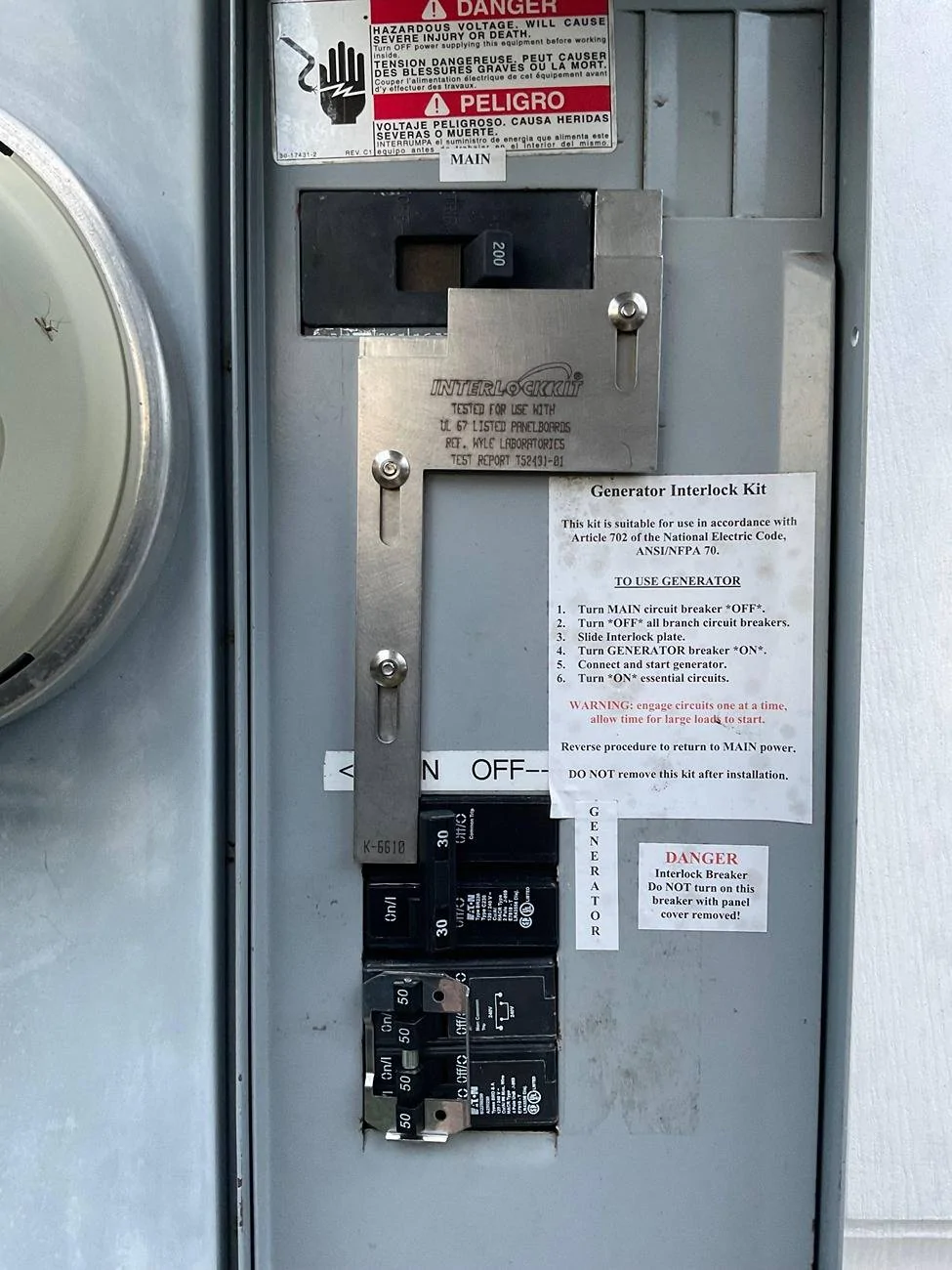

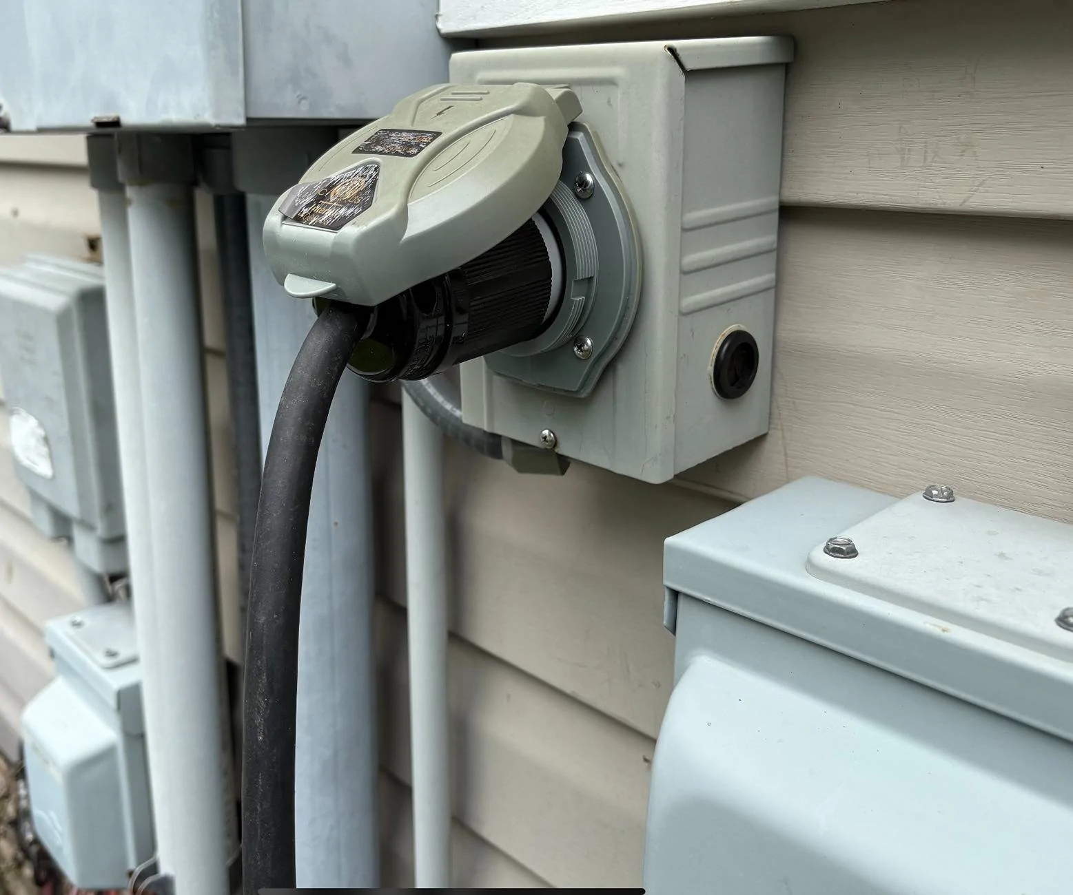

I have an Interlock Bypass kit on the main breaker to safely prevent both grid power and generator power to feed the house at the same time. https://interlockkit.com/
A dedicated 30 amp breaker connects the generator inlet to the house.
It was originally installed to use our gas generator to power the house when grid power is out. Using the gas generator I use a standard generator cable.
When using the Lightning to power the cabin, I have a custom modified generator cable without a ground connection. This eliminates the truck GFCI from tripping and keeps the house wiring code compliant.
Total cost of parts on the cabin side is less than $200. Each breaker panel has a different interlock bypass kit.
