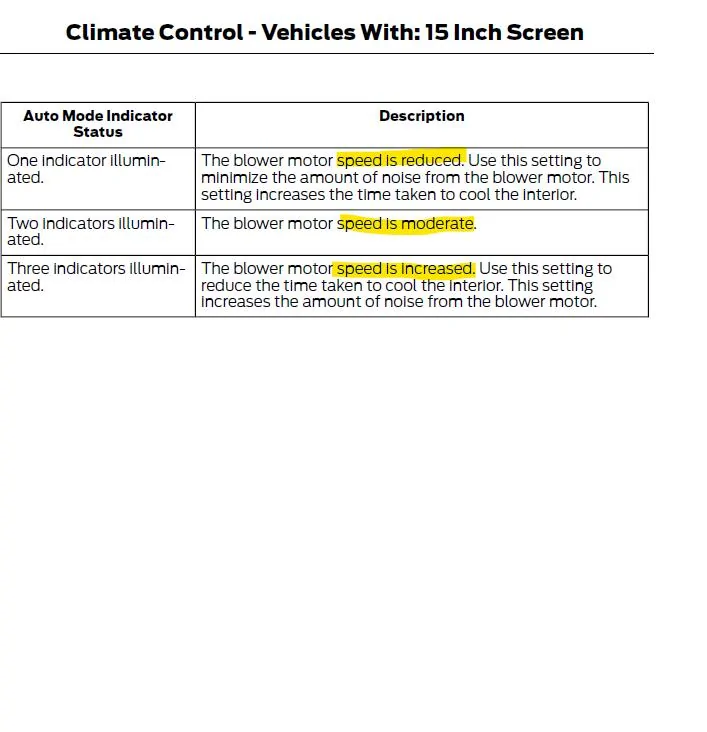

This afternoon, I was tinkering with the AUTO setting button and it's impact on fan speed, we've noticed in the past the AUTO-2 was more reactive and under certain conditions might cause a higher fan speed than AUTO-3, counter intuitive right?!?
Back story, the temp was at 62 which I had lowered from earlier in the day at the close of a long 170 mile road trip, battery was low at 15% {running hard & fast} I wanted to ensure I could get home without stopping for a charge so I went spartan chilly
Made it home OK, then when we went out a couple hours later for a short ride that 15% was fine to make, but the cabin was cold and raw, I forgot to remote start, so I put it in AUTO-2, jacked up temp from 62 to where I normally keep it around 75, then 80, interestingly the fan speeds increased systematically without actually dialing up the fan speed manually.
I repeated this process on AUTO-3, there was no increase of speed until I hit the HI point setting, then the fan increased in speed, same process with AUTO-1.
So, I suspect the dynamic algorithm is failing in AUTO-1 and AUTO-3, @Ford Motor Company , let's get that fixed!

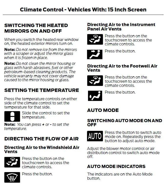

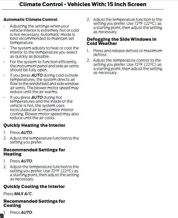

The instructions:
Ford F-150 Lightning Heating - Temperature Adjustment 1743341213499-5m
Ford F-150 Lightning Heating - Temperature Adjustment 1743341272529-7c
Ford F-150 Lightning Heating - Temperature Adjustment 1743341421531-pr
