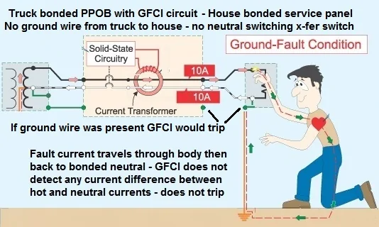

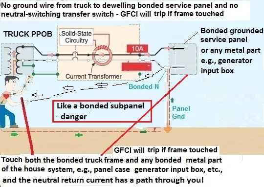

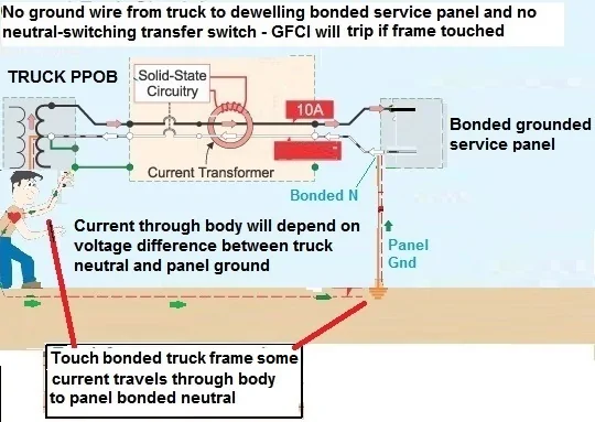

The people claiming this is dangerous and deadly thusfar have not provided anything to substantiate that claim. It is not deadly. It is not dangerous.
It absolutely is dangerous and potentially deadly. The why has been explained MANY times here on this forum. @chl has drawn it out more than once. The short answer is that you potentially become part of the current path in the event of the right failure. The GFCI MIGHT keep it from killing you, but are you going to risk your life depending on the GFCI? The electrical code is there for a reason.
