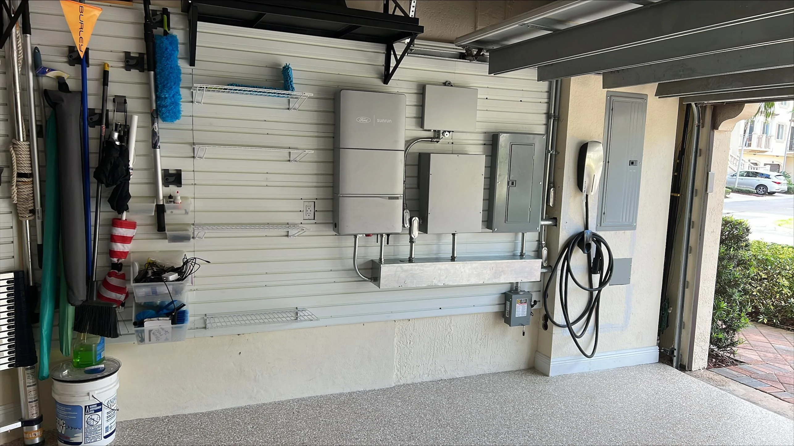

This is what SunRun’s subcontractor left after a week working onsite - not one wire run in the conduit except a temp hookup to the charger itself. Hard to believe anyone would install a charger at knee level. I was motorcycling in South America while they did the work…

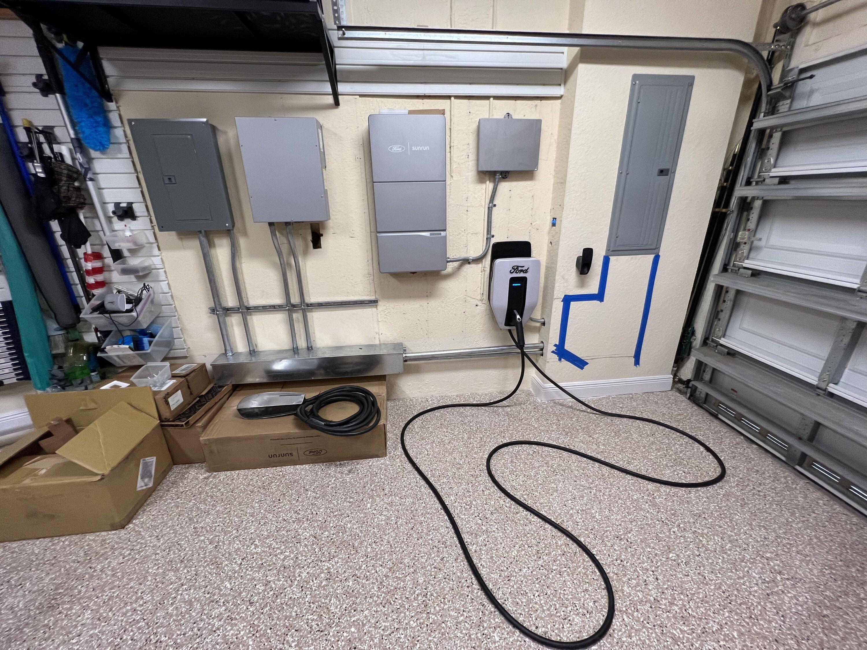

This is after SunRun came in, tore out the first team’s “work”, cleaned everything up, reinstalled the slatwall the first guys stupidly tore off, and put the system up correctly, with reinstalled Tesla charger. The Ford charger is on the facing wall behind the photographer:

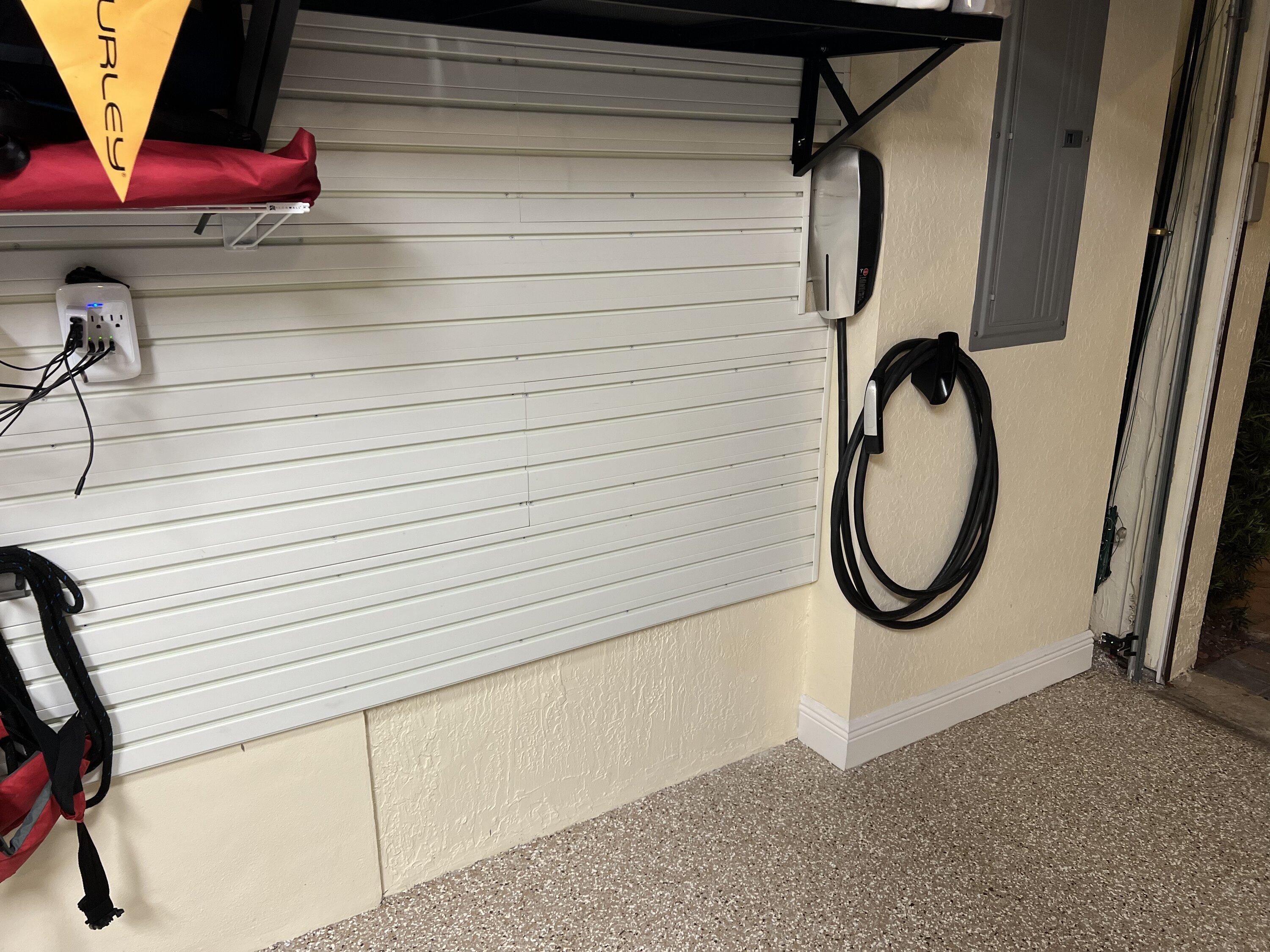

The wall before any work began:

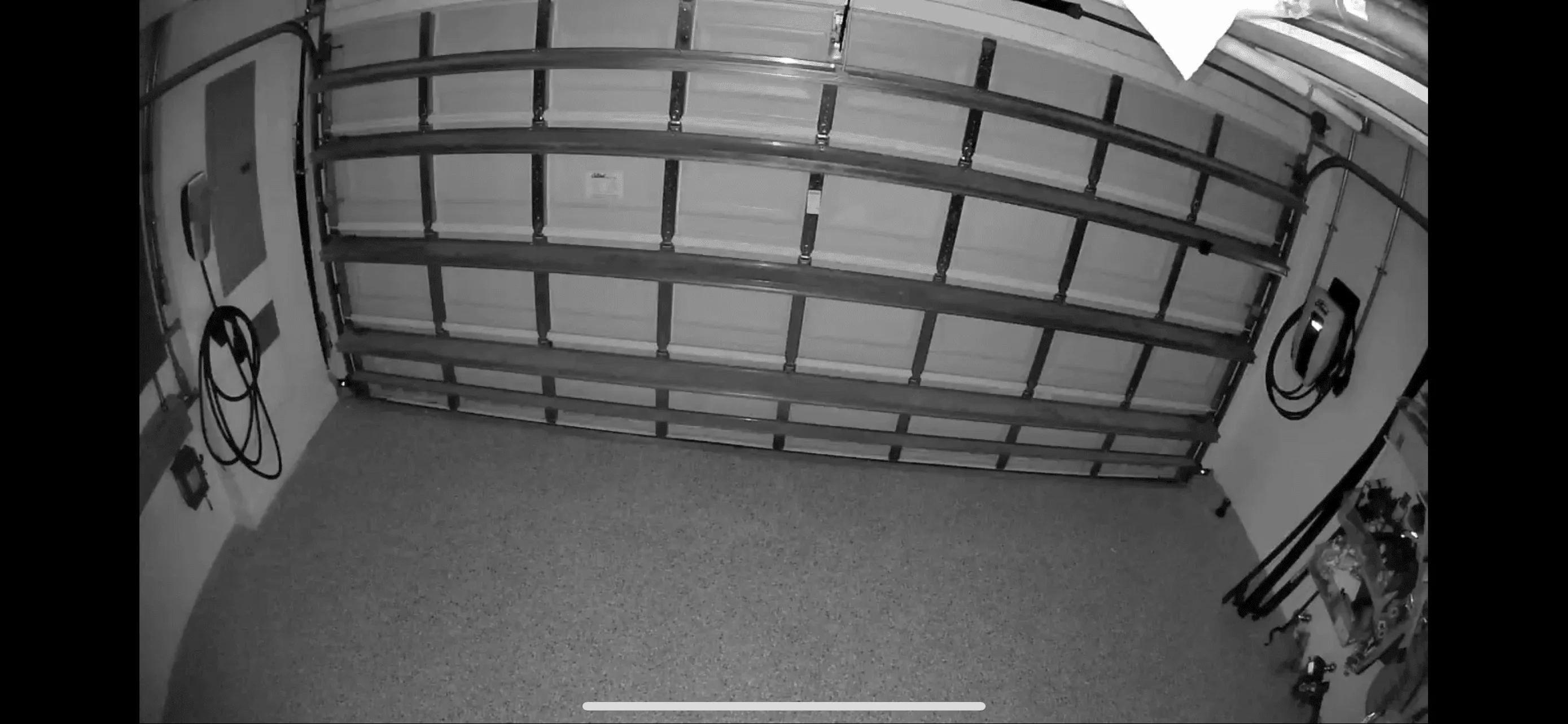

As it is today, infrared view seen from the MyQ garage cam (allows Amazon to do inside home deliveries), showing Ford charger on right, Tesla charger on left, HIS on left.

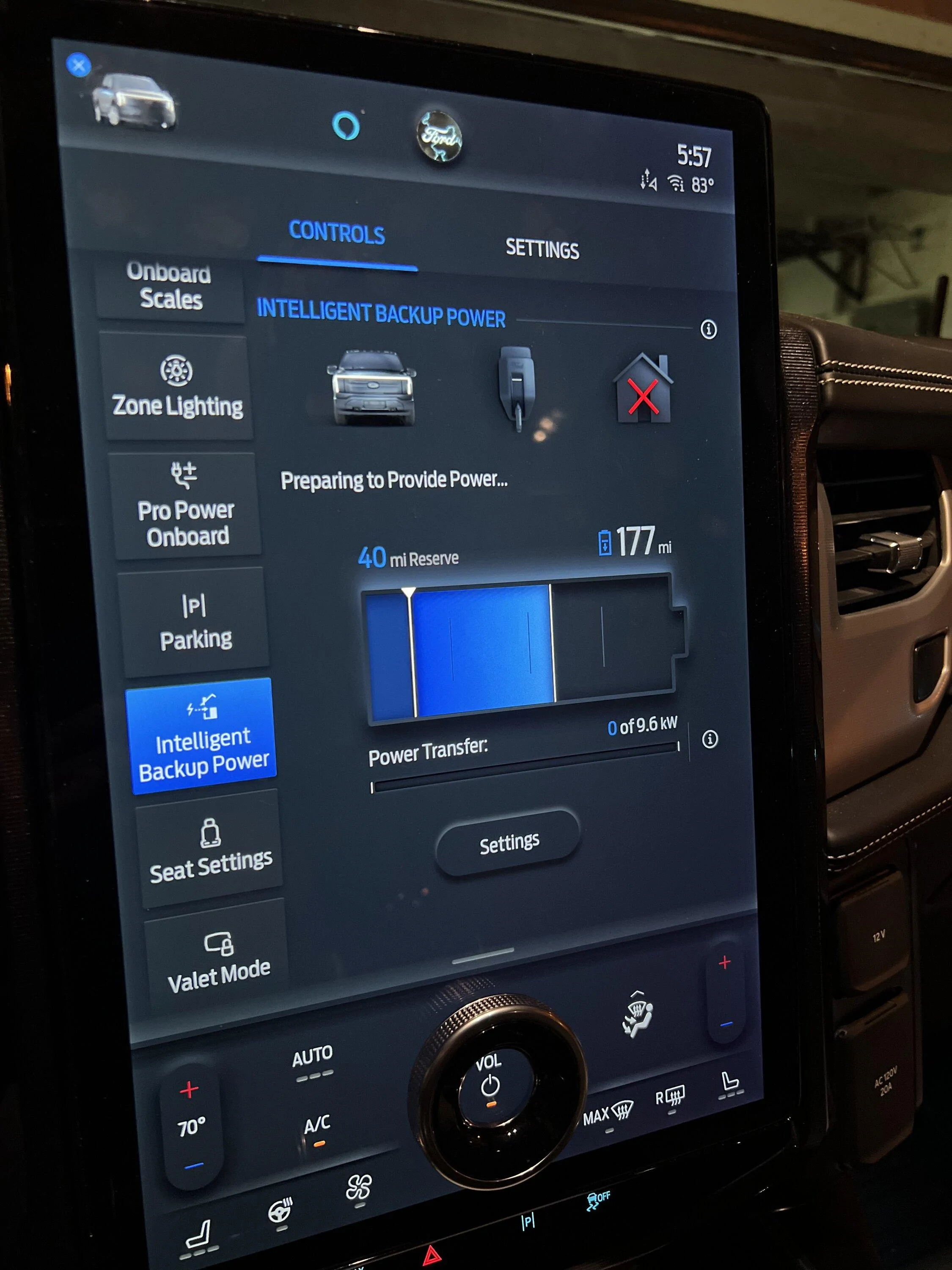

What happens within two minutes of power going off at main switch and truck starting to run house. It “works” with home receiving about 1.4 kw, lighting & refrigerators are on, but not for long.

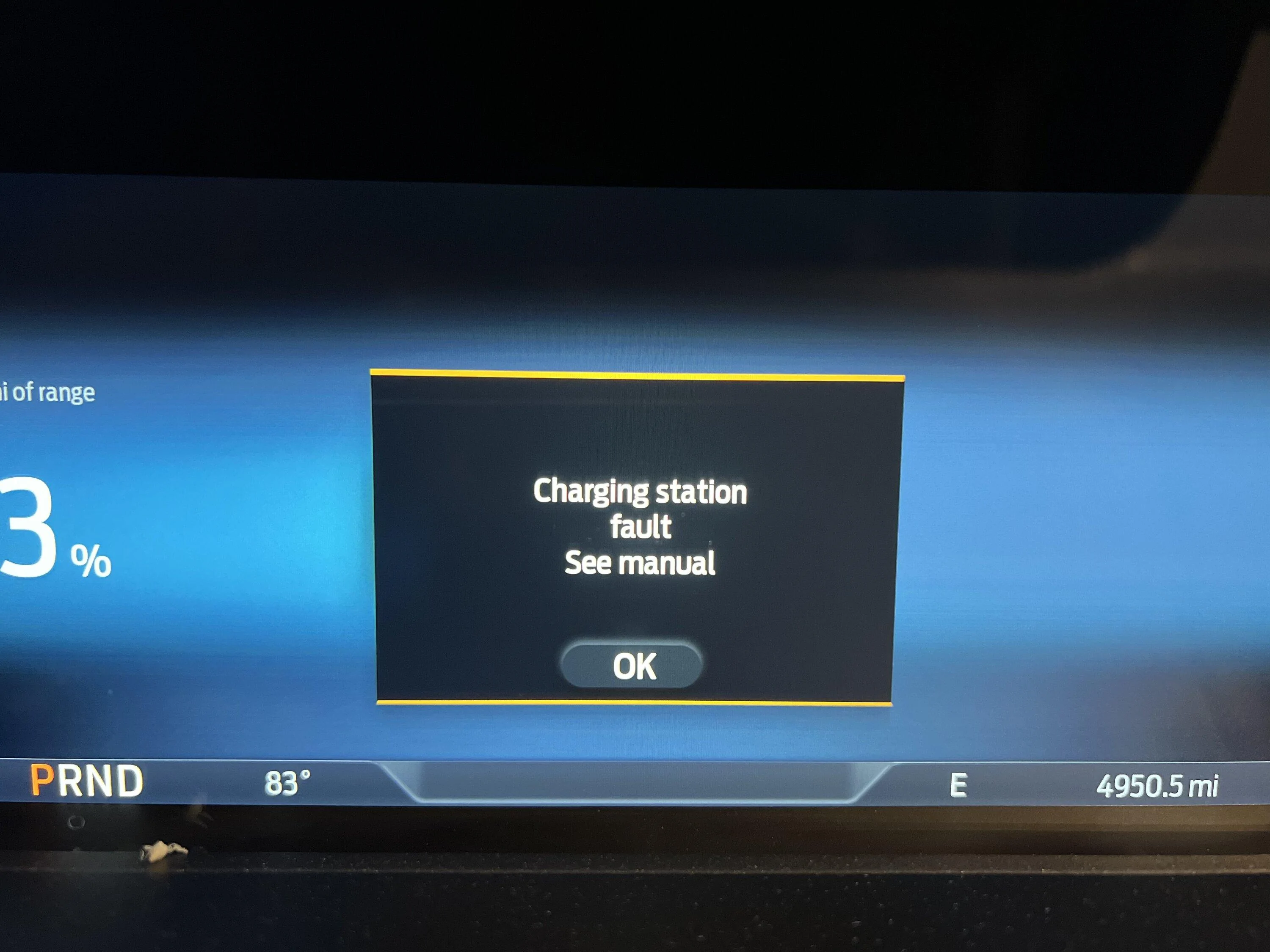

This is the initiation screen after power goes out. Mine gets past this… then craps out.

Thanks for the pictures of the install. When I heard Sunrun had assigned an outside local contractor who had never installed a HIS system before that is when I cancelled them. Amazing after all this time they still do not have their act together. At least the layout is alot more professionally done than the first install. Does the system throw an error code when it shuts down?
Is the breaker panel to the left of the main panel near garage opening a critical loads panel that they installed and you specified which circuits you wanted powered? Did they limit you to 40A per 120V phase on that panel or did they derate load for likely use and allow more breakers? I assume they put the 200A disconnect between the main panel and your critical loads panel? On the Ford charger did they run two EMT conduits to the charger, one for the AC power and one for the 400V DC and control back to the HIS?

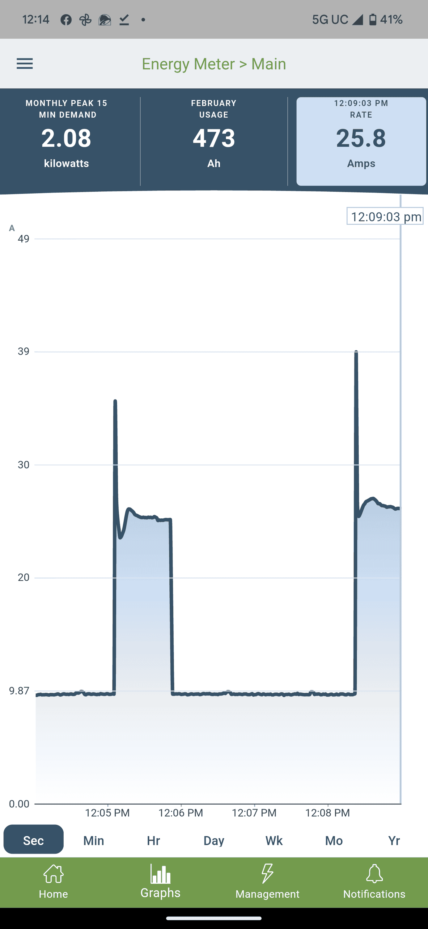

I was thinking this exact thing. And I just seen this video on TikTok demoing a soft start system for ac compressors to lower the initial draw to use ac with a generator. I monitored my ac startup using my energy monitor and I'm getting the highest rating during startup in for my whole house is 39 amps for 1 sec. Do you think the breaker will trip for that one second spike? It's about 25% over the rating.
Ford F-150 Lightning Home integration - uses beyond F-150 Lightning? Screenshot_20230212-121459
