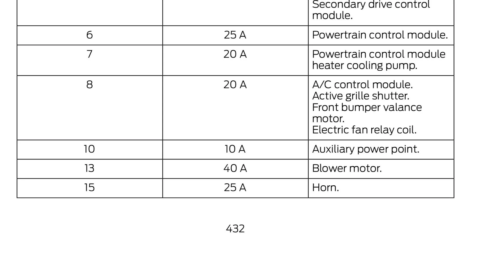

Just picked up 2 lightning Pros to add to my work truck fleet. Drove them from CA LAX - Phx yesterday. Noticed the one I was driving was having air conditioning issues when we got half way into the trip after the first Electrified America charging session in Indio. It dropped down to 25kw charge rate while the other truck stayed in the middle 100kw’s charge rate. Traffic was at a standstill on the i-10 and 110 outside and AC was just blowing hot air until I got it moving to above 20MPH. Does anyone know where the fuse for the condenser fan is located? It has zero fans running and the batteries actually got really hot with no fans running. When side by side to the other truck at the tesla supercharger it sounds like a jet taking off. Other truck has ice cold air, and fast charge rate.

From the manual (under hood fuse box):
Ford F-150 Lightning HOT AC and Battery temp.  No fans IMG_1289

I have checked every single fuse and all are good. Testing via a meter. At this point I belive its the fan itself or the relay/module that controls it. The fan is not spinning at all. Guess its going to the dealer on Monday.
