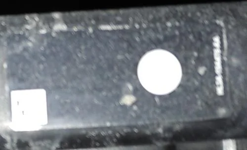

On the black sticker, is there any information? All mine has is a white dot and a part number looks like.

Those weight ratings would be for my truck?
These are the receiver's ratings, not the truck. You said that your sticker did not have any informaiton, I thought you referred to the receiver's sticker. That's the only black or white sticker that I know in regards to towing.
That is what I ment receiver weight rating. Mine has no information just a white dot. Sorry for the blury picture but this is my sticker.
That's very interesting. How old is the truck (when did you get it)? Is there no other sticker elsewhere on the receiver? If not, I would probably contact a dealer or even Ford HQ to resolve this.
Ordered March 31, 2021..delivered May 6, 2021. Only Trailer Tow package - 53A and Trailer Brake Controller - 53B. If there is another sticker it will be on top of the receiver and would have to take it off the truck to see it.
