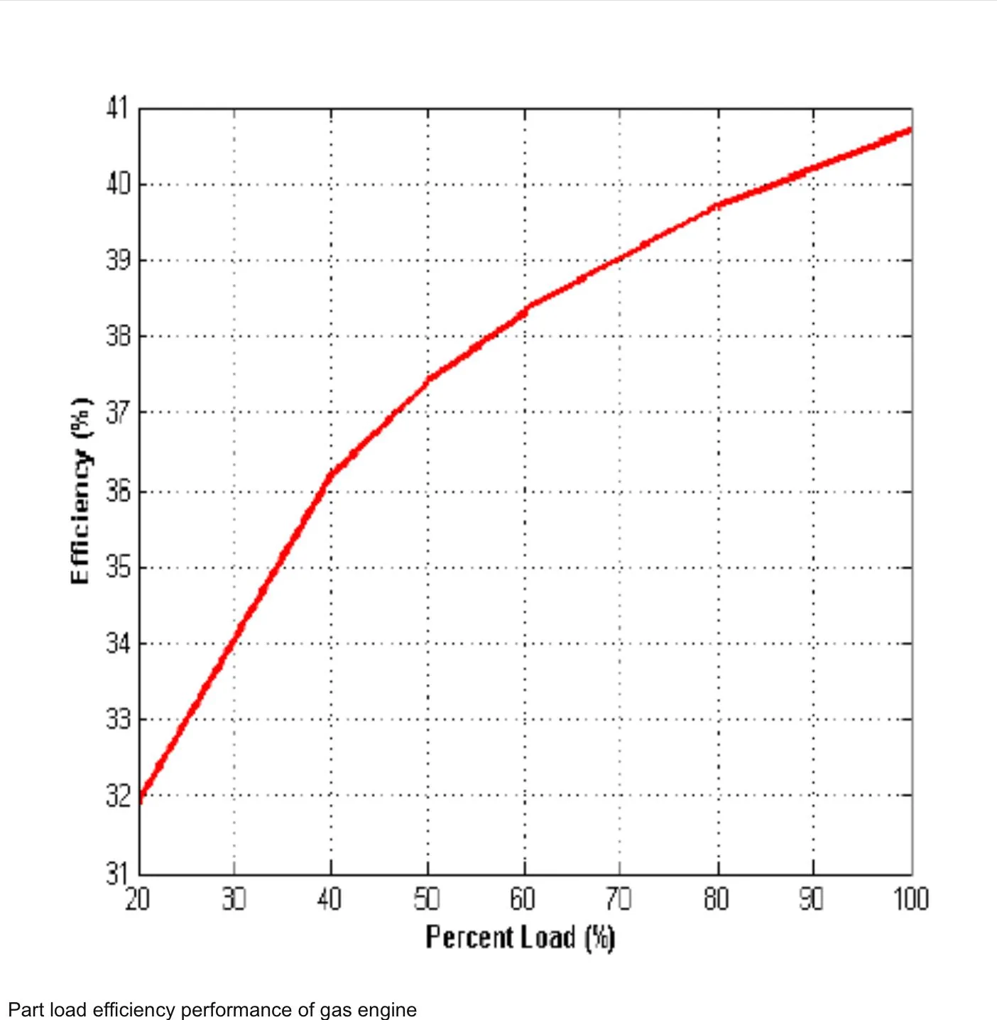

No - both systems are most efficient at full load. The ICE drops off much faster than an electric motor as you reduce the load.
So if you think about it in reverse, the ICE climbs the efficiency curve at a higher rate as the load is increased.
The BEV will still have a much higher absolute efficiency at any load, but the ICE has more to gain efficiency-wise as the load is increased.

How does the efficiency curve look for a turbo/supercharged engine? I know when my car goes into boost, the mixture richens to help prevent detonation and mpg plummets. However, this is also the "magic" that boost can provide and why almost every manufacturer is using it now. It offers good cruising / idling mpg because the engine is smaller for a given output, and there is still power on tap when needed. When towing, you'll stay in boost much longer. I've seen other threads where people say their ecoboost engine mpg drops into the single digits while towing whereas they are otherwise in the low 20s.
3,869
5,035
It’s complicated…here’s a pretty good summary:
