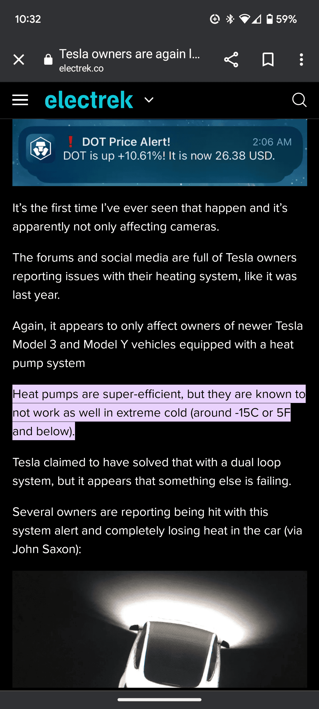

There is a ton more heat to pull out of the ground than the air.
Yeah, I had hoped that was implicit in the context of my description. When the air is 32 deg F or less out, a heat pump ain't gonna have much heat to draw out of the air to heat your truck. Normally, a "good" heat pump has a dependable heat source (winter) or thermal sink (summer) in the ground. Ain't so for a vehicle. IIRC, heat pumps are good when you're not dealing with temperature extremes but when it's very cold or very hot, conventional methods have higher cooling and heating rates than you're likely to get out of a heat pump without a super-expensive heat exchange setup. That's my ignorant view from having slightly read about heat pumps once upon a time.

As for modern heat pumps -- an old AC had been a "one way" heat pump for years. Newer second generation heat pumps are more efficient that the old ones from the 70's. Also more prone to failure. But they can generate heat at like zero F.
My Nissan Leaf with its lowly 40 kwh battery and 7 year old heat pump is amazing how little juice it needs to cool. Does not surprise me that the Lightning is equal or better.
