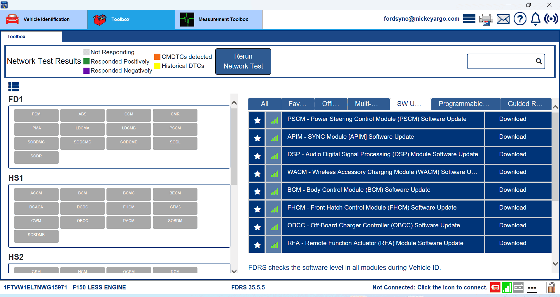

I don't know which version you are on, but I can tell you there is an APIM update waiting...which is where the new interface would live (not saying it will give you the new interface).
I found the $500 for the Mongoose and subscription to FDRS a worthwhile investment since I didn't want to wait for a dealership to make these updates after sitting on their lot for over a week (which they still did not make)...so much so that I invested in a year long subscription to FDRS just recently.

THANK YOU!!! Shouldnt I have the install icon on the top of my screen and/or updates waiting when I select Updates > Check manually?
I appreciate you. Send me your email address please.
No need to send me anything. You may or may not have the install option. I did not have it when I finally went with FDRS/Mongoose. The APIM install was scary since it took so long and drew down the 12 V so much. But I made it through and now update regularly. I've even had the courage to branch out to FORSAN.

Do you check the email address on your screen shot?
I have a long drive tomorrow that should charge the 12v if it’s not currently charged. Thanks again.
Yes, I use that email for all Ford truck things. It also revels my full name since I run my own mail servers. I'll explain the whole AO thing over beers someday...hint, former Air Force Air Traffic Controllers will know.
If you decide to use FDRS/Mongoose to update the APIM, make sure you have a battery tender hooked up before you update.
