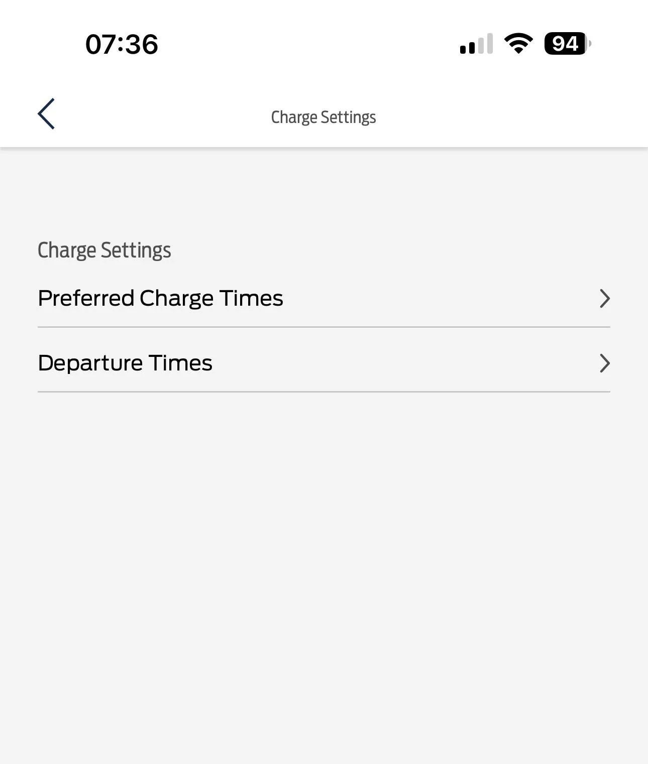

Look for Departure in the charging section of the center screen or you can do it from the App under Charge Settings. It’s the only way to precondition.

This doesn’t set the charging so it completes just before the designated drive time. I have set the departure time to 6:30, but it still start the charge at 9pm and completes charging about 1am. Then preconditions in the morning. Not what I would like.

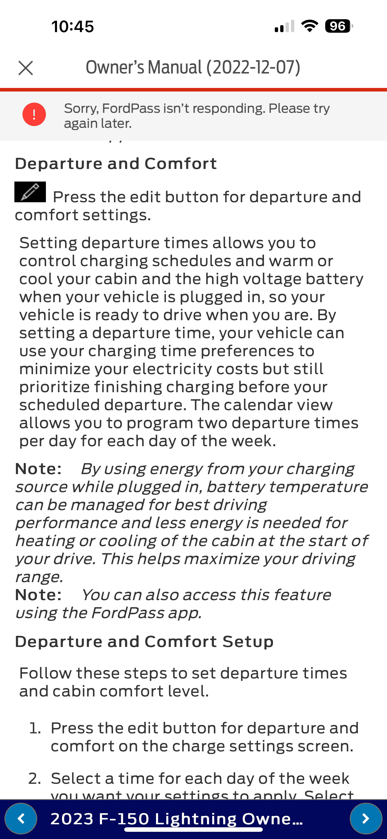

If you set the departure time, it prioritizes charging for the departure time. My experience is that it doesn't delay charging to align with a full charge for your departure as others have confirmed, but can extend charging/preconditioning beyond your scheduled charge times if your departure time requires it.
