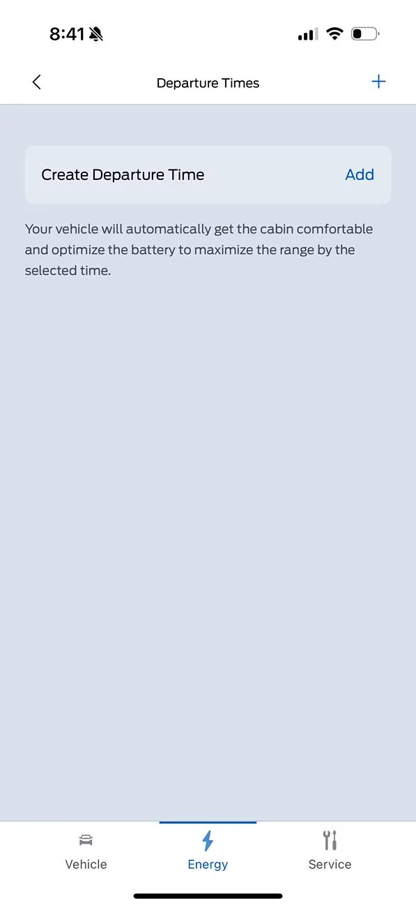

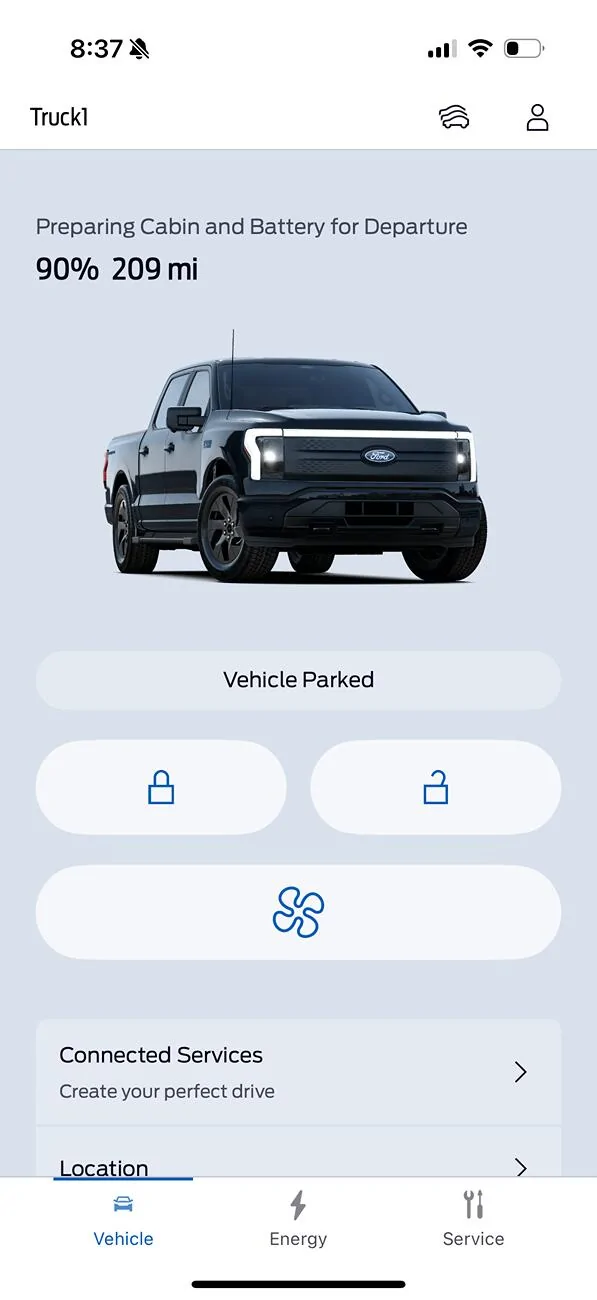

Does anyone know why the lightning does this? It’s showing its preparing cabin and battery for departure with no set departure time. Does it happen when it’s cold maybe to warm the battery?
Ford F-150 Lightning “Preparing cabin and battery for departure” no set departure time? IMG_9114
Ford F-150 Lightning “Preparing cabin and battery for departure” no set departure time? IMG_9115
4,102
5,387
Look in the truck to see if one is set. That’s what controls it and FP may not reflect it.

Yes, that message comes up when the battery is being warmed because it's cold, and plugged in. You would only notice it if looking at the app.

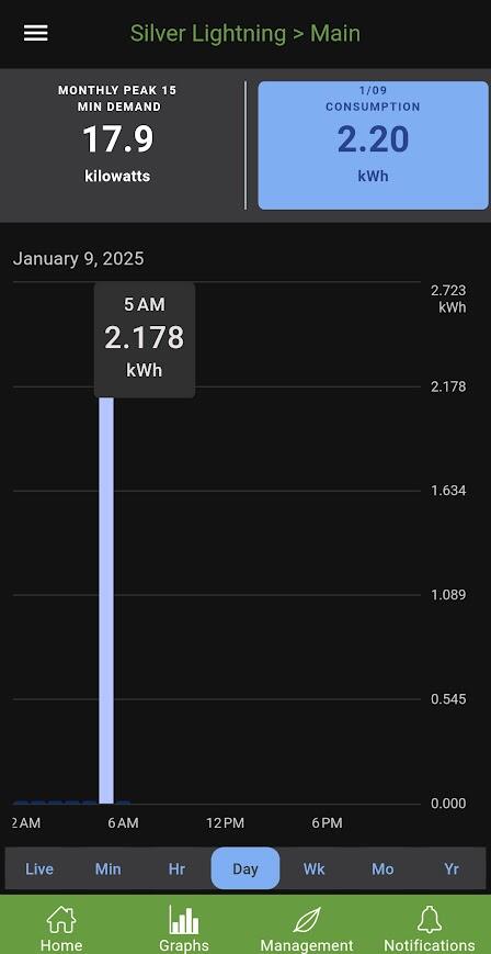

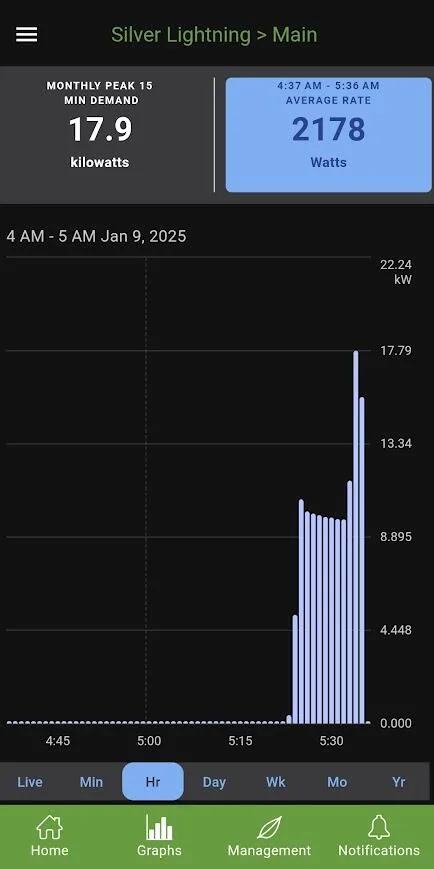

The truck is doing spontaneous battery conditioning only when you see that.
In my observations, it runs for about 10-15 minutes then stops, it may repeat or last longer the worse the cold conditions get.
This is an example I was able to capture with an Emporia energy monitor.
Ford F-150 Lightning “Preparing cabin and battery for departure” no set departure time? 1736864750798-hi
Ford F-150 Lightning “Preparing cabin and battery for departure” no set departure time? 1736864774277-4x
