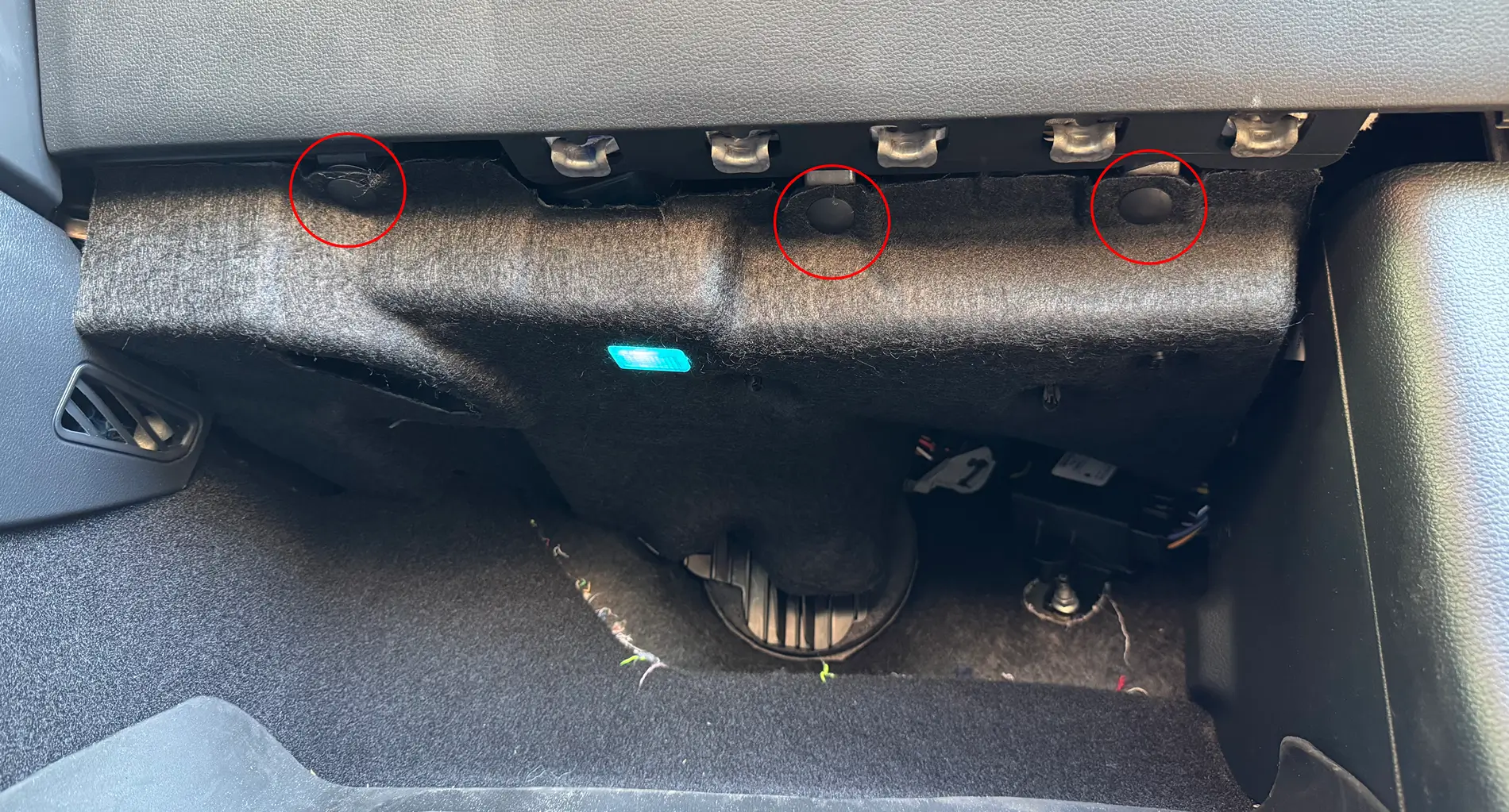

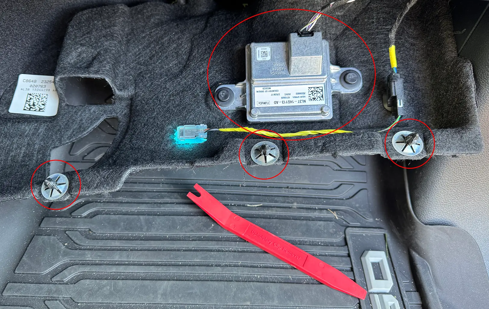

First, remove the 3 plugs from the plate under the glove box.
Ford F-150 Lightning How to toggle the AVAS/PAC on/off with a physical switch - DIY tutorial 1
Then the PACModule is visible, fastened to the plate you just loosened.
Ford F-150 Lightning How to toggle the AVAS/PAC on/off with a physical switch - DIY tutorial 22

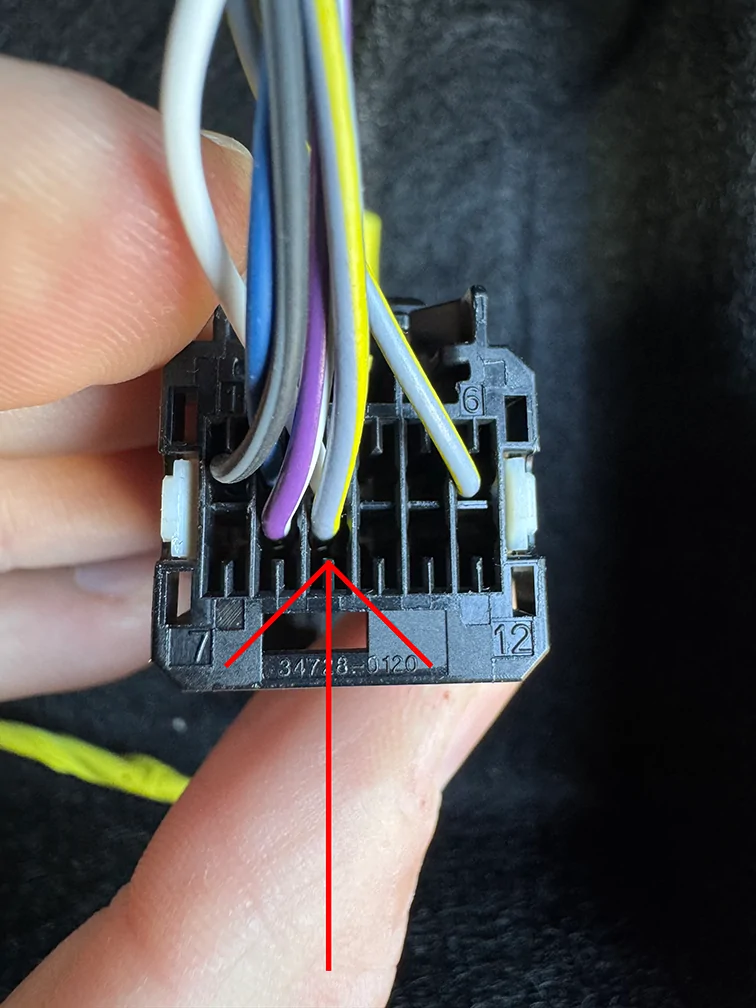

Remove the plug and cut this wire 5-10 cm from the plug. It's the speaker + terminal. Connect each end to each of a double wire, so you can complete the circuit with a switch.

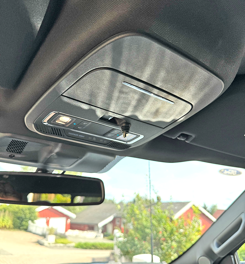

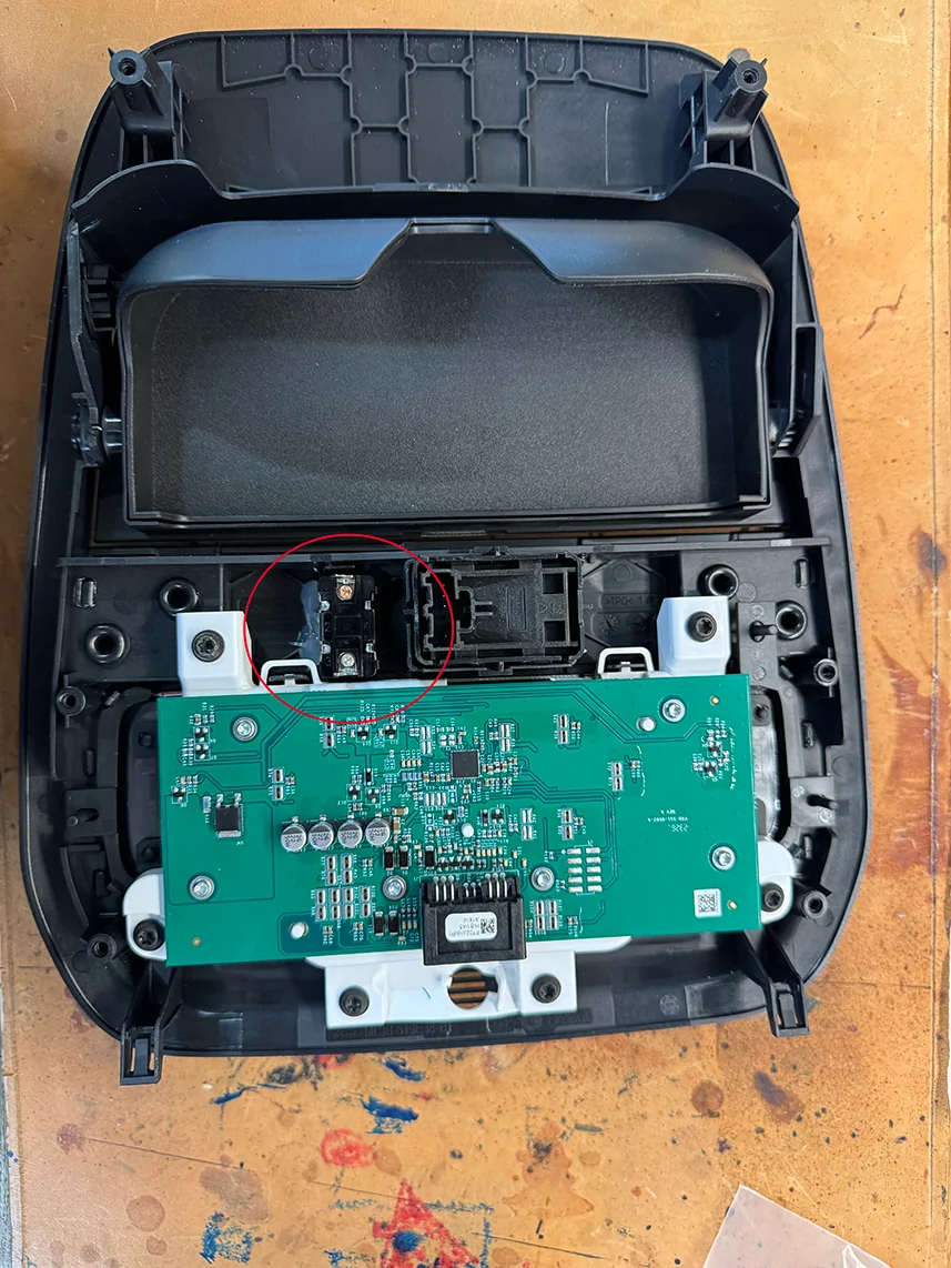

Run the double wire up through the A pillar and to the overhead console. The overhead console can be pulled down at the rear, it just hold in place with 4 clips. Unplug the three connectors. I placed my switch here. With the ON position towards the windshield. Connect the double wire to the switch.
Ford F-150 Lightning How to toggle the AVAS/PAC on/off with a physical switch - DIY tutorial 4
Final result:
Ford F-150 Lightning How to toggle the AVAS/PAC on/off with a physical switch - DIY tutorial 5

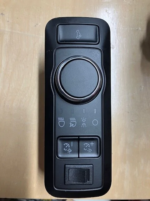

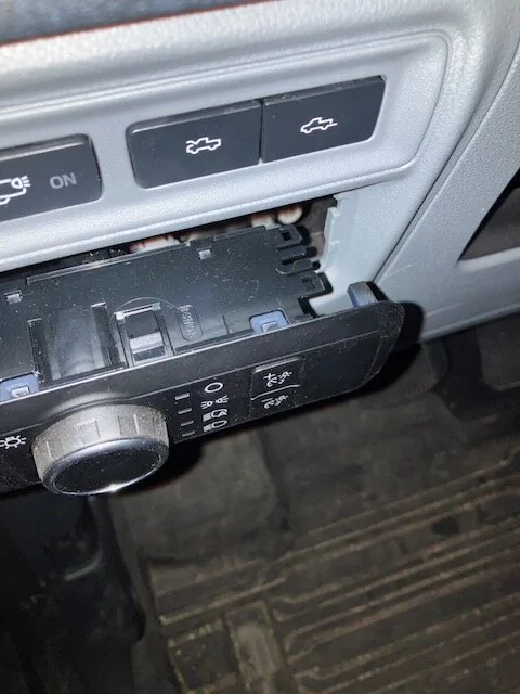

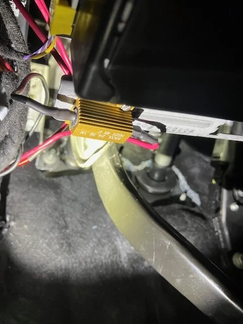

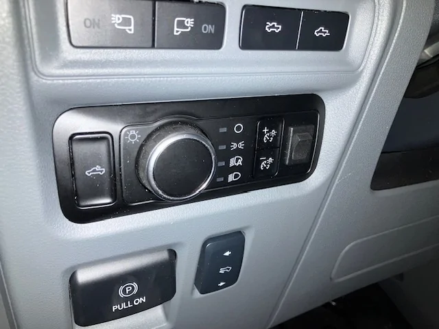

Hi here is another method for installing a physical switch to mute the external speaker. I wanted a purely physical system with no programming required, and no modification to the wiring harness. This method uses a switch in the cab to select if the signal goes to the speaker (on) or to a 4ohm resistor (off).

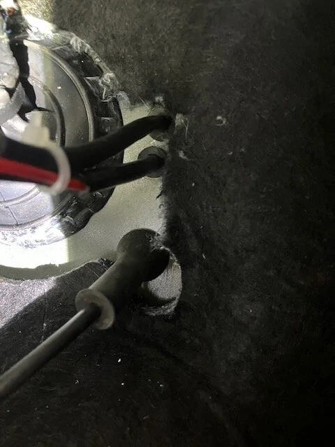

I ran two cables from the speaker through the firewall above the pedals. The cables plug in to the speakers using OEM connectors and basically re-routes the speaker signal into the cab where I select if its audible or not.
I used a mini SPDT switch mounted in the light control cluster. There is an empty slot that appears designed for switch (other trims may have something there). I mounted the 4ohm resister under the dash on the metal support above the pedals, which is great for heat dissipation and protecting the resistor from the elements.
It was some work running the wires and mounting the resistor but the results were worth it. 5000 miles driven now since modification with no issues.
