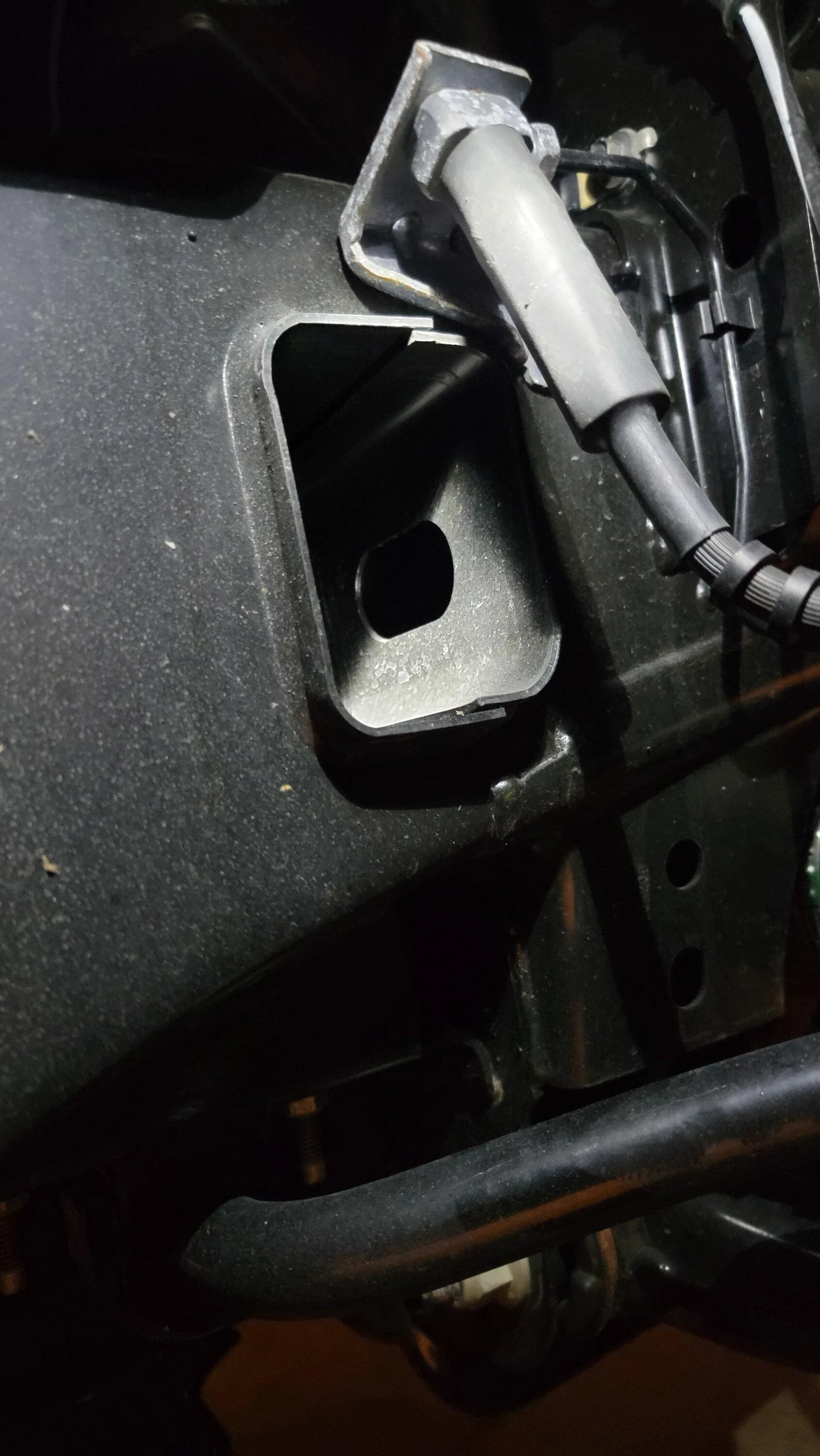

Do you mean this "vent" thing directly behind the wheel?
Ford F-150 Lightning Humming / Slight Vibration @ 45-48ish or Higher 20230214_084815

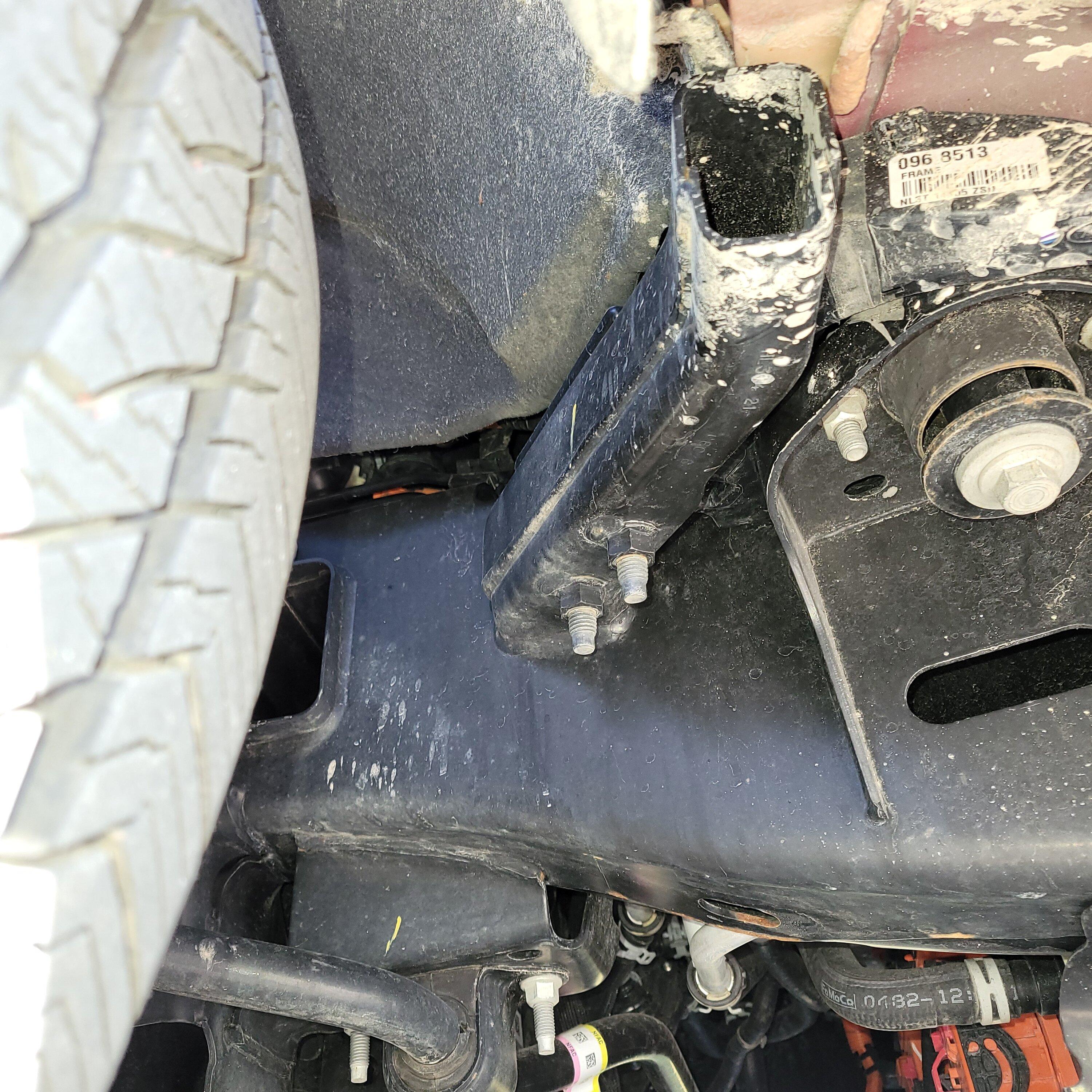

Ford F-150 Lightning Humming / Slight Vibration @ 45-48ish or Higher 20230214_101107
No, actually I was talking about this one aft of the front wheel. Upon further inspection I don't think either of these are vents. Might be worth a shot to tape them up and see if it makes a difference. Air is interacting with something down there. Maybe the air dam on your truck is creating a flute?
I think we took a shot of the same thing I just can't described anything worth a crap. You're right, It's probably redirecting air somewhere and causing a noise, the plastic components themselves of the deployable part seem solid so I doubt it is itself flapping (but the gopro can confirm that later).
The damn is wide, it does indeed come down close to the wheel well area (and could be pushing air into the well). I will try covering that "vent" there and see what happens!

The "vent" you took a photo of is 'behind' the wheel, or on the frunk side of the wheel. The "vent" I took a photo of is 'aft' of the wheel, or on the cab side of the wheel. That is kind of a pain to describe.?
I covered both "ports" / "vents" and the sound remained. Sadness. There was was another area between the wheel wheel cover and a metal brace/beam that I wanted to coverup but it's wet on the roads right now and I can't get the material I am using to cover it, to stick properly to a wet surface so that test will have to wait for it to dry out.
