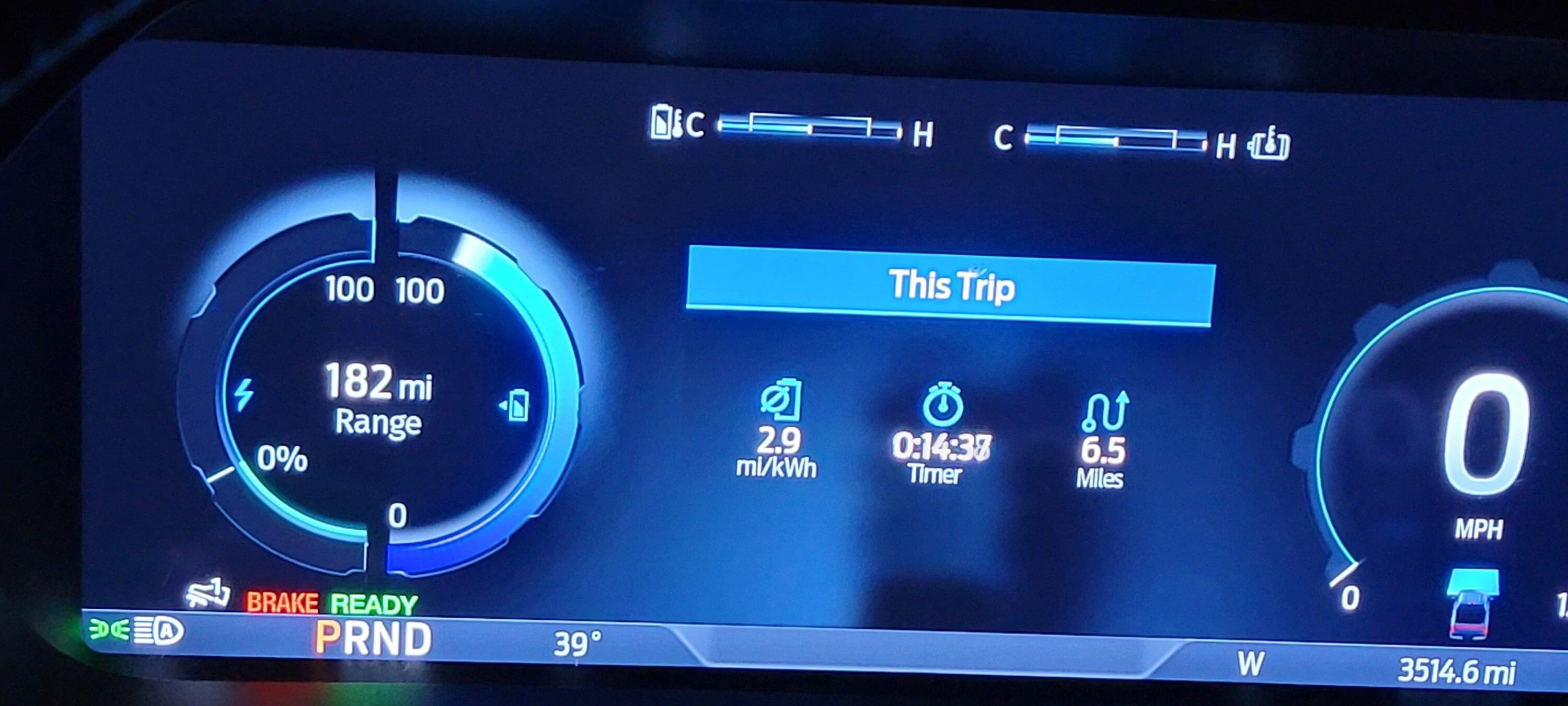

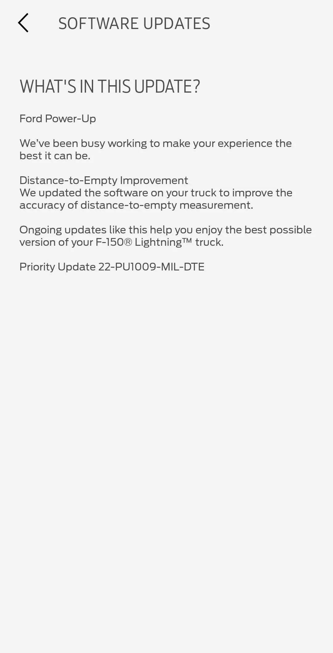

So I just got an update that fixed the milage. It's a lot more reactive now. If I punch it the range drops a mile a second ( up a long hill). Then it starts to equalize once up to freeway speed.
Seems to act like a standard combustion engine range indicator. Sorta ironic that this happened.

One thing... I'm sure the algorithm is learning. It's saying I'm getting 2.5 to 2.6 kw/mile. Lol yeah right. I'm sure it will balance out. I only have 10 or so miles on this update
I actually do mostly get 2.2-2.4 kwhr/mi in my SR at 20-30F! But most of my driving is within a 10 mile radius at 30-40mph, I don't turn the heat on, and I drive like an old man unless I'm showing off the truck. When my wife drives she turns both heated seats up hot enough to cook bacon and leaves the heater on full blast and gets something like 1.2-1.4kwhr/mi. I'm sure a reasonable compromise is somewhere in the middle at 1.8-2.0kwhr/mi.

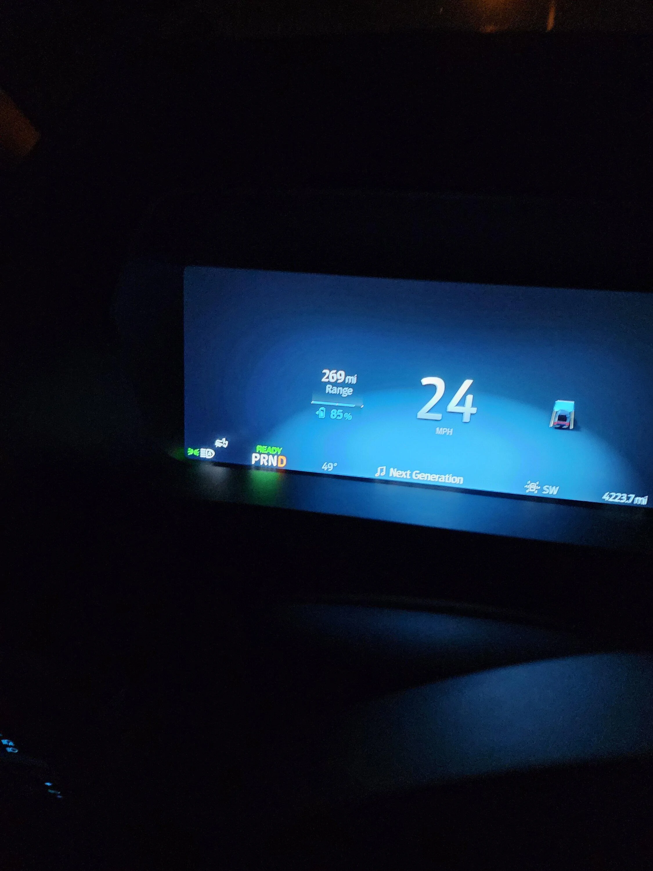

I get 2.4-3.0 7 miles to work but that's at 4am hyper mileing all the way.
Standard Range..
What update version are you on?
Standard Range..
Not bad.
The last one that came out about 1 month ago. 3.4 something something... but the new priority update seemed very limited and specific.
