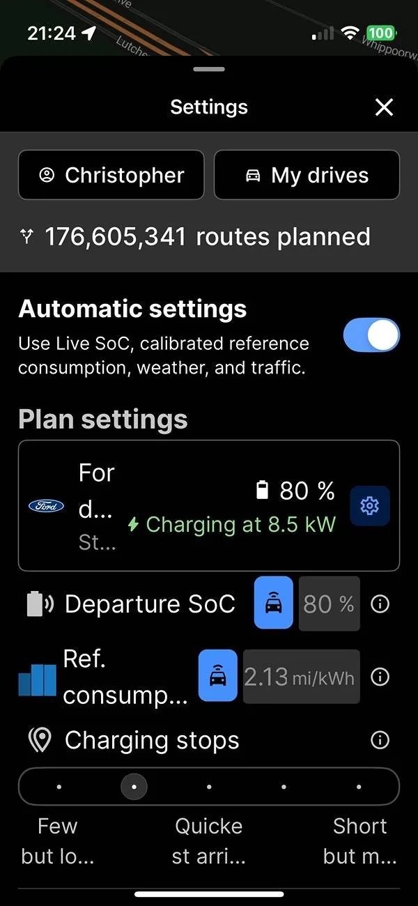

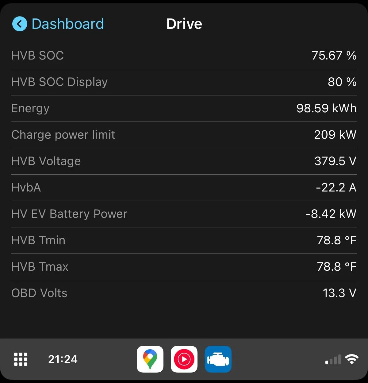

I never trust the range estimator, at all. I use data and a calculator. A ball park calc from the data below yields 2 x 98 = 196 miles. The estimator on the Ford Pass App says 236 miles. I'm pretty sure that won't happen. The most optimistic calc would be 2.13 x 98.59 = 210 miles. The Ford estimator thinks I'm getting 2.39 mi/kwh. That my be accurate for around town & moderate highway driving but when range matters to me, I'm on the interstate. And it's not 2.39.
