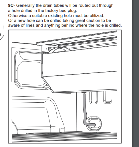

My truck had a dealer-installed Retrax roll top when I bought it (that I am pulling off and selling).
Link to the instructions:
https://retrax.com/images/InstallGuides/retraxretractablebedcoverinstallinstructionsrev73018.pdf
The drain hoses go through holes that were drilled through the bed front bulkhead plugs. .

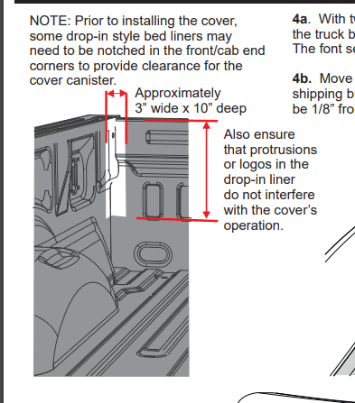

The instructions also show the need to cut away 3x10 inches or so of the rounded innner corner area of the bedliner so as allow the roll top housing to be tight in the front corners up against the front bulkhead.
Ford F-150 Lightning Installing a RetraxPro XR on lariat with a drop in bed liner 1671908415196
After removing the Retrax, I just installed a drop-in bedliner, and it fully covers the front bulkhead. To route the drain tubes, you would need to accurately add some holes to the bedliner to align to the plugs. Maybe drill through both at the same time?
